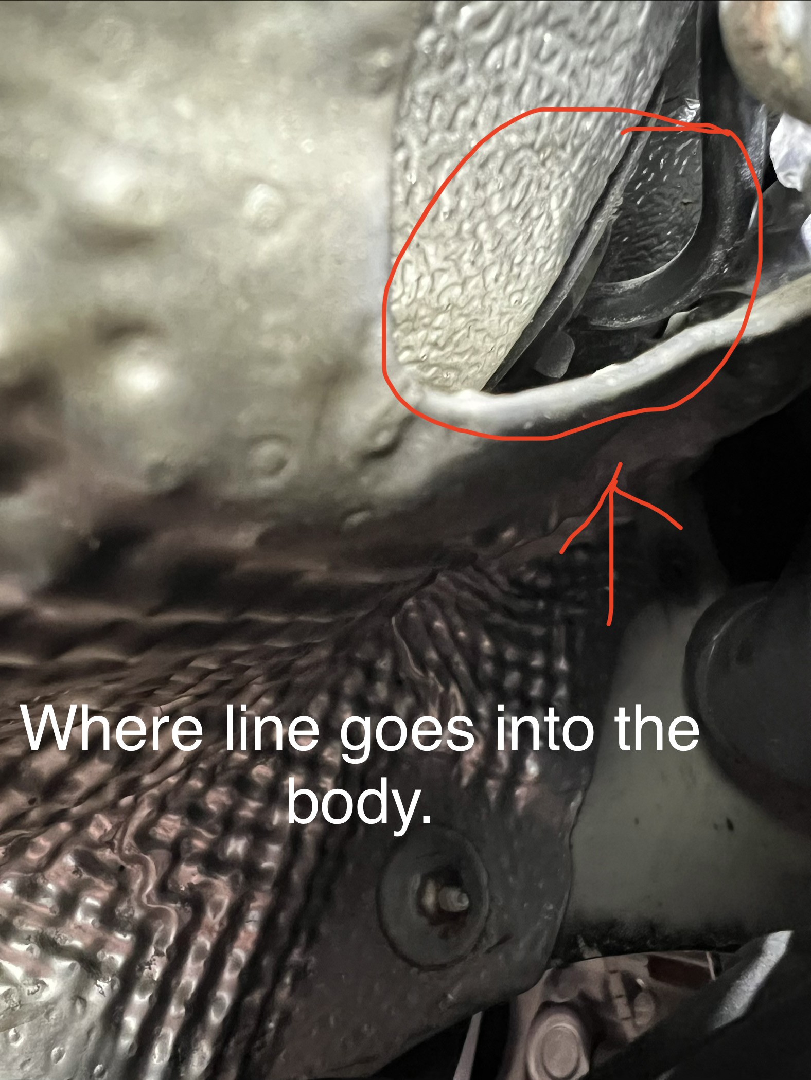

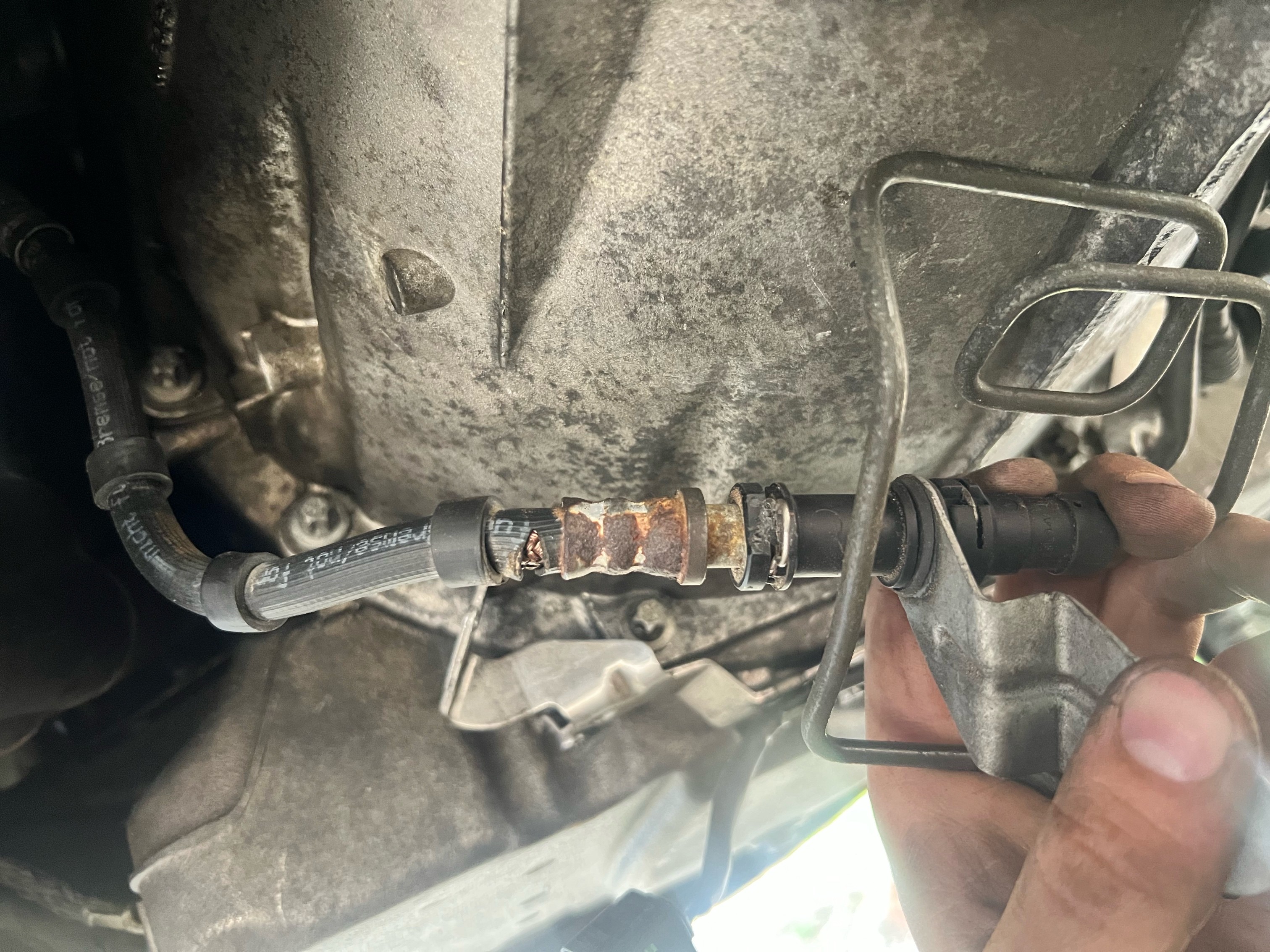

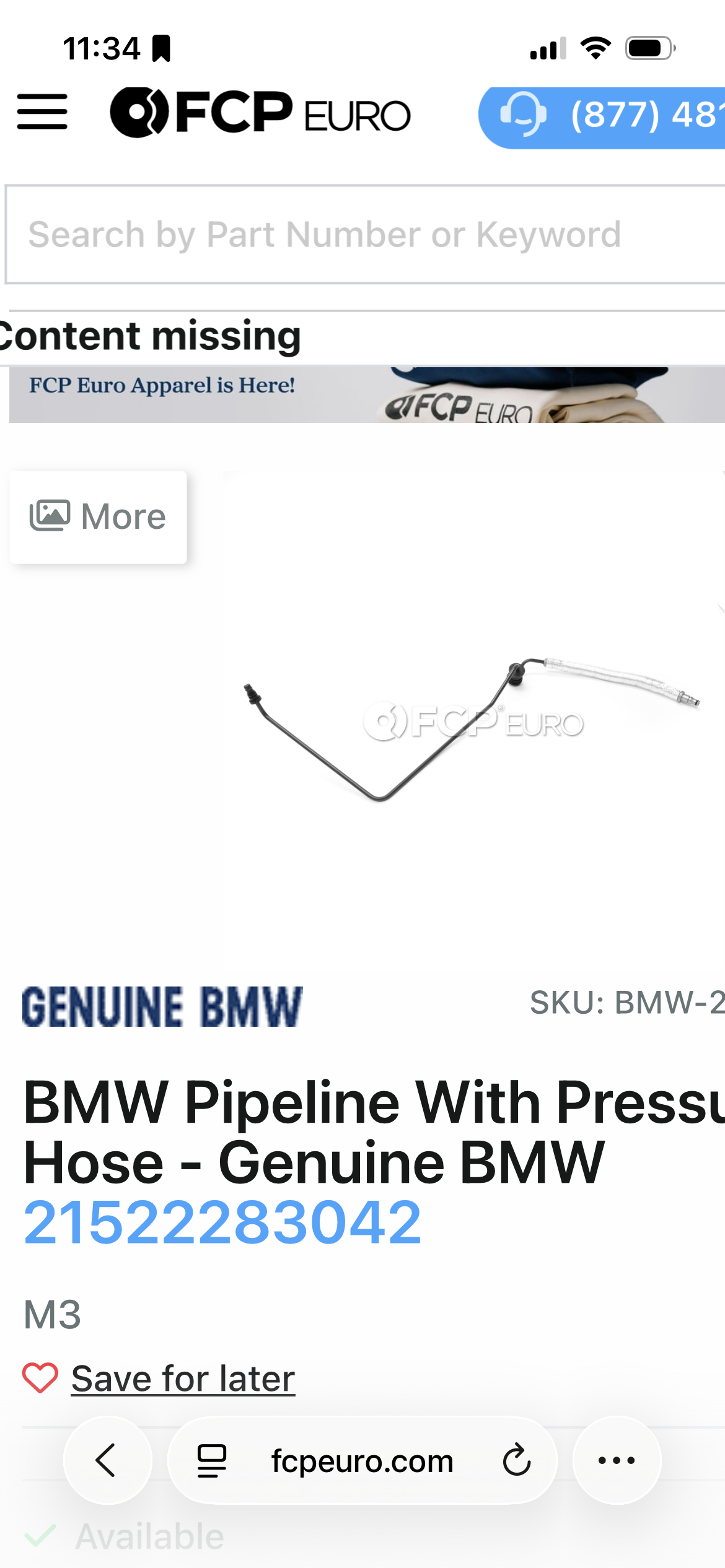

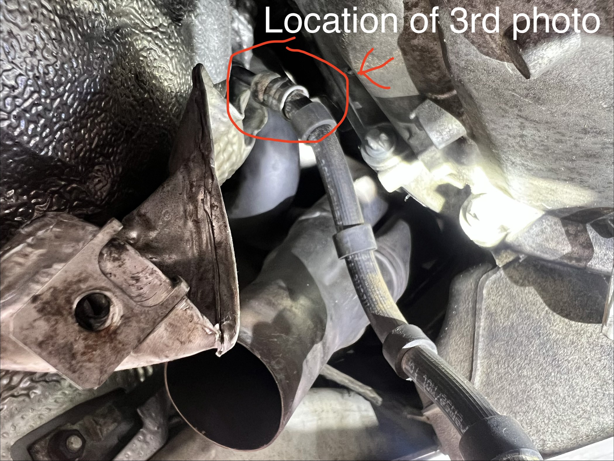

Hey all. I just did a clutch replacement on my e92 and I guess when removing or installing the manual transmission I clipped the flexible hydraulic line that goes from the master cylinder to the slave cylinder (part#21522283042). I can’t seem to find any info on replacing this line in my service repair manual nor on YouTube. From looking at listings for the part it looks like an absolute bear to replace. Does anyone have any advice or suggestions for fixing this? My only idea was buying a new one and cutting the hose off and splicing it into the old one but I have no idea what kind of crimpers or hydraulic fittings I would need. And from the look of the part it seems that my idea or pulling the engine and or part of the interior are the only two options.
