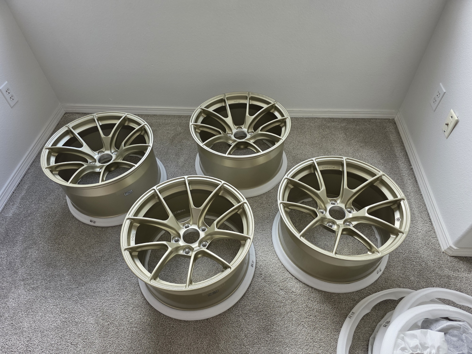

Hi guys, I've purchased a set of staggered apex ec7 wheels 9.5 and 10.5 ET 22 for my E92 and was hoping to see if anyone has experience running a 295 wide tire in the rear.

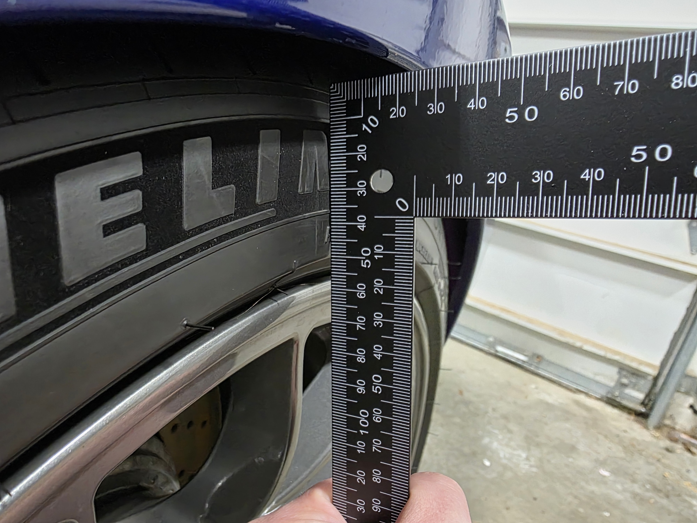

I ended up order a set of VS5RS' after realizing I've been running my EC7s for 6 years (they'll be switched to AS duty). I've been using the 285/35/18 on that original setup; same 10.5 et 22 in the rear. I've added an SC and heavily modified the car at this point, so I'm trying to bump up the rears to 295/35. I'm glancing at my rear tires and it looks like the 295/35 should fit. The Conti's seem to have a narrower tread than the Michelin's, so it's looking like it should be an okay fit. For reference, I'm running MCS 1WNR with articulated perches ~2 degrees of camber in the rear (corner balanced).

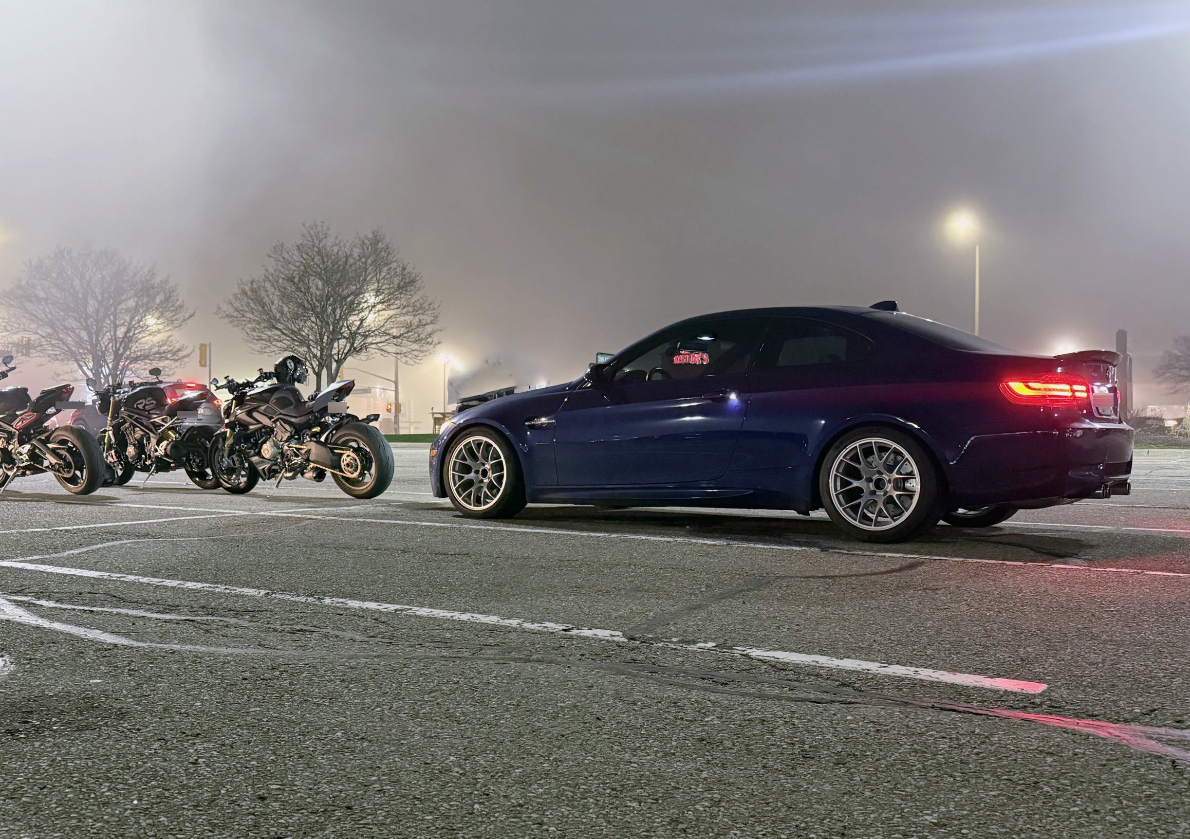

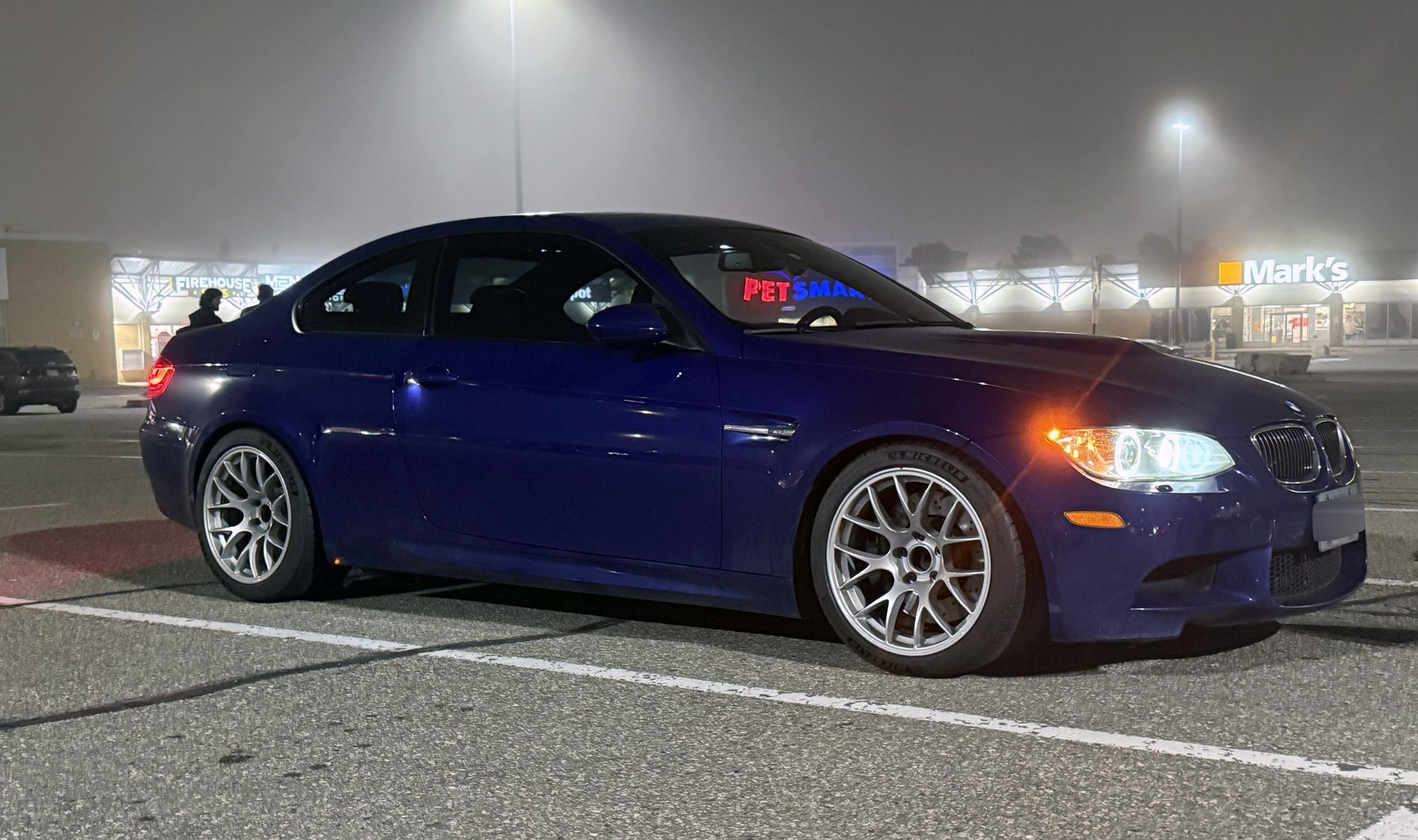

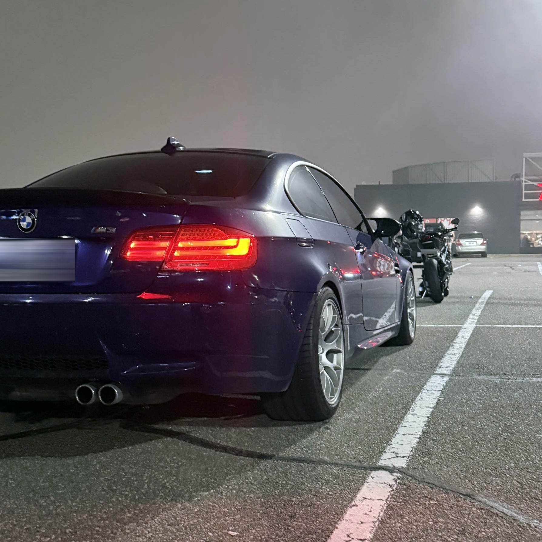

I put 5mm spacers in the rear to fill it out and it fit perfectly, no rubbing with 285/35/r18 michelin PS4S, at around a zcp equivalent ride height on ST XTA coilovers.
Can't complain it looks great. Super happy with the setup. Now I just need to repaint my bumpers, hood, restore my headlights, swap my failing thermostat out and install my carbon splitters all around.
That 5mm spacer may be bringing you pretty close to the 295 fitment, though a touch shorter. I may add a 5mm spacer to the front now that I'm running a bit of camber.
