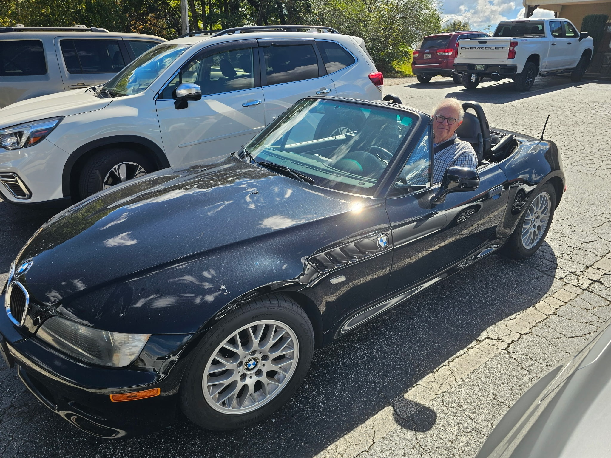

Just acquired my first BMW, a classic Z with under 50k miles. I have driven Miatas for years and there is no comparison between the two. Thus is truly a driving machine. My only concern with it is the gearbox- the Miatas were always so smooth to shift, but this Z seems to kind of grind in every gear, and I can hear a slight clanking noise in the lower gears. I took it by a transmission shop and they said “probably nothing to worry about,” but it bothers me. What do you think?

Having said all that, as much as I love it, I think I have outgrown my fascination with tiny roadsters and it may be time to move on. I have had a 64 Corvette, two MG Midgets, a ‘63 Pontiac Tempest V-8 convertible (ok, not a roadster but close,) a 2001 Boxster, 3 Miatas, and now this little jewel, and have enjoyed them all. But I’m about to turn 80, and just getting in and out of it is a chore. So I’m looking for a good home for it. Here are the details:
Located near Atlanta
2.5 engine
49,000 miles
Black on black on black
5-speed
Very, very nice, inside and out, except for two almost imperceptible hail dents in the hood - perfect top - almost perfect rear window
Custom BMW floormats
Kenwood radio installed, original radio included
Four almost new tires
Need to get no less than $10,500
If interested please respond here

After driving this sweetheart for 6 months I am truly in love. What a fun machine!
I have a few questions for you Beemerheads:
DSC switch: if I am reading the manual correctly, ON is the default position. Pressing the switch turns it OFF. Is that correct? If so is there any reason to ever turn it off?
Storage box behind and between the seats: there seems to be a box there but no way to open it - no buttons to push. Any idea why?
Oil changes: AI says every 15000 miles; is that realistic?
Really dumb question: what is the significance of the “m” logo on the steering wheel? I know the M series is the high performance, most expensive one, but I see this little logo many places
Rear window: it is beginning to separate from the top in a couple of places. Can it be fixed?
Clear coat: seeing a lot of tiny holes on the hood. Does this need to be addressed sooner rather than later? Is it going to get worse?
Thanks in advance for helping out a new member of the cult
