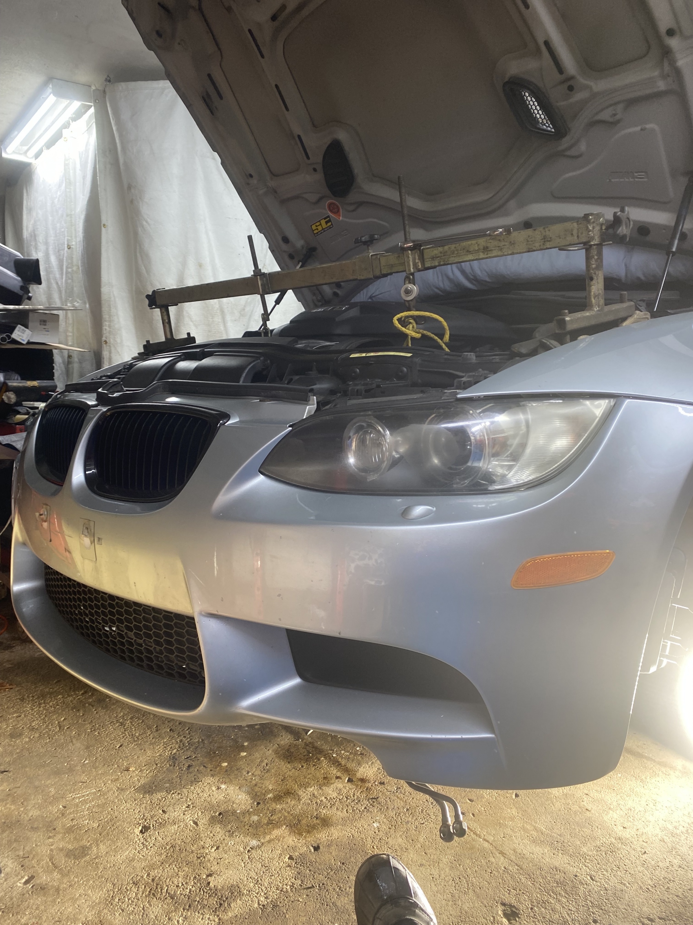

Hi guys, I did the DCT service cartridge filter, pan filter and sucking jet pump all OEM Getrag with Petosin FFL-4. So glad i did it, filters and pump were original with 317000 kms, and in terrible shape. It’s running so strong
