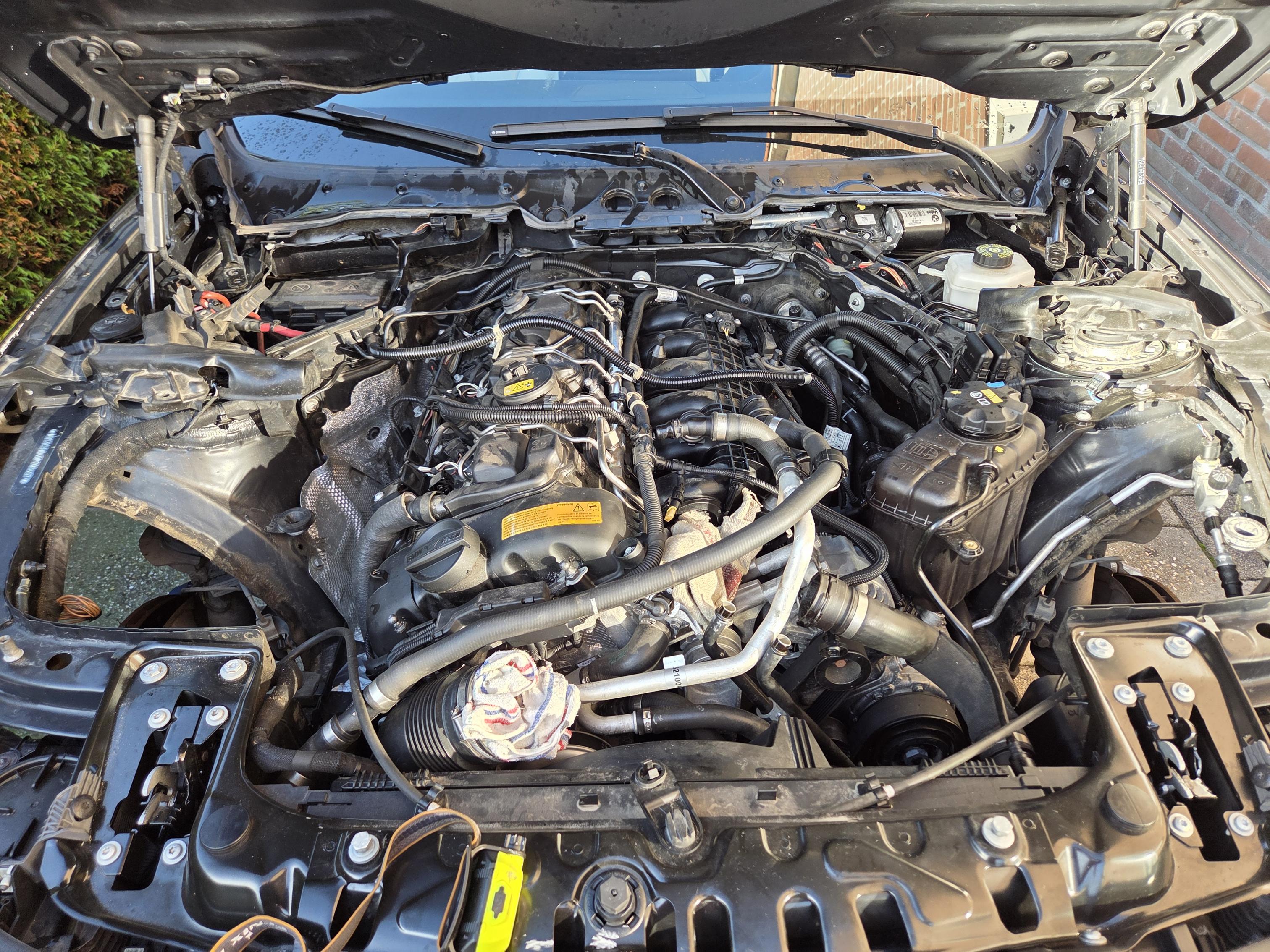

After buying this new to me 11/2014 103k mile / 166k km 1 owner always dealer maintained F80 M3 i did some investigation into what would be a good major service to tackle most of the ''weak spots'' of the S55 and F8x platform so it will be good to go for a few years.
I did all the maintanance on my E91 N52B25 myself for almost 8 years from 157k miles to 283k miles so i am quite well known to the general BMW layout and weakspots + diagnostics like ista inpa.
My major service consisted out of:

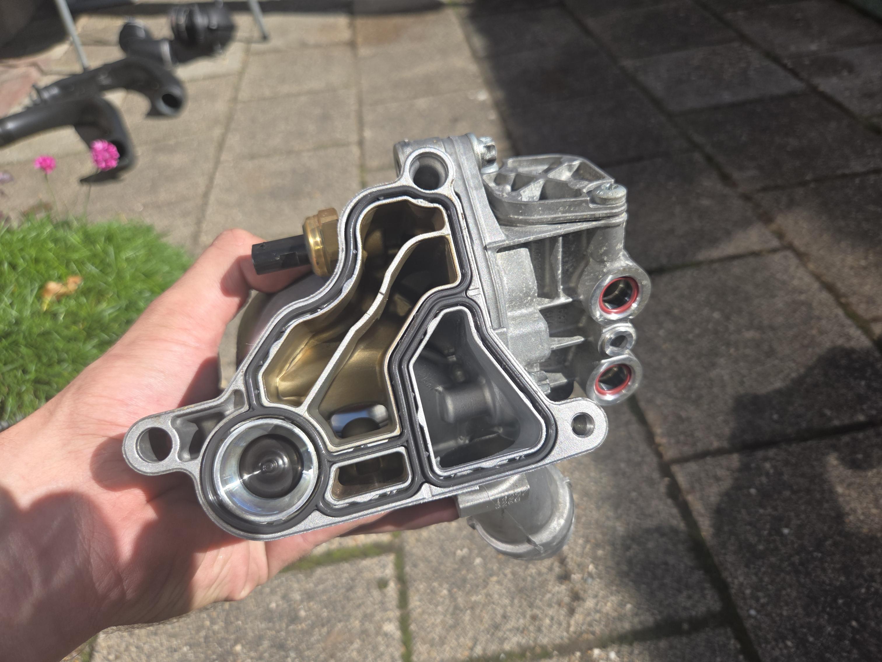

- OFHG and thermostat gasket together with O ring for the oil cooler pipes

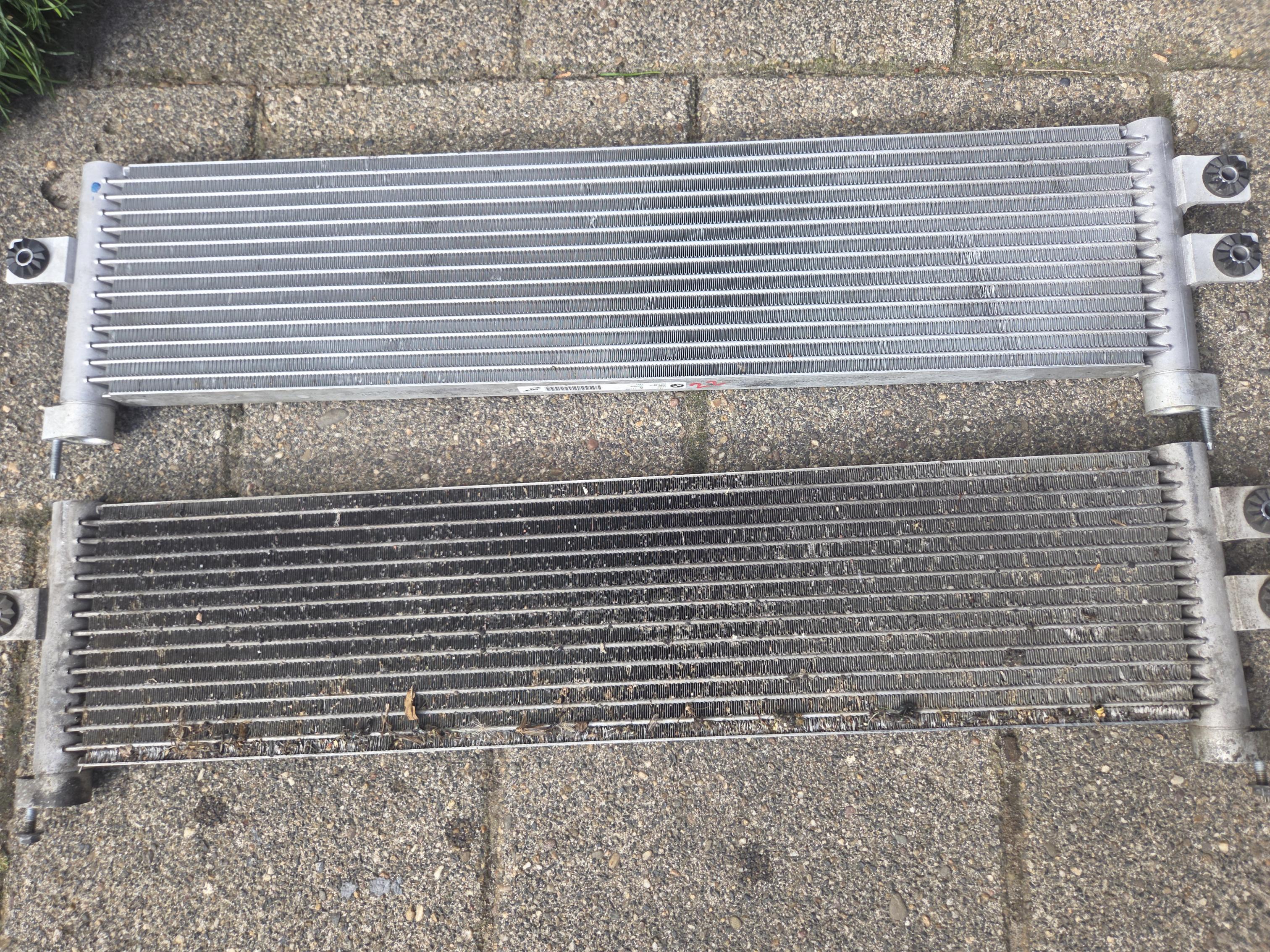

- My oil cooler didnt look great and had a lot of little stones lodged between the fins, i managed to find a as good as new used one from a 2021 car. Mine is 2014.

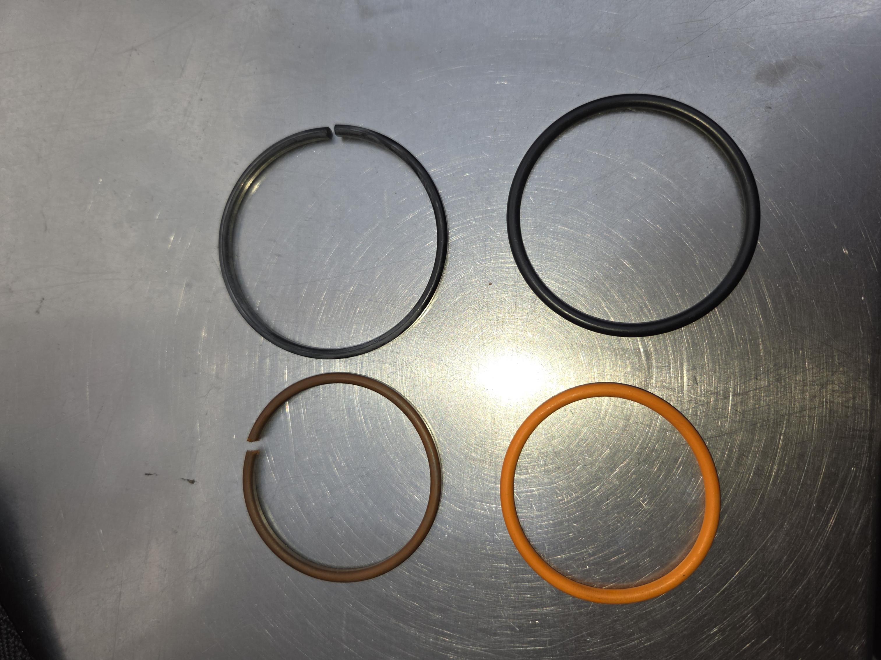

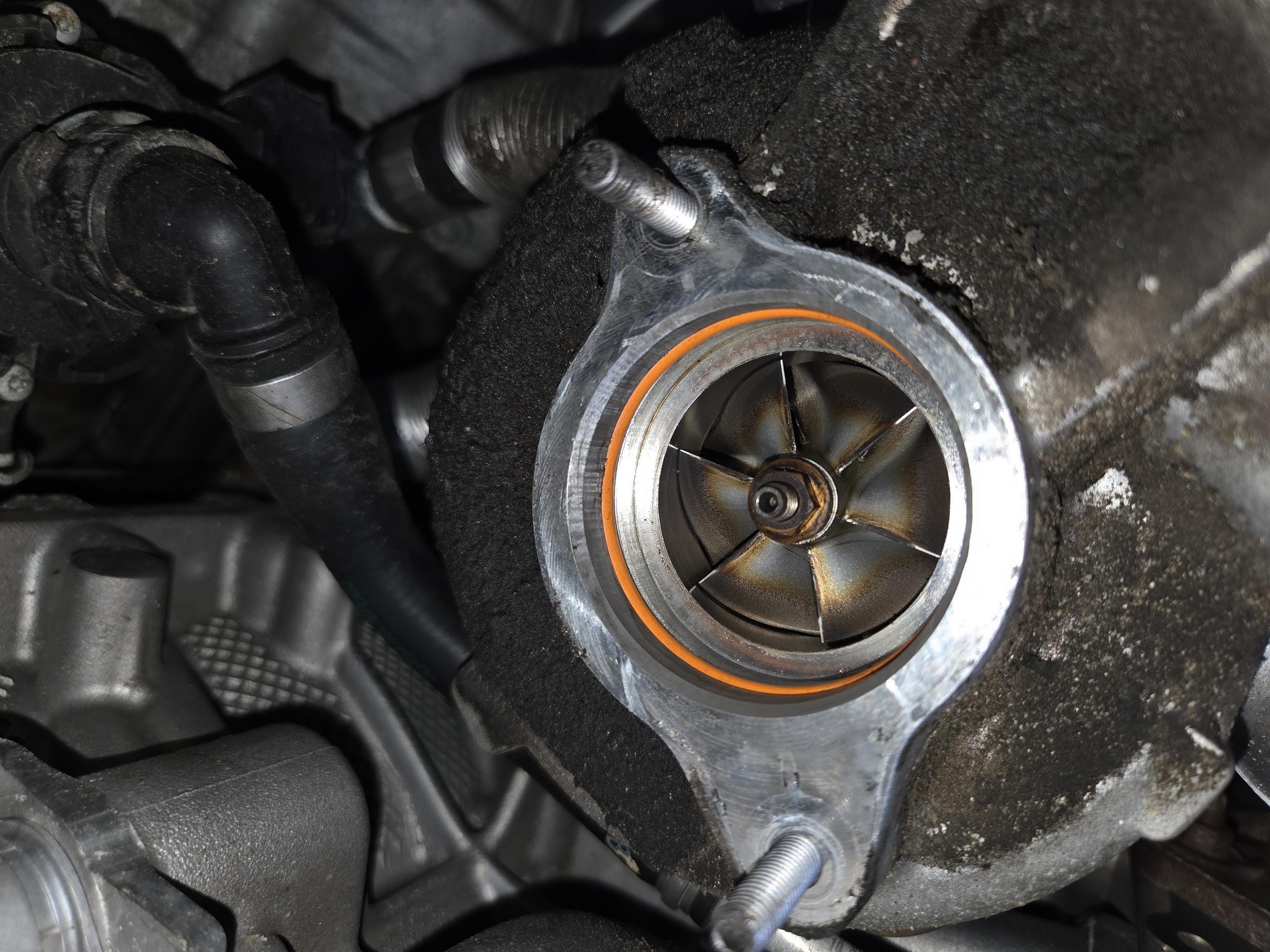

- Turbo inlet seals, these harden in the hot turbo housing causing leaks especially visable on the front turbo which connects to the PCV pipe seeping oil across the front of the turbo

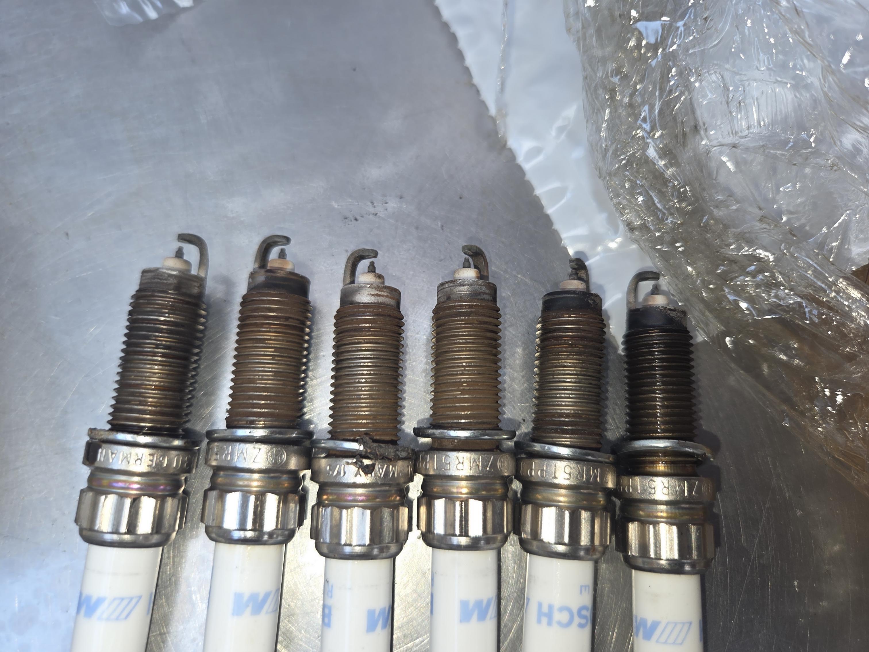

- sparkplugs

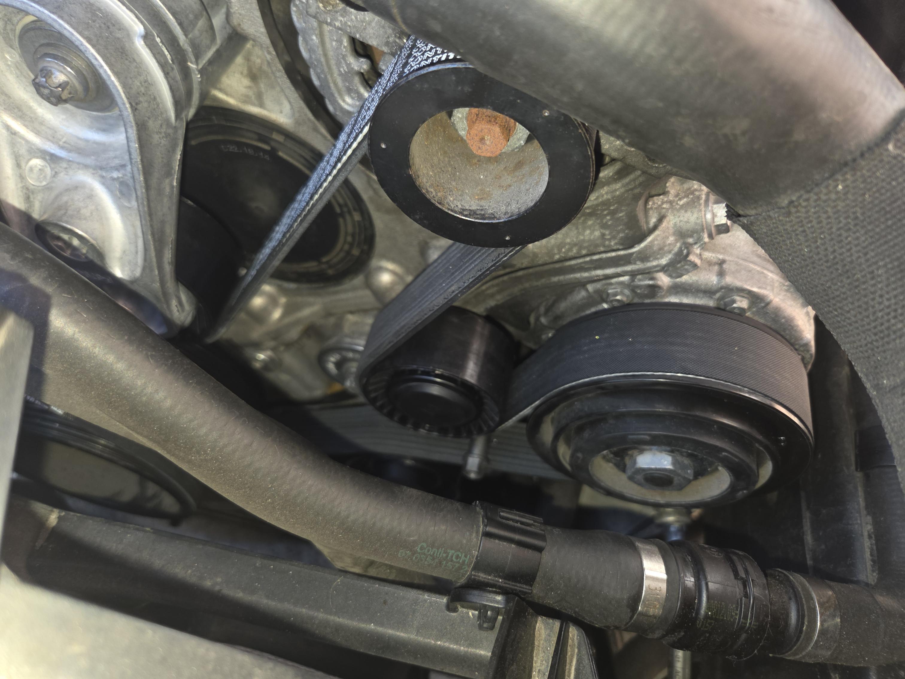

- Belts and tensioners for waterpump and ac/alternator.

Before hand i ordered the special 12 point thinwalled sparkplug socked and the E torx spanner for the OFHG.

Because the way the S55 is constructed i decided i was going to do all of this in one go because otherwise the coolant has to be drained multiple times for both systems, also after the opening of the oil circuit at the OFHG the engine had to be primed according to the N55 priming instruction. Obviously i only wanted to do this once to minimise risks hence why i decided to do the oil cooler at the same time.

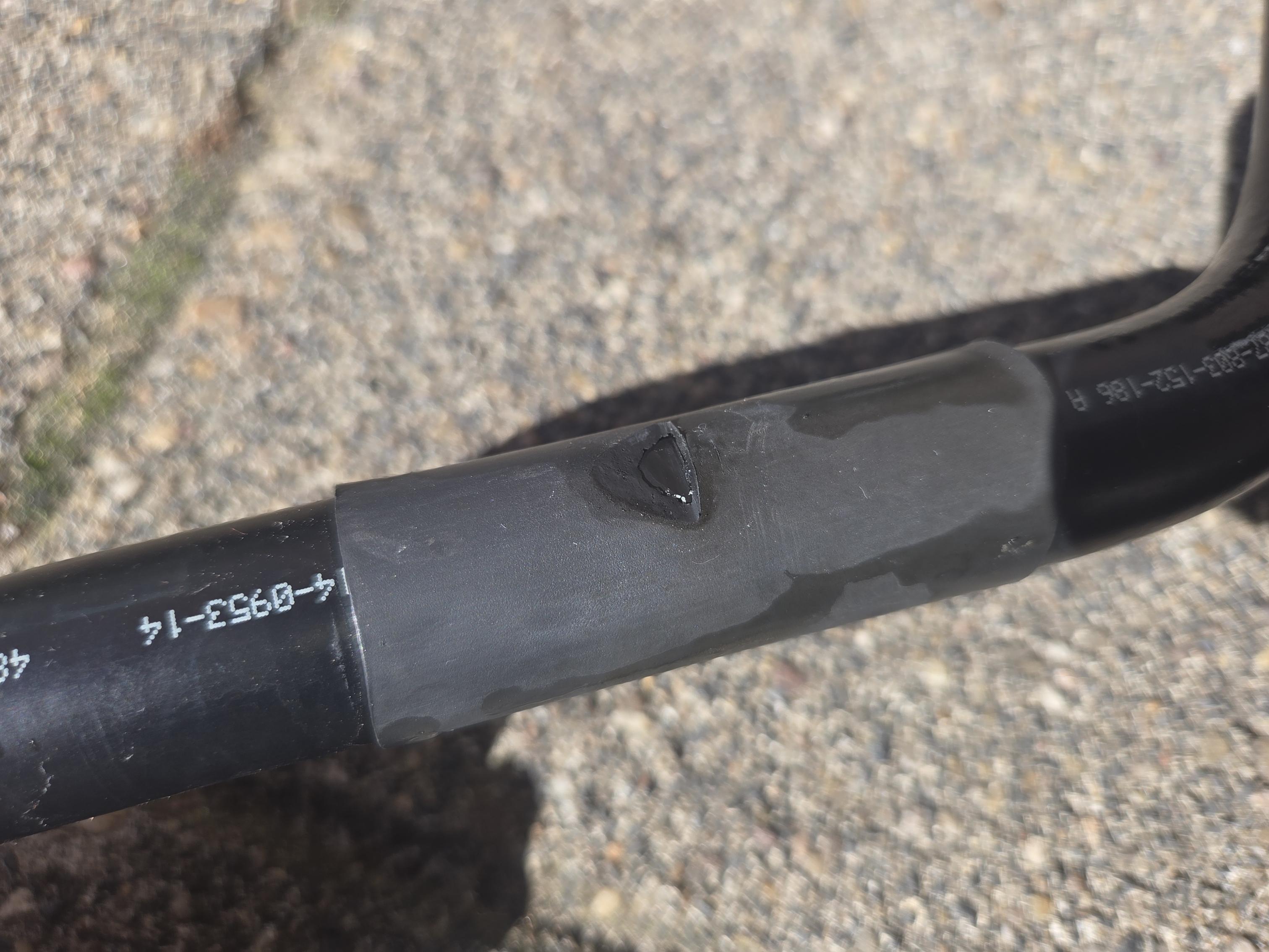

Seeing that the car was alway dealer maintained showed me that the service was done according to BMW intervals and with OEM parts, however it also teached me that the dealer does not go further then that. For example the oil cooler hose was rubbing in its clamp, a few more years and it would be worn through leaking oil and potentially causing engine damage. This was a simple fix by just turning the protective part 180 degrees so it will last another 10 years.
Also all the coolers at the front of the car where full of leafs and stones. In the longterm in our humid climate this would start to rot the cooling fins.
I also removed all under paneling, wheel inner fenders and the sills to remove build up of mud, leafs and dust. I have learned this the hard way from the E91 where this already was too late and caused the formation of rust.
