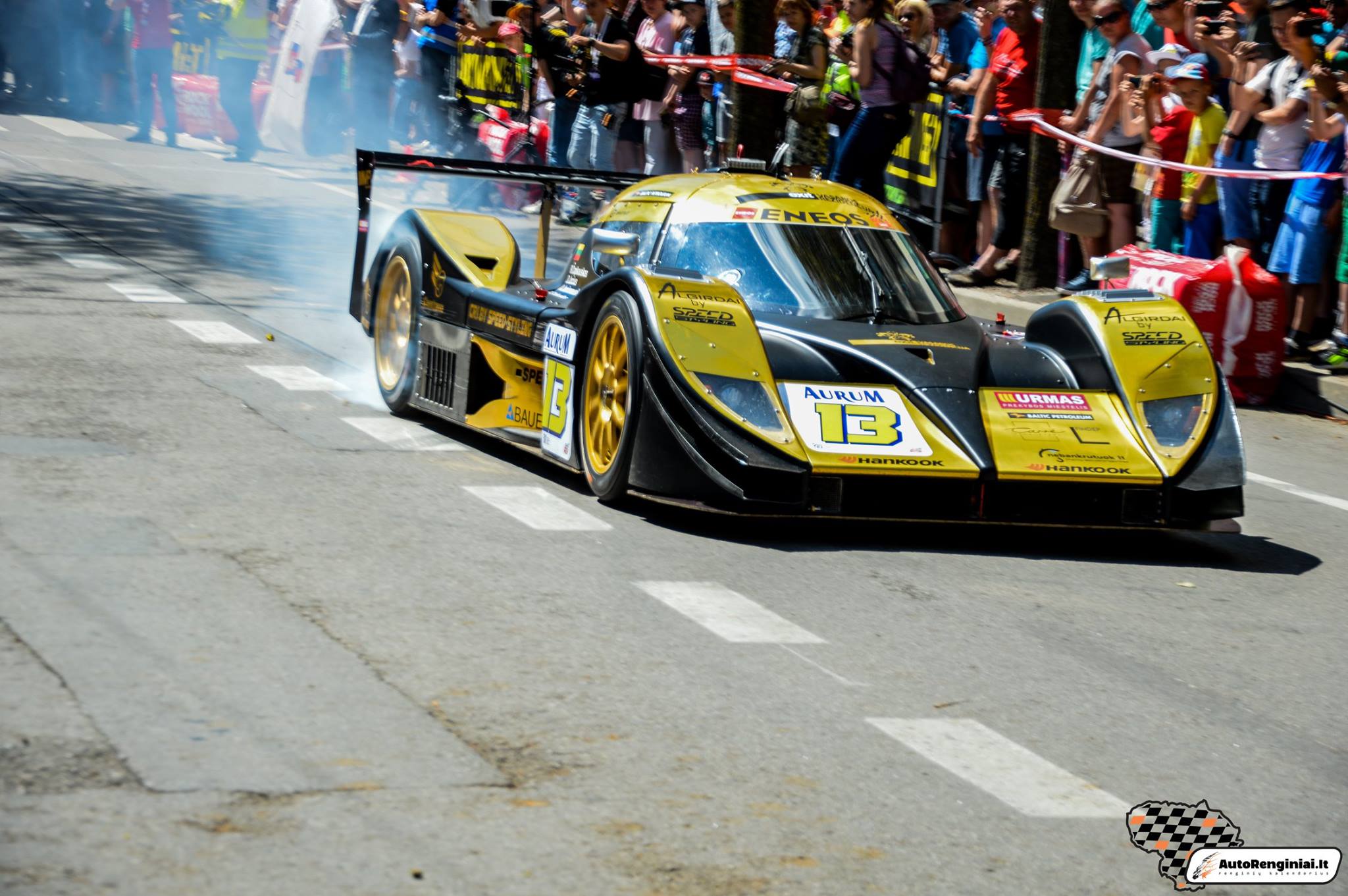

Hi all, I am rebuilding an Aquila CR1 that has the S65 V8 engine. It came in many pieces so we are in the process of repairing / rebuilding and I sent the oil pump away for service. It is an Auto Verde pump but the guy there thinks it could be off a Chevy v8 rather than the BMW which has a much higher oil flow rate at around 45 litres per minute.
He is asking for more flow rate info before he can spec the pump but all the info I can find only says 45 LPM, he has asked for the rate at different RPM but I can't find an info on that, any ideas?
Thanks, Russell
