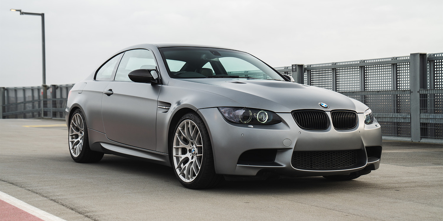

We’re kicking off a new build series at R44 Performance, following the ongoing transformation of a customer’s BMW E92 M3 from a clean, stock car into a properly sorted clubsport build.
This car belongs to a customer called Neil, and the aim from the outset is to create something that feels special on the road, inspires confidence behind the wheel, and is a blast on track. We’re taking a staged approach, starting with the areas that make the biggest difference to how the car drives.
The Car
  • BMW E92 M3
  • Around 30,000 miles
  • Very clean, well looked-after example
  • Wrapped in Saturn XPEL Frozen PPF and ceramic coated
  • All gloss exterior parts freshly repainted
  • Running Competition wheels and Competition back box
The condition of the car really sets the tone for the project. It’s the kind of example where everything still feels tight and fresh, which means every part going on needs to earn its place. It almost seems too nice to modify, but Neil wanted the best foundation possible.

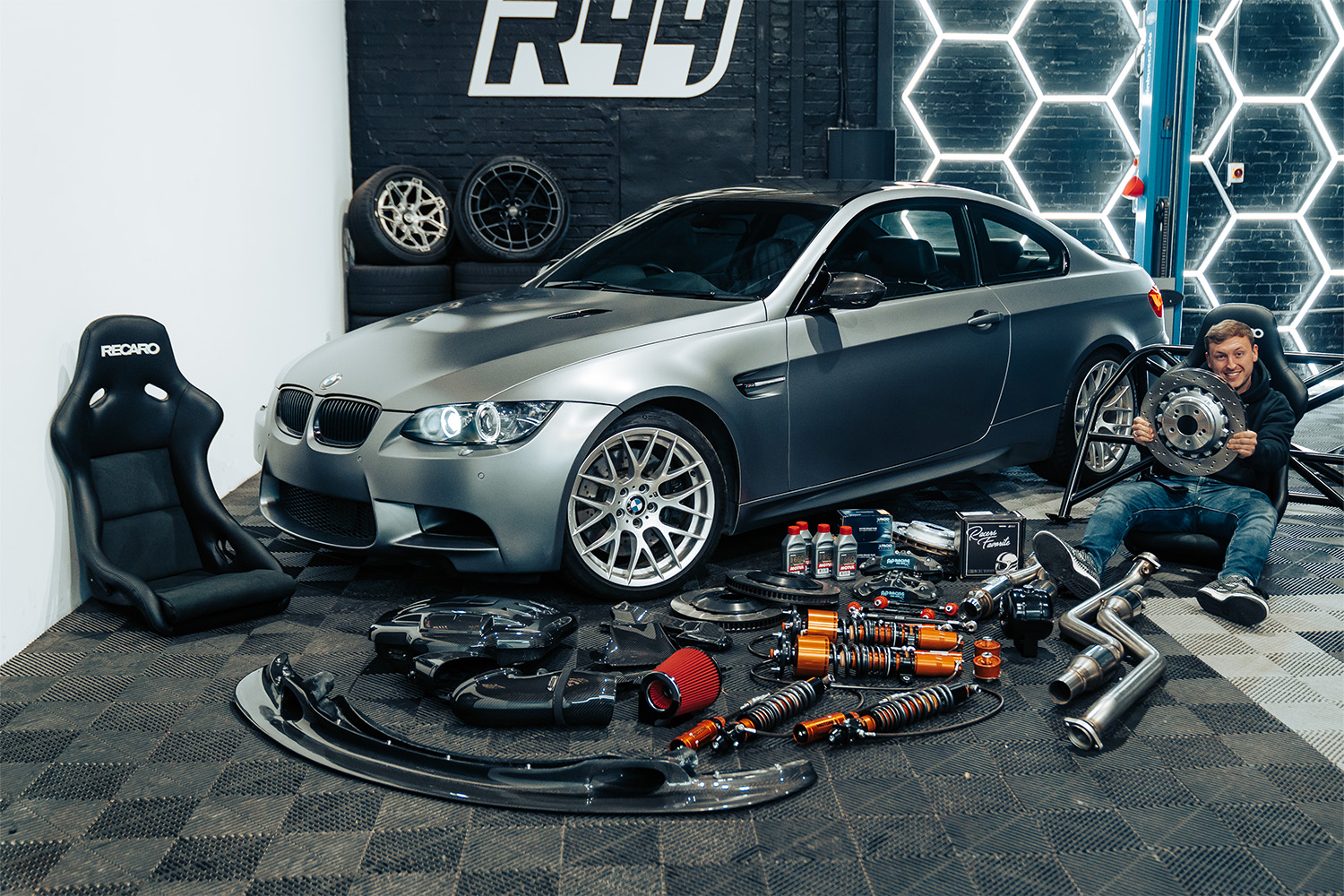

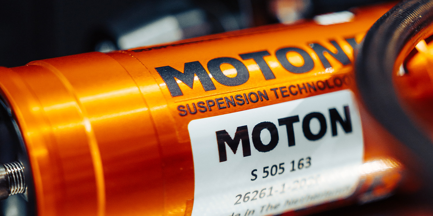

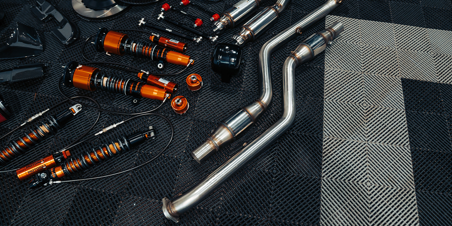

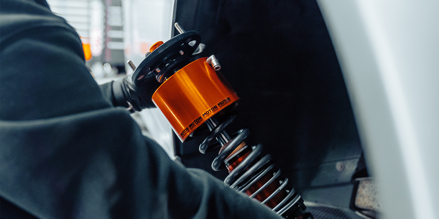

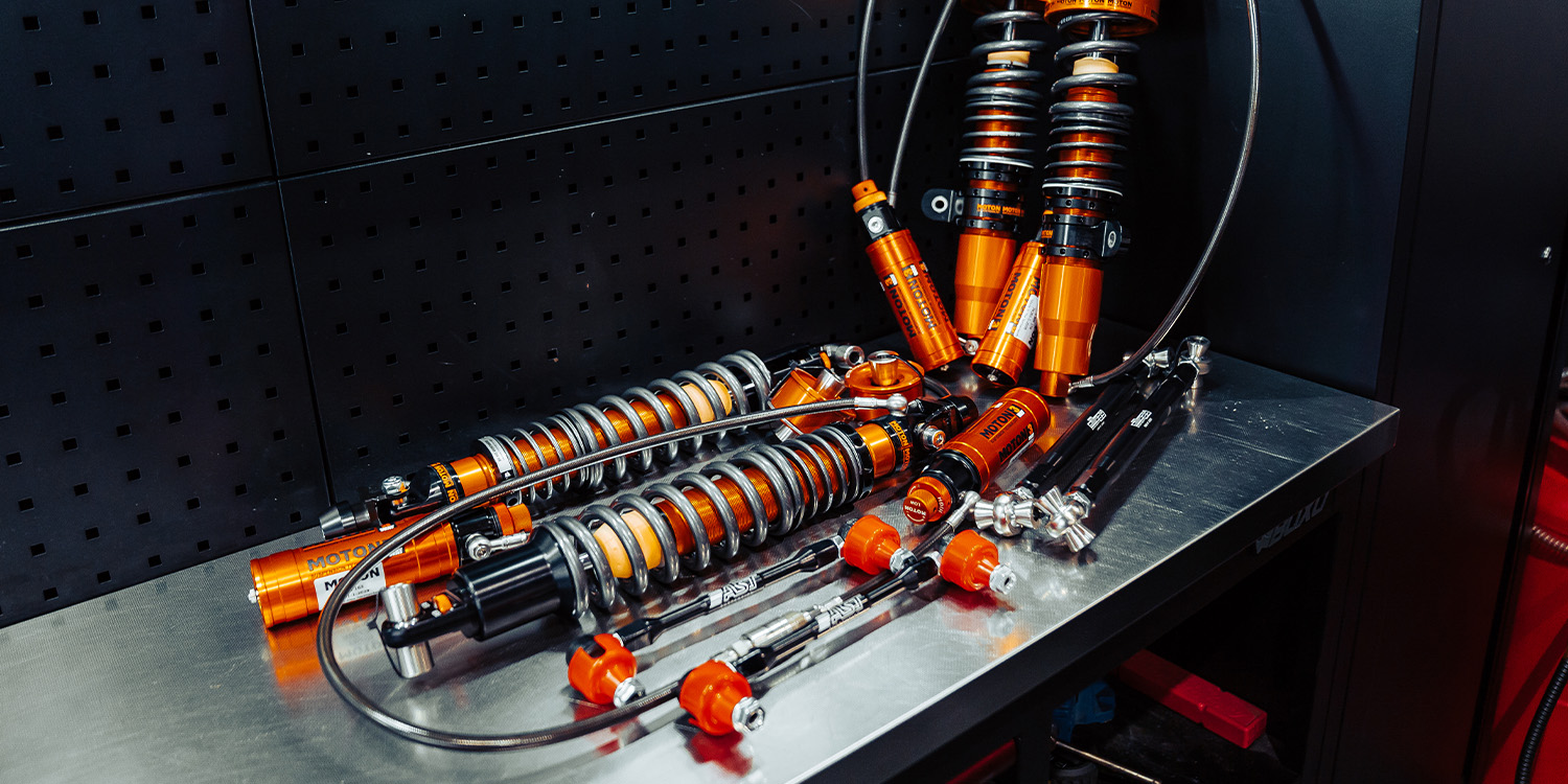

The car is being set up on Moton 3-way suspension, running a true coilover configuration front and rear. This gives a huge amount of adjustment while keeping everything compact and easy to work with. The remote canisters are being mounted neatly to really look the part under the bonnet.
To keep the car usable day to day, front air cups are being installed. These allow the front of the car to be lifted when needed, which makes a big difference on speed bumps and rough roads without taking away from how the car drives when it’s lowered.

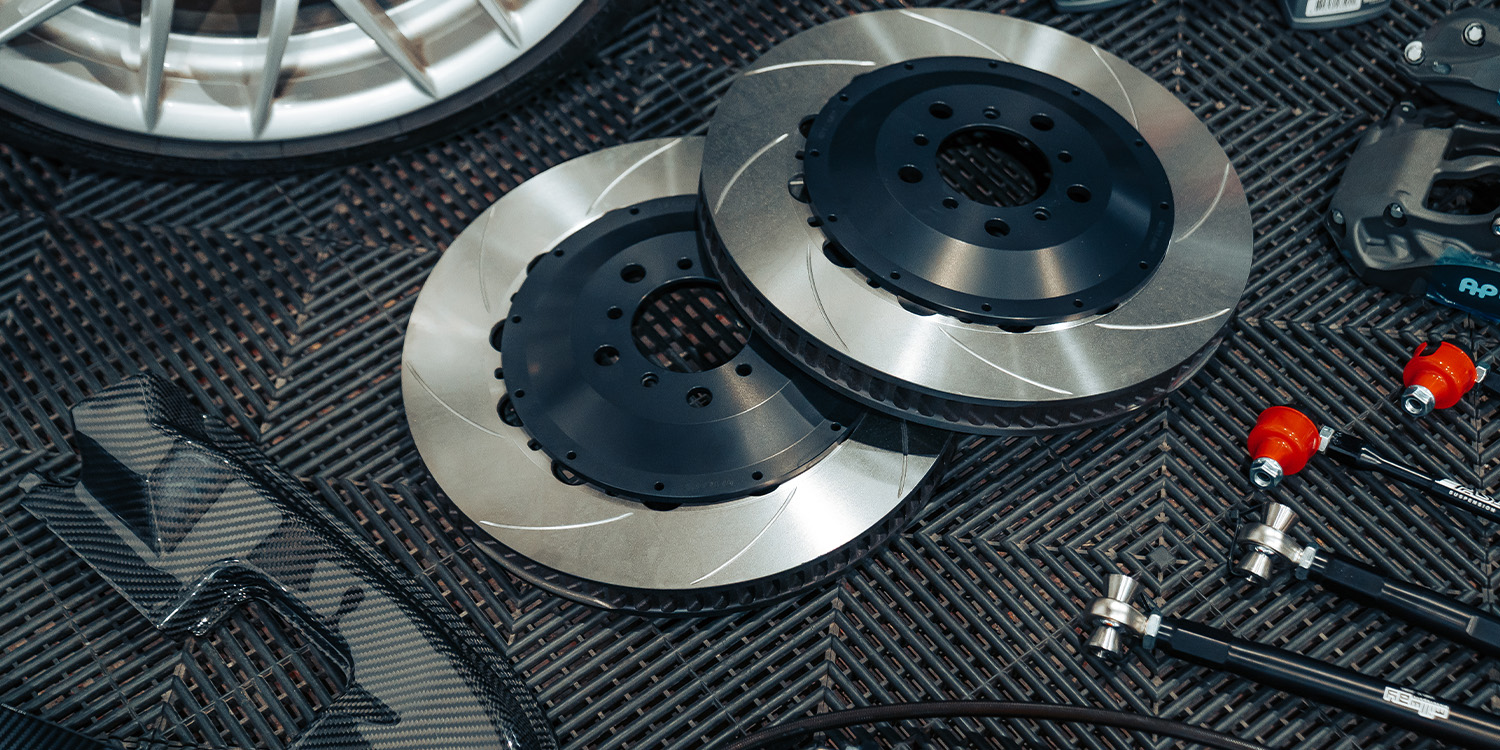

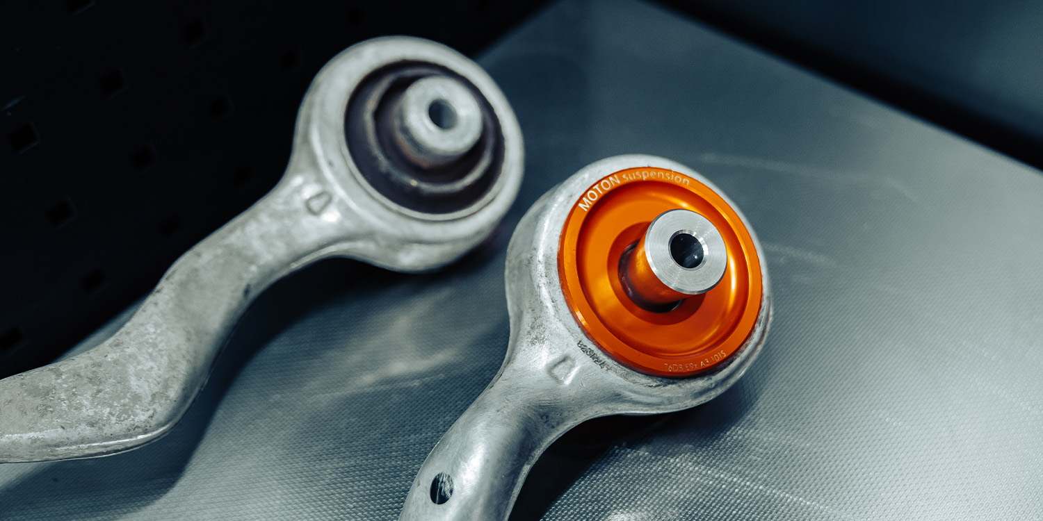

We’re also fitting MOTON solid front control arm bushes, which remove a lot of unwanted movement under braking and hard cornering. AST adjustable drop links are going in alongside the suspension, keeping things adjustable while still retaining dust boots to help control noise over time.

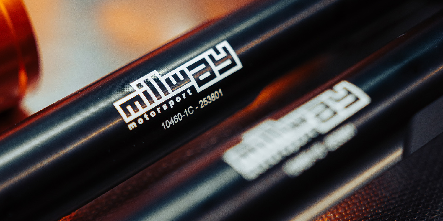

At the rear, Millway adjustable toe arms are being added so the alignment can be properly dialled in. This gives better stability and much finer control over the rear geometry once the car is on the alignment rack.
Braking System
Brakes are another key focus at this stage of the build.

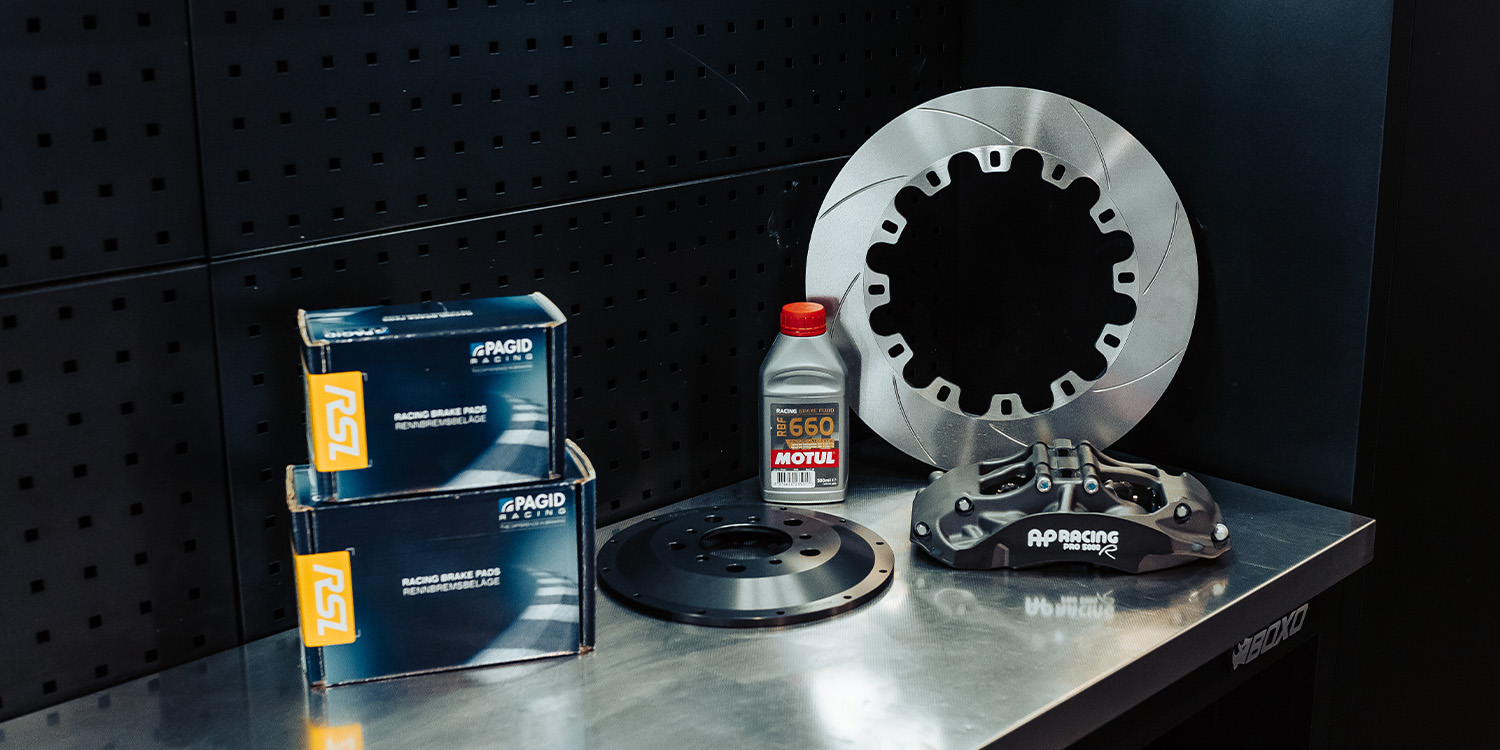

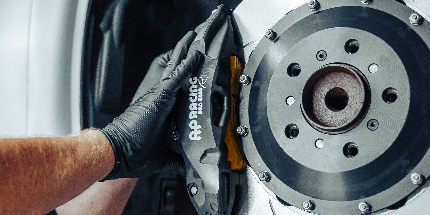

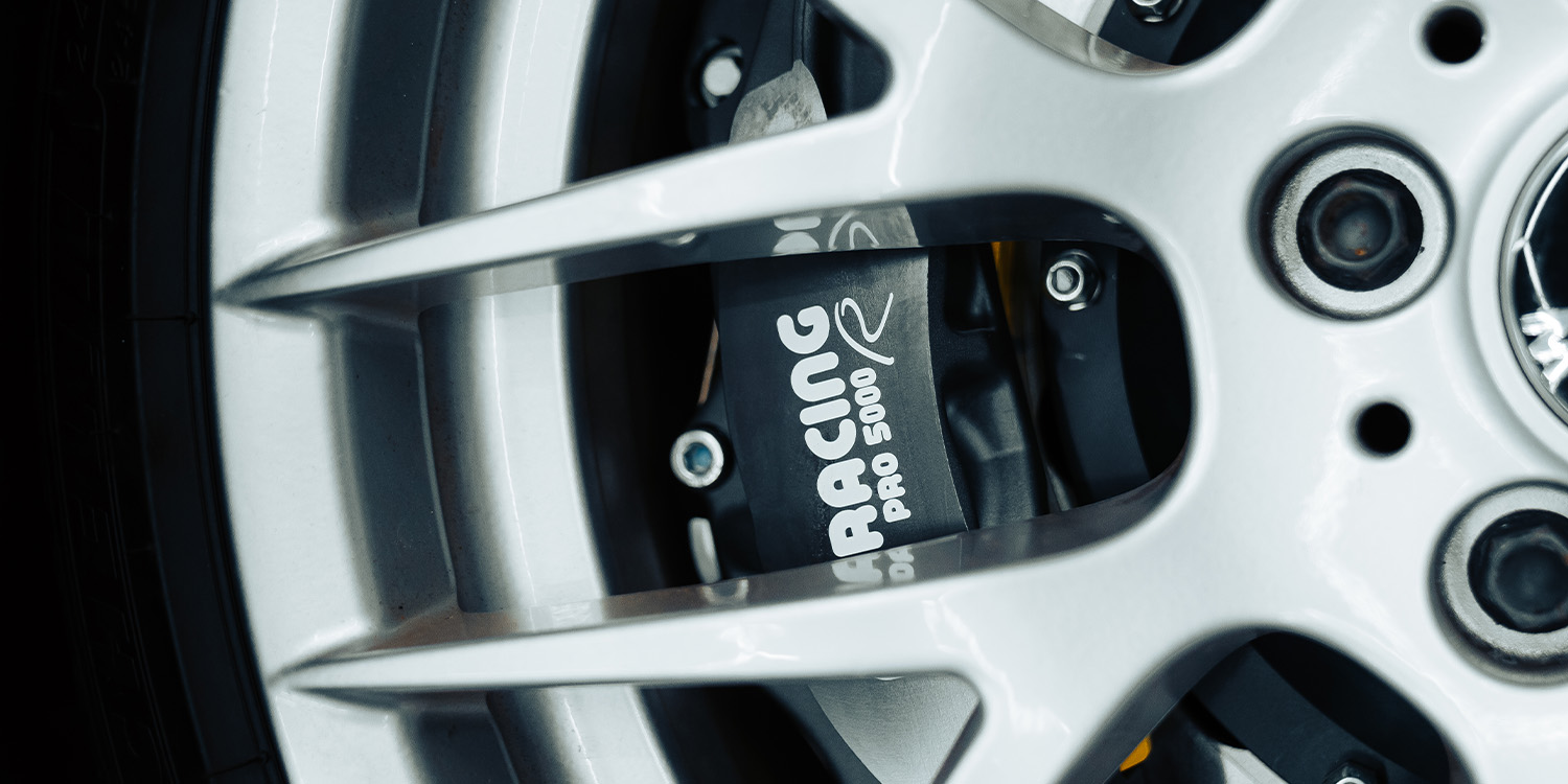

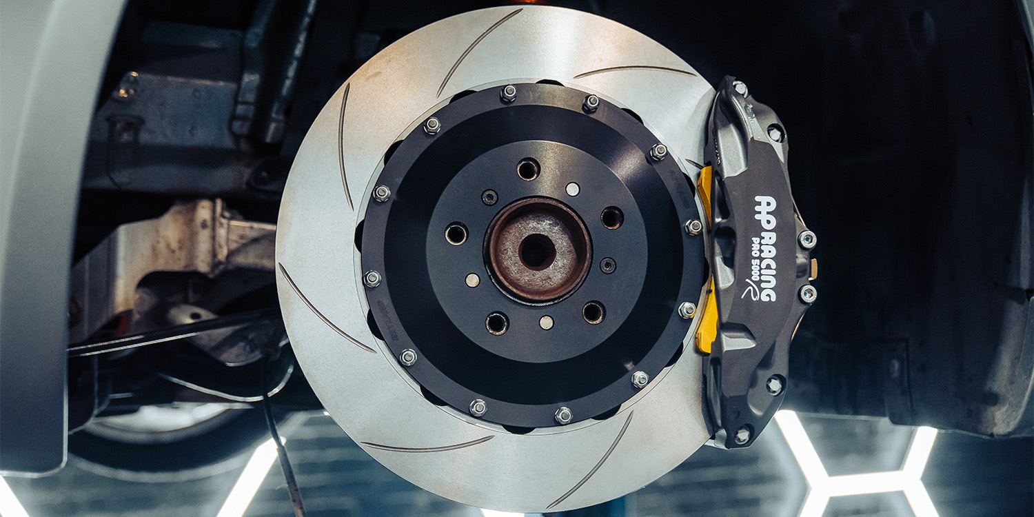

The car is being upgraded to AP Racing Pro 5000 R callipers front and rear, paired with two-piece floating front discs. On the rear, OEM 2NH brake discs are being retained, which work really well with this setup and keep replacement costs sensible.
To complete the system, we’re running Pagid RSL29 pads, HEL braided brake lines, and Motul RBF 660 fluid. The goal here is strong, consistent braking that still behaves properly on the road.
