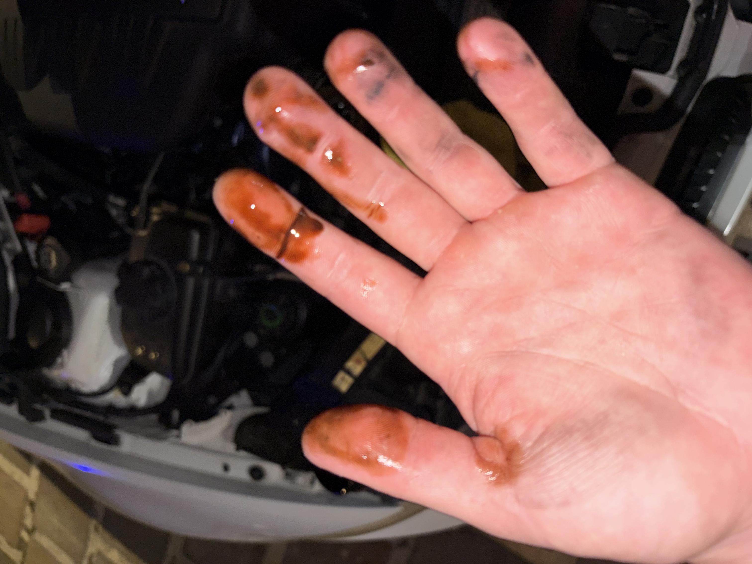

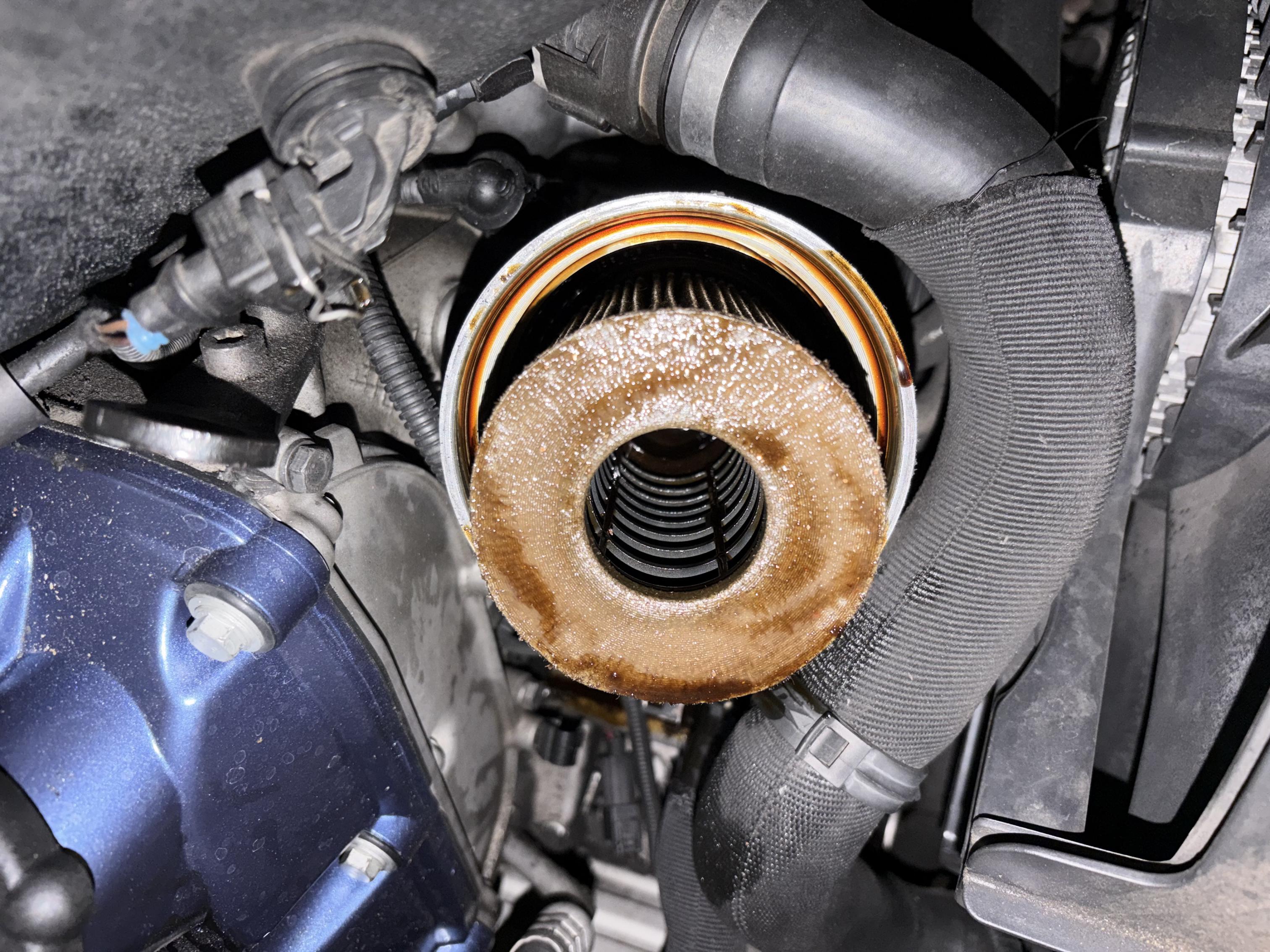

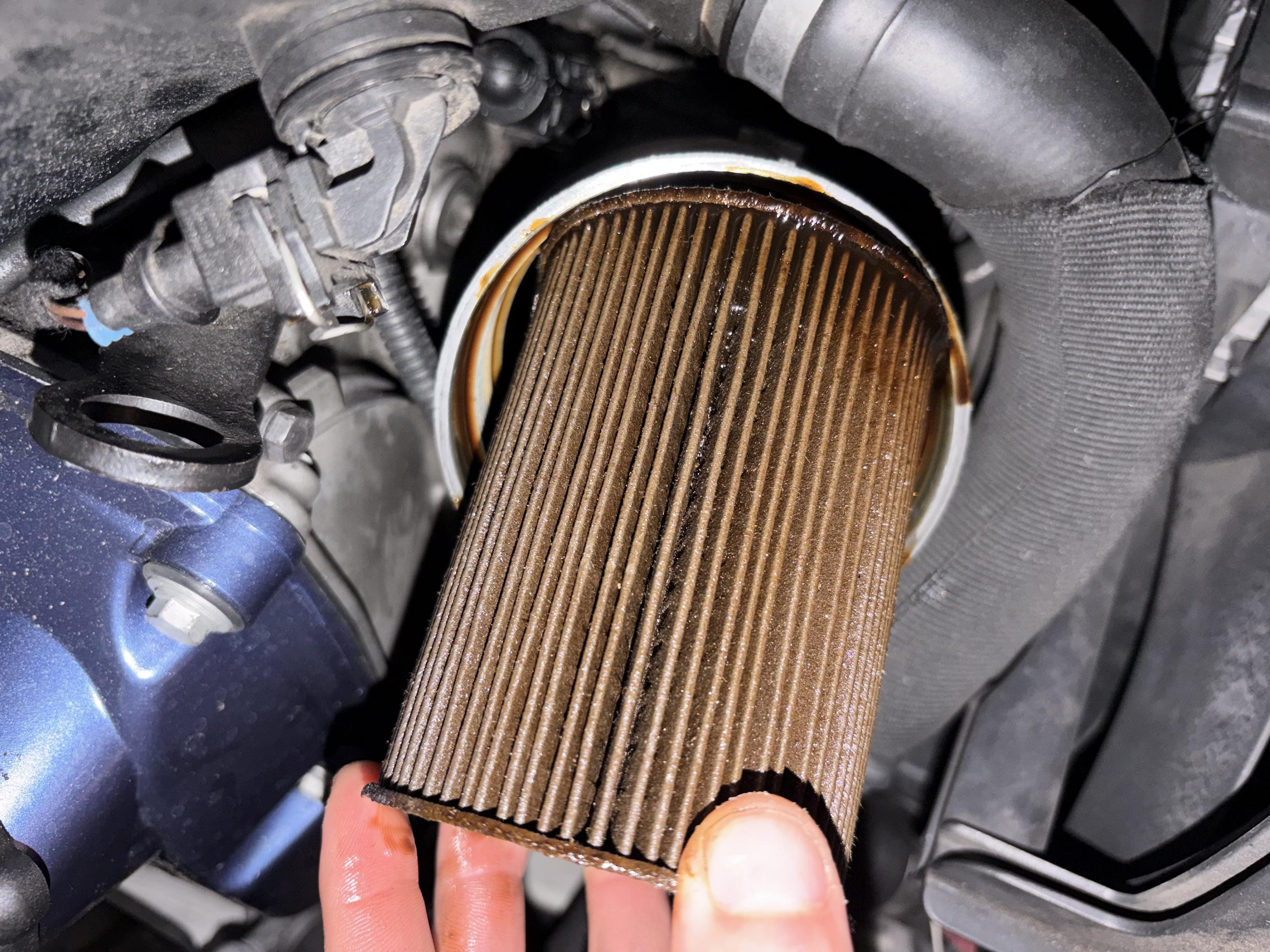

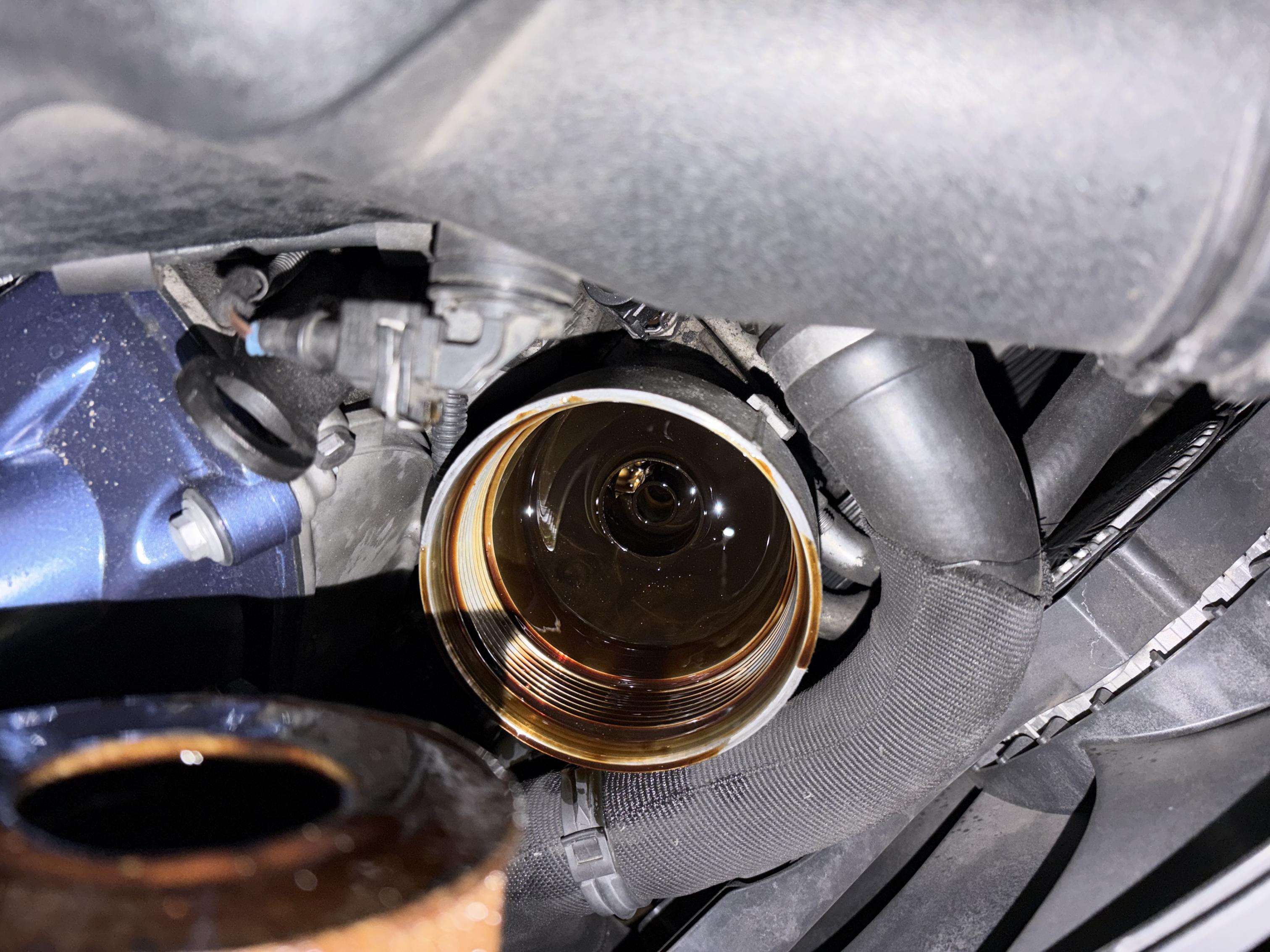

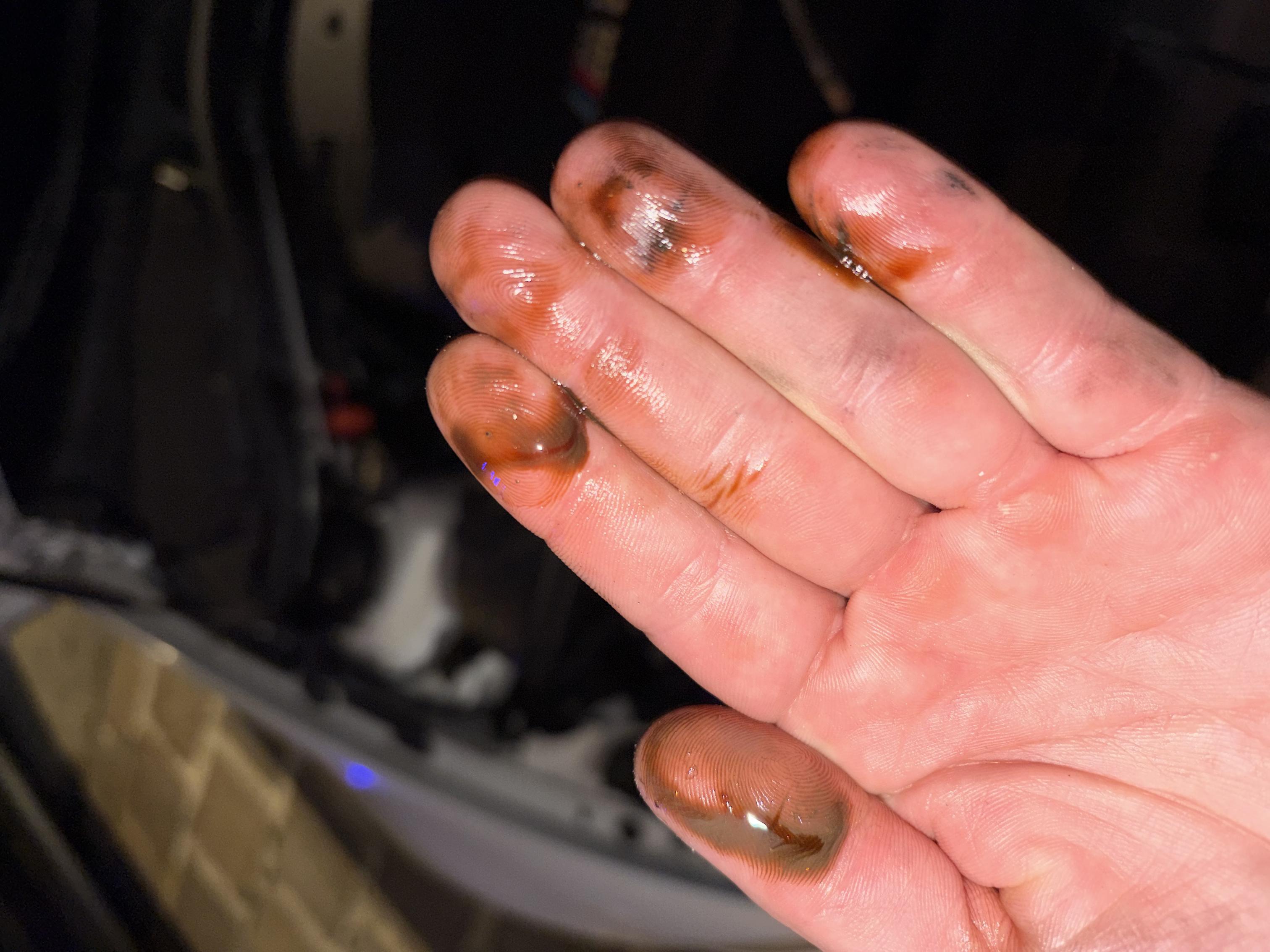

Pulled the oil filter and found metallic flakes (“glitter”) - attached pictures.

Tbh you won't know if it's save-able until you disassemble it and look at the crank mains. Good luck!
Have the crank inspected. The only way to know is to look at the journals. Sorry man.
