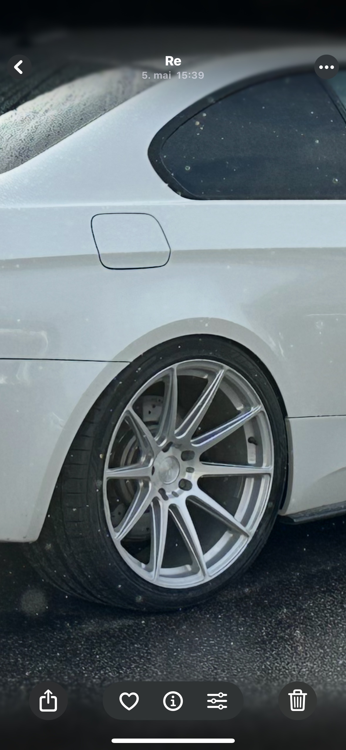

The car is lowerd om springs. Original othervise 😊 i drove 295/30-20 rear before, but that rubs like crasy🥴 that was et35 with 10mm spacer.

Bad picture, but 295 on the 20x10.5 rear rim.
255/35 & 275/35
or
255/35 & 295/30
