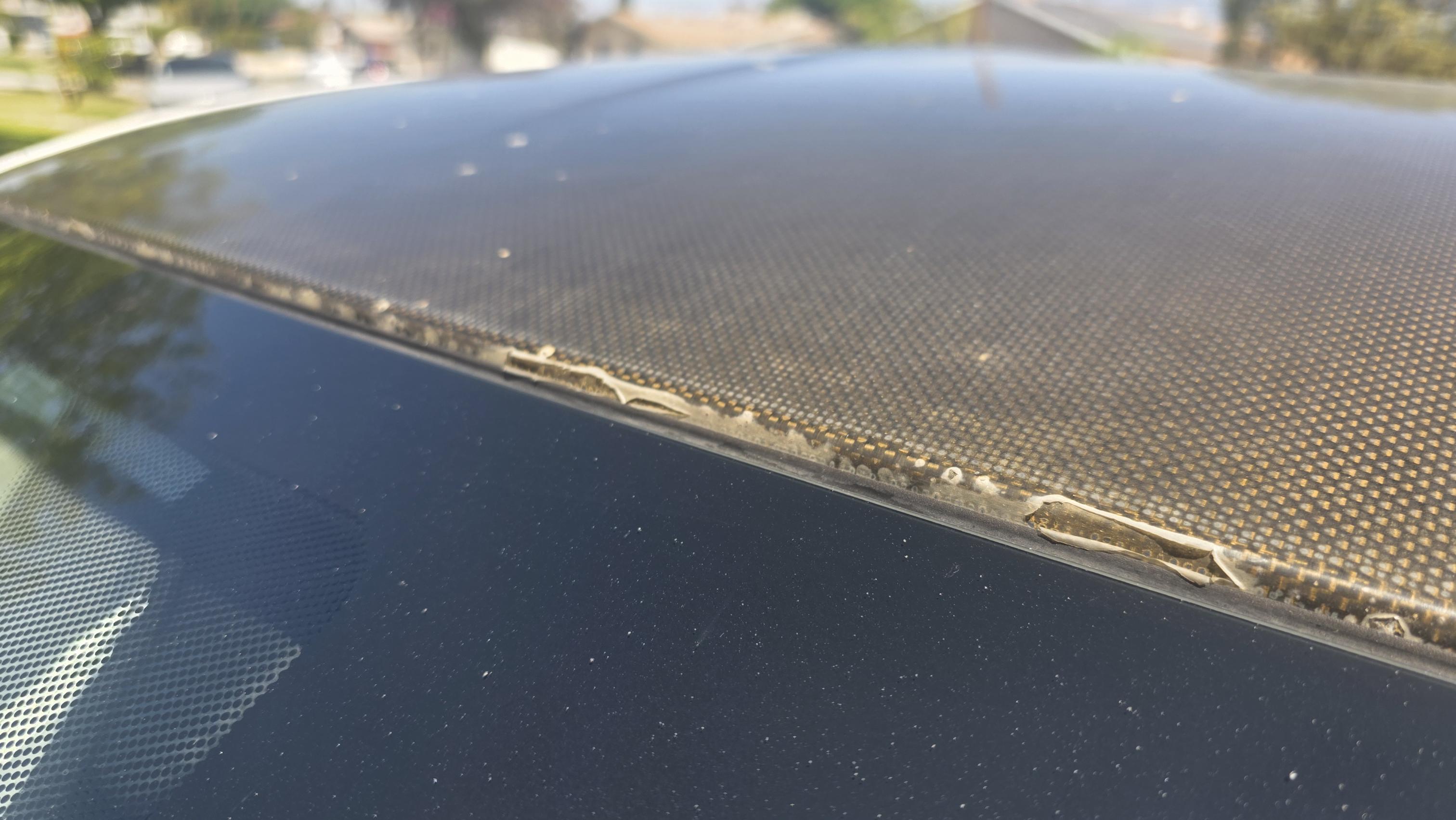

This was a response I received from another poster, when I mentioned that I covered my roof in PPF due to oxidation or yellowing.
Basically, clear coat does not yellow. Gel coat will yellow and deteriorate because it is sensitive to UV rays. Clear coat protects it.
Unlike normal body paint, carbon fiber and gel coat are more likely to peel off than normal body paint due to expansion and contraction problems caused by heat. In the case of a carbon roof, delamination is more likely to occur between the gel coat and the clear coat. Certainly the protection film will protect the clear coat, but the protection film itself will yellow. And when you remove it, the clear coat may peel off.
High quality clear coat is the best choice for UV protection. Protection film is recommended for stepping stones. Afterwards, if you get hit by a skipping stone, please close it with clear coat as soon as possible, even if it is just a touch-up. It may peel off rapidly from there.

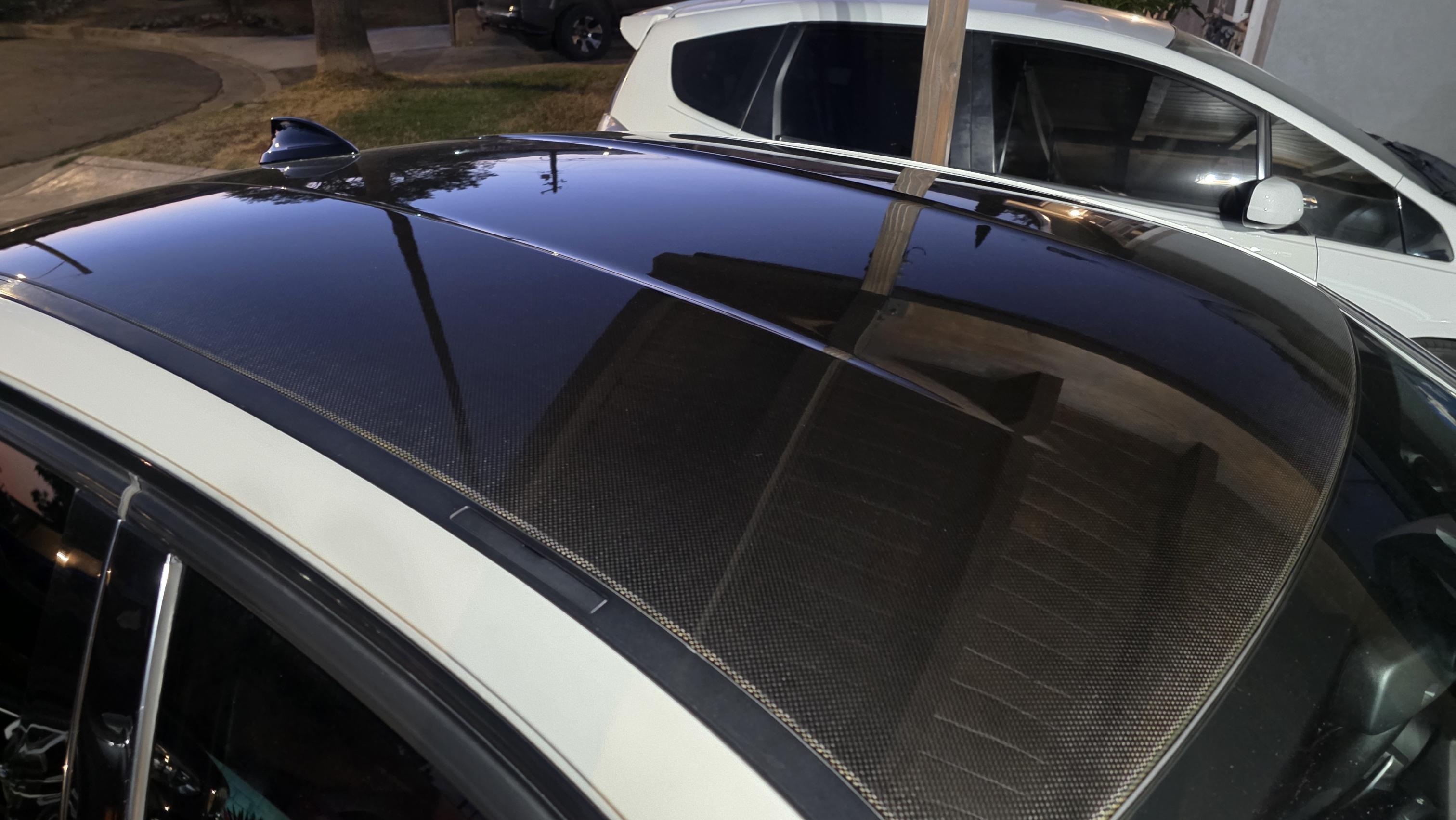

Unfortunately, PPF will not save you from golf ball size dents. But can in most cases save you from small rocks skipping off of the roof, and UV damage. In my case they first clean the CF roof, then used a clay bar to remove contaminates, then did a 2-Stage compounding and buffing process to remove oxidation and scratches. Before applying the PPF and ceramic coating it. And I think that it came out beautiful. And most importantly, I have a 10-year warranty on the PPF, and 6-year on the ceramic coating.

if i ever get back to this "luxury" used car dealer i must take pics of the older M cars with the neglected CF roofs on them they have sitting there. They most certainly will yellow and if a chip gets through the clear, forget it. It just unravels and cracks more so quickly it'll make your head spin it seemed.
I really must go there and put it on this thread, it's like they only sold the most trashed euro luxury cars there are. so sad

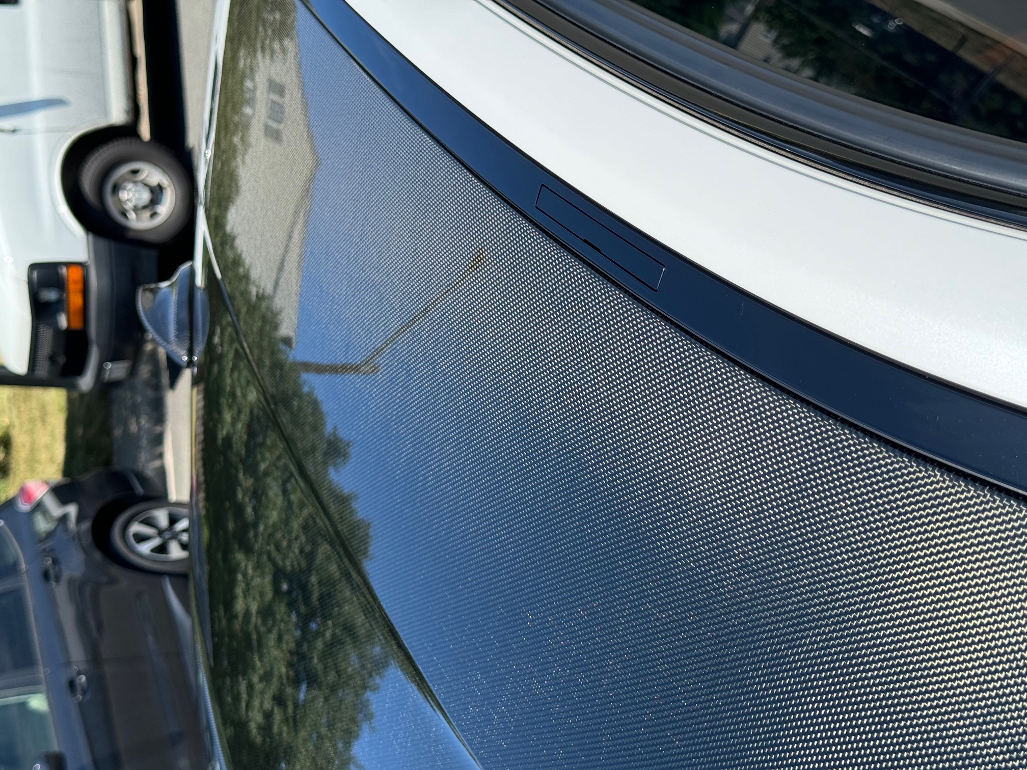

Just got my roof redone so was thinking about doing the same. PPF and ceramic coating.. some before and after
What year is your car? Do you often park outside?
That carbon roof is looking good. :bow:
