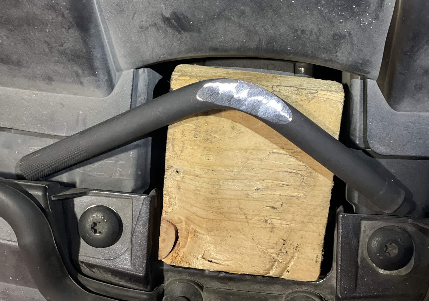

I took a grinder to the key. I ground it just enough to not interfere. It was still kinda tight, could probably have gone further. Also, I did it for an orientation that would be difficult without removing the water pump pulley. I removed that, easy enough.
Also, in retrospect I learned the BMW service manual states two different locking keys, one for use with engine out and one for use with engine installed. The one for use with the engine installed is basically just a cut off version with a string on the end. Why none of the tool kits consider this, I don't know. Also, why not just always use the shorter one??? Seems that would be easy enough with engine out also. If I owned the kit I suppose I'd just cut it off, but it wasn't my tool and NRW said I could grind it so that's what I did.
When I did mine, I slightly loosened the locating hole bracket, just enough for the tool to slide in. A bit tight but it worked fine. I checked the timing using the TIS procedure afterwards and it was all good.

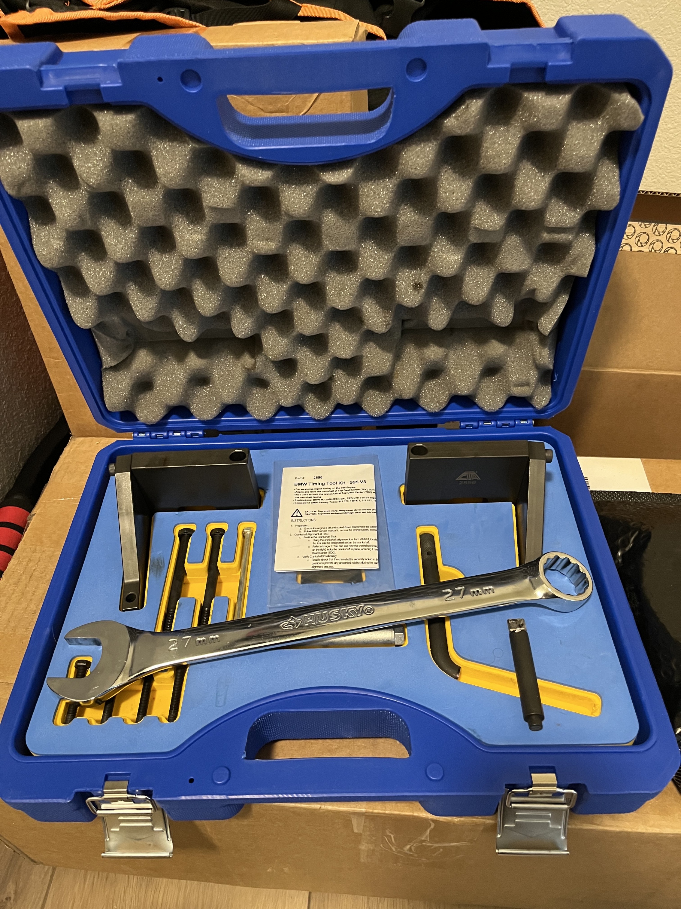

Not to hijack thread, but I had to buy the CTA timing tool as they weren’t available for rent.
I had to cut the lock pin to slide in. It did help removing the water pump pulley but should fit with it on. I have mine available with the 27mm wrench and TIS.

What about heating and bending the locking tool so it clears the coolant hard pipes? Wrap the business end in a wet rag and give it some hell with MAP gas.

Would you happen to have the part number for the shorter tool?
It's nice that NRW rents the tool out, though it would be better if they modified it to fit, or bought the kit meant for in engine service. I plan on going this route when the time comes (hopefully this coming fall) and would love to support the OG MPorium Vanos Cups, but they no longer rent the tool. Unless I'm looking at the wrong tools, they look like they are 300 minimum to buy, for a tool I would likely never use again. At that point I would probably just pay a trusted shop to do the job.

For step 4 in the OP, my cams seem to be somewhere between 26.5mm and 27mm, so I used a 27nm wrench.
I ground my lock pin tool just enough to clear the hard pipe, but reflected from what rollsISU's user avatarrollsISU did. No pulley removal required, but I did pop the belt loose.
It seems the CTA tools had a bad batch of cam timing tools out which didn't clear the cams correctly, but they're proactive about replacement if you get one of the incorrectly sized sets. Mine were sized correclty, but given the timing spec of this engine, I wouldn't have tried removing material from the cam locks without a mill.

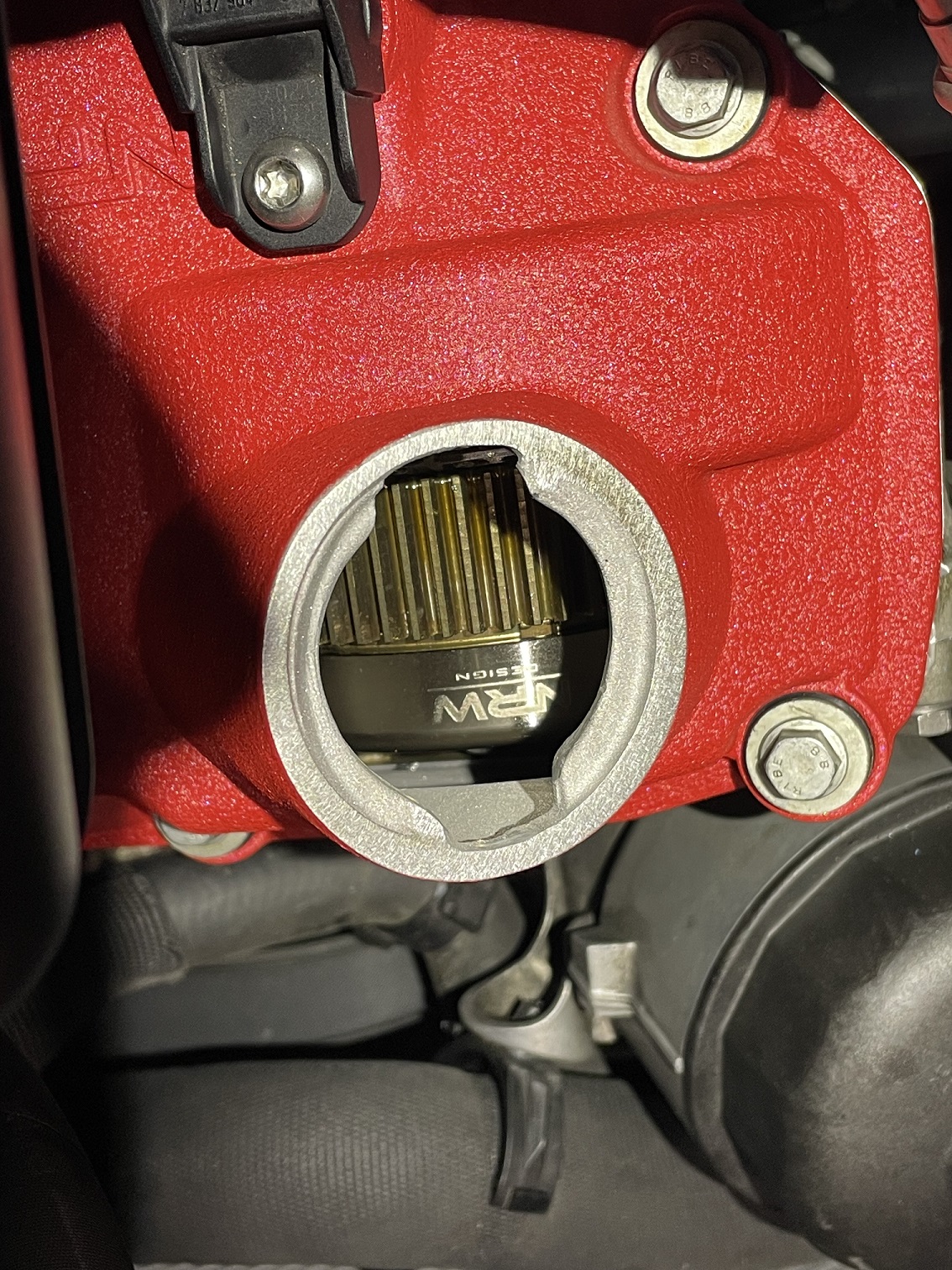

NRW pr0n:

As far as how my grind is different from rollsISU's grind, if you look at his pics and mine, you'll see that mine's ground on the other side from his and that its position is ~180° rotated vs his when installed. I just marked the closest point on mine after attempting a test fit, then went to town in that location, test fit again, ground off some more, repeat, until it fit with decent clearance. Mine just barely passes the pipe when installing (you have to wiggle it a little bit until it finds where it's happy and then it just falls in), and when fully in its sleeve, it's got the clearance in my installed image. Then it drops another ~5mm or so when it's in the OT or 10° slot.
Mine:
rolls:
Mine installed:
rolls installed:
Now that I'm looking closely at the pics, rollsISU is using a Neilson CT5744 tool while mine is a CTA 2896; unsure if that'll make a difference, but the look to be the same.

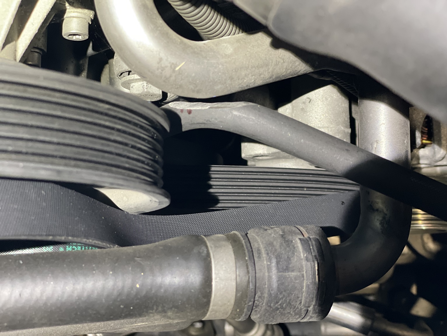

I removed the radiator fan. It was a PITA to remove, as its geometry really doesn't want it to be removed with everything in place, but got a little better when I removed some screws attaching its mount hear the top of the radiator support; this allowed moving that mount out some and it could slip a tab on the fan past the location where the top coolant pipe enters the radiator. Probably a better way to remove it than what I did... now that I think about it, wonder if it'd have been happier going out the bottom...
IIRC, I removed the fan mostly for access to the crank bolt so I could easily turn the engine. And then I didn't have to remove any pullies.
