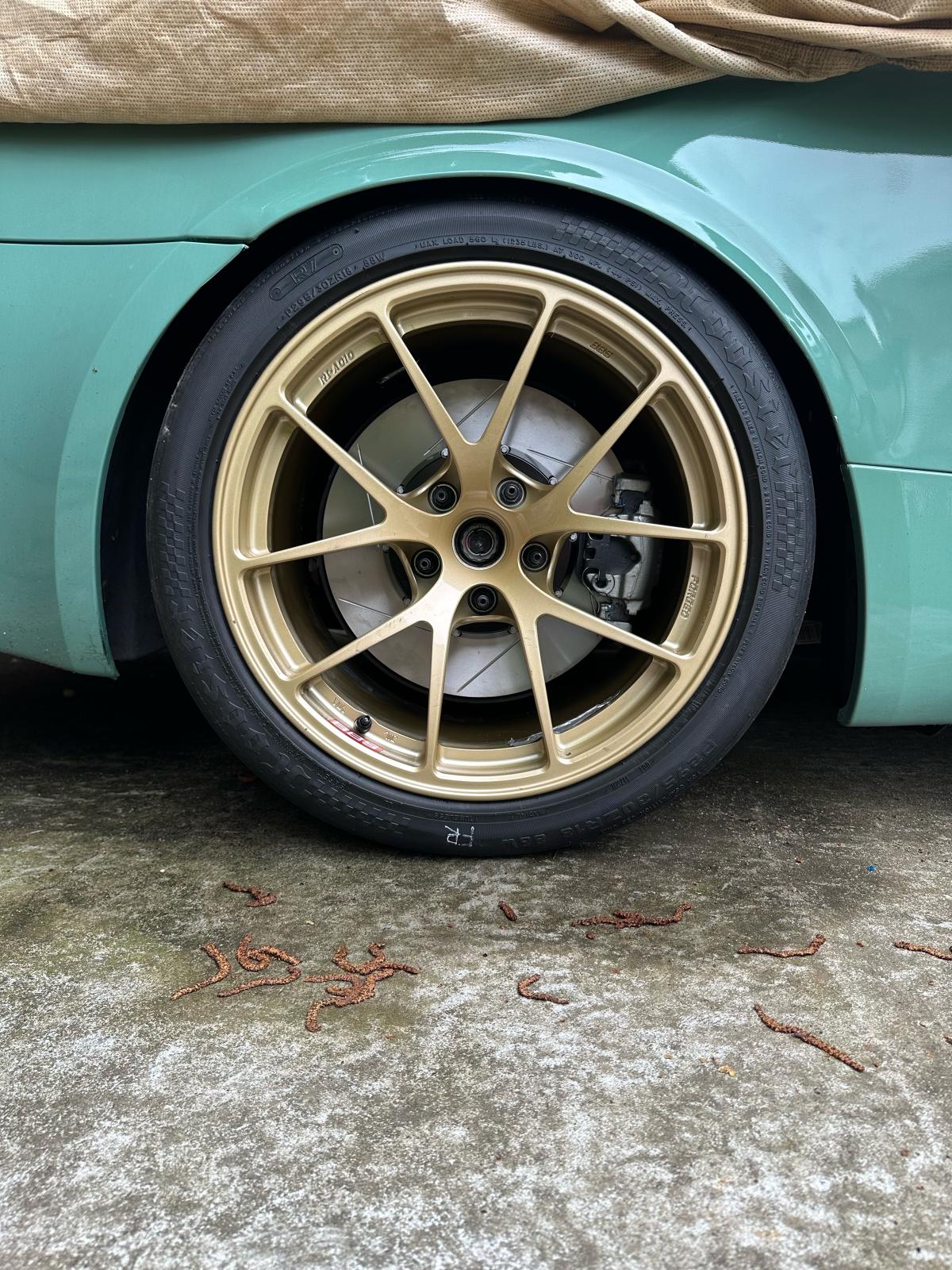

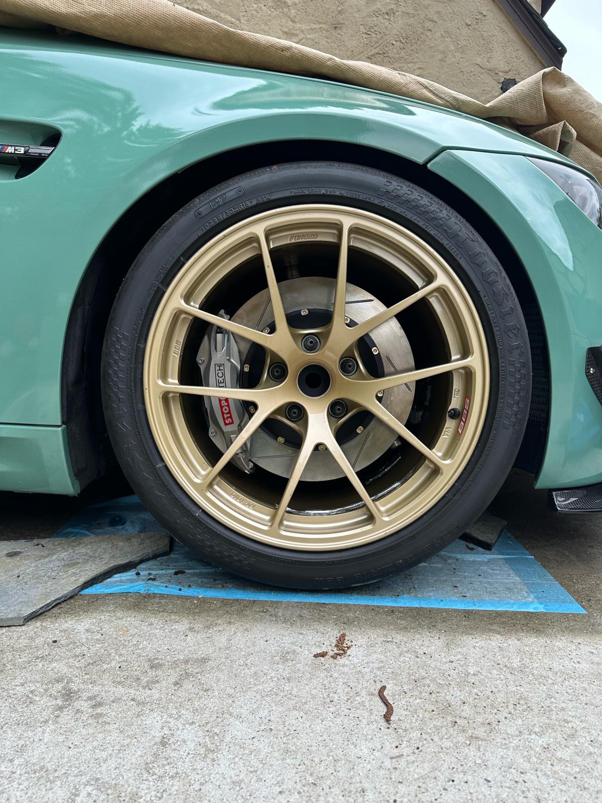

I wouldn’t call it a down grade but I down sized from my PFC front and rear BBK and I don’t need such an aggressive system as quality tires do the braking when hitting the track..people don’t understand that still.
But….i went with the Stoptech ST40R Trophy kit 4piston 355 rotor upfront back to OEM size Paragon slotted rear rotor with PFC racing pads.

Im am running the f10 m5 front calipers with the f80 rotors 380/mm and ECS caliper brackets with SS lines that is all that was needed. Still need to code them in. For the rear I ran f80 rotors and calipers with SLG braket and SS lines.
