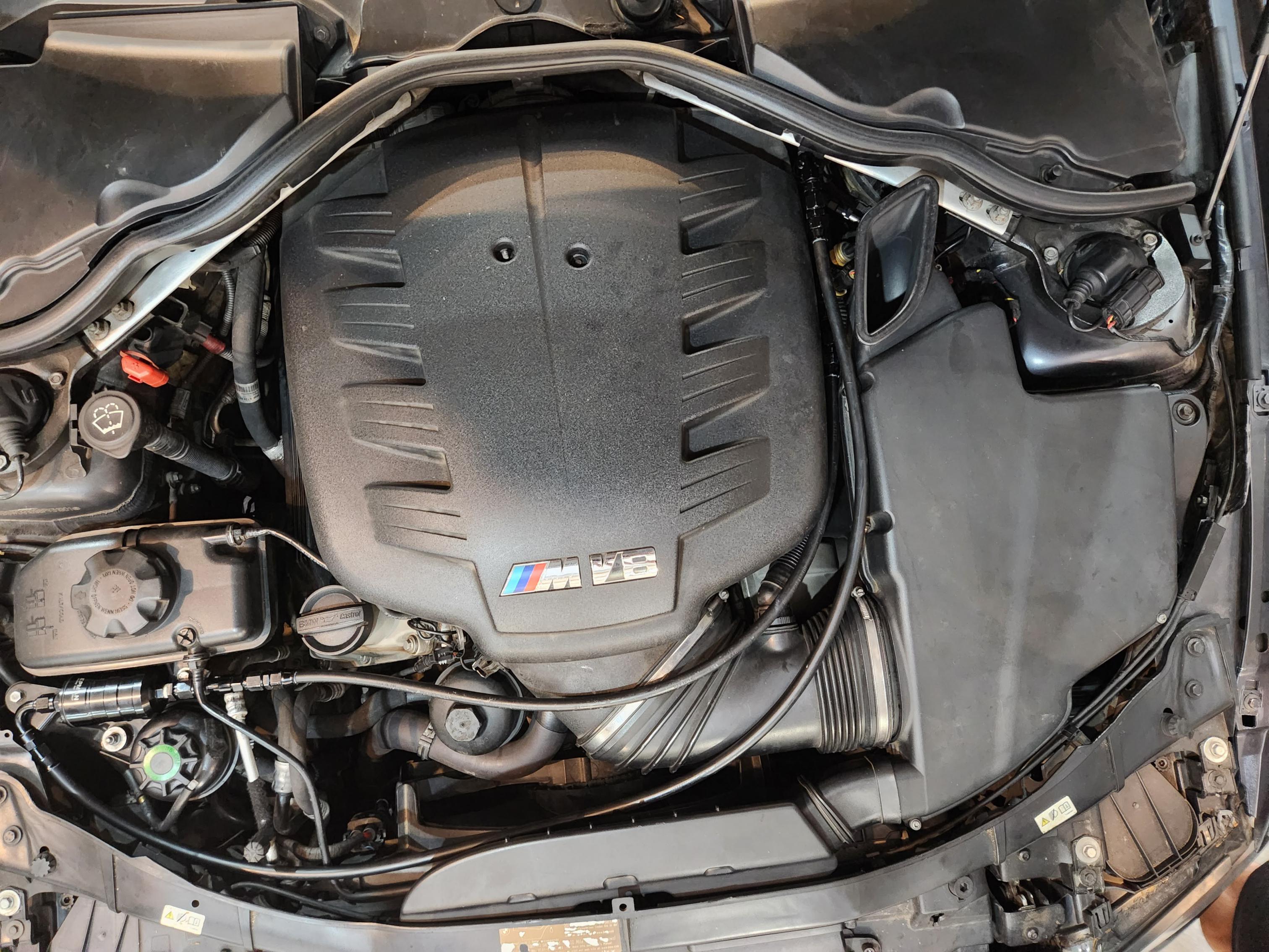

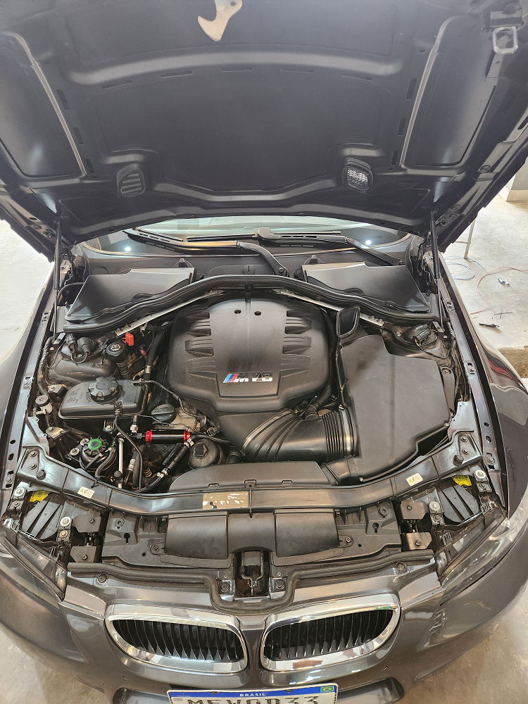

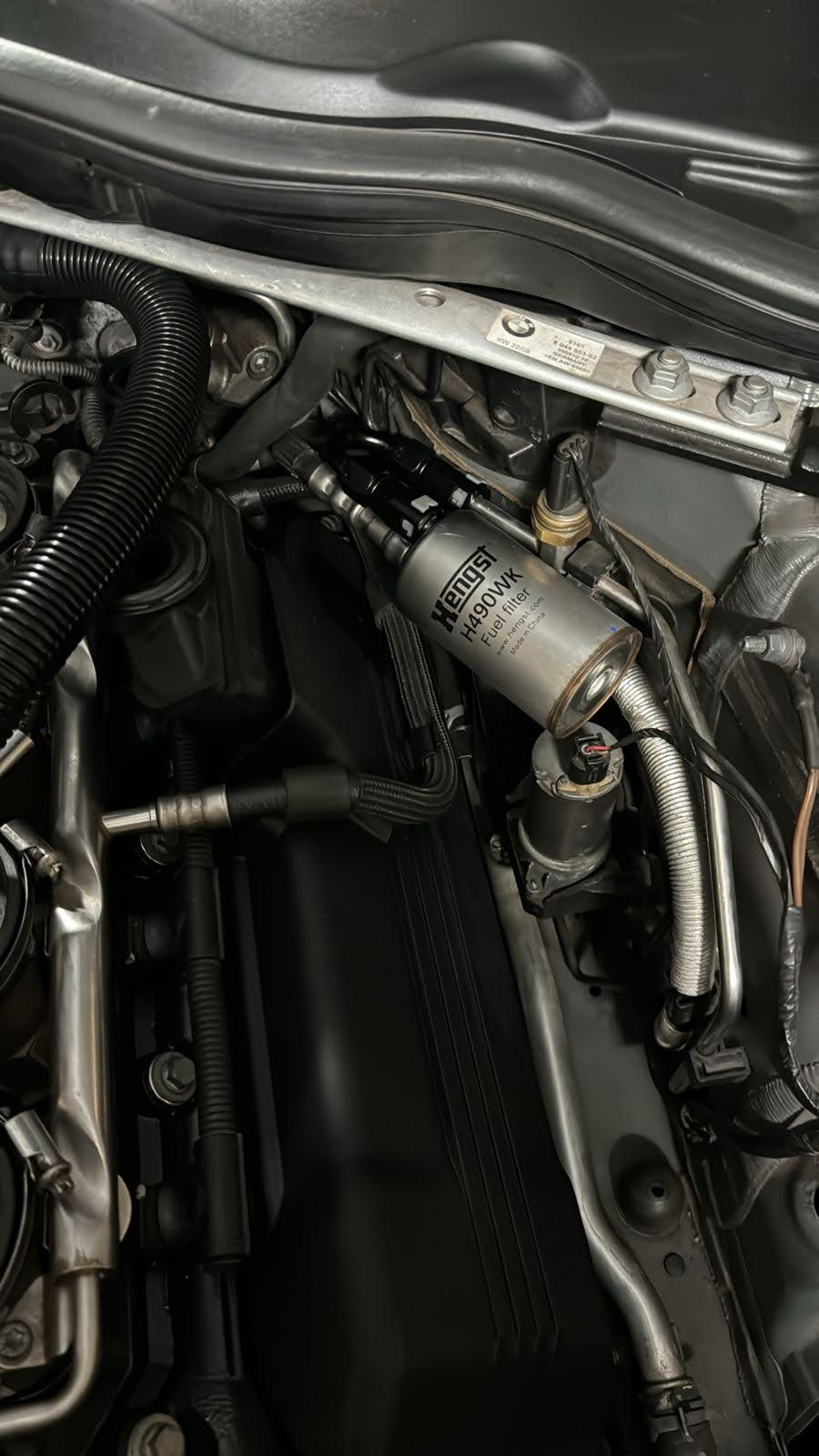

Hi. I just finished installing an inline fuel filter for the E92 M3.
That's an attempt to address the injector sticking open problem.
In case you would like to do it too, check out the video I made.
Any questions, feel free to ask.
10-micron paper filter: EPMAN EP-ZZOF01-BK

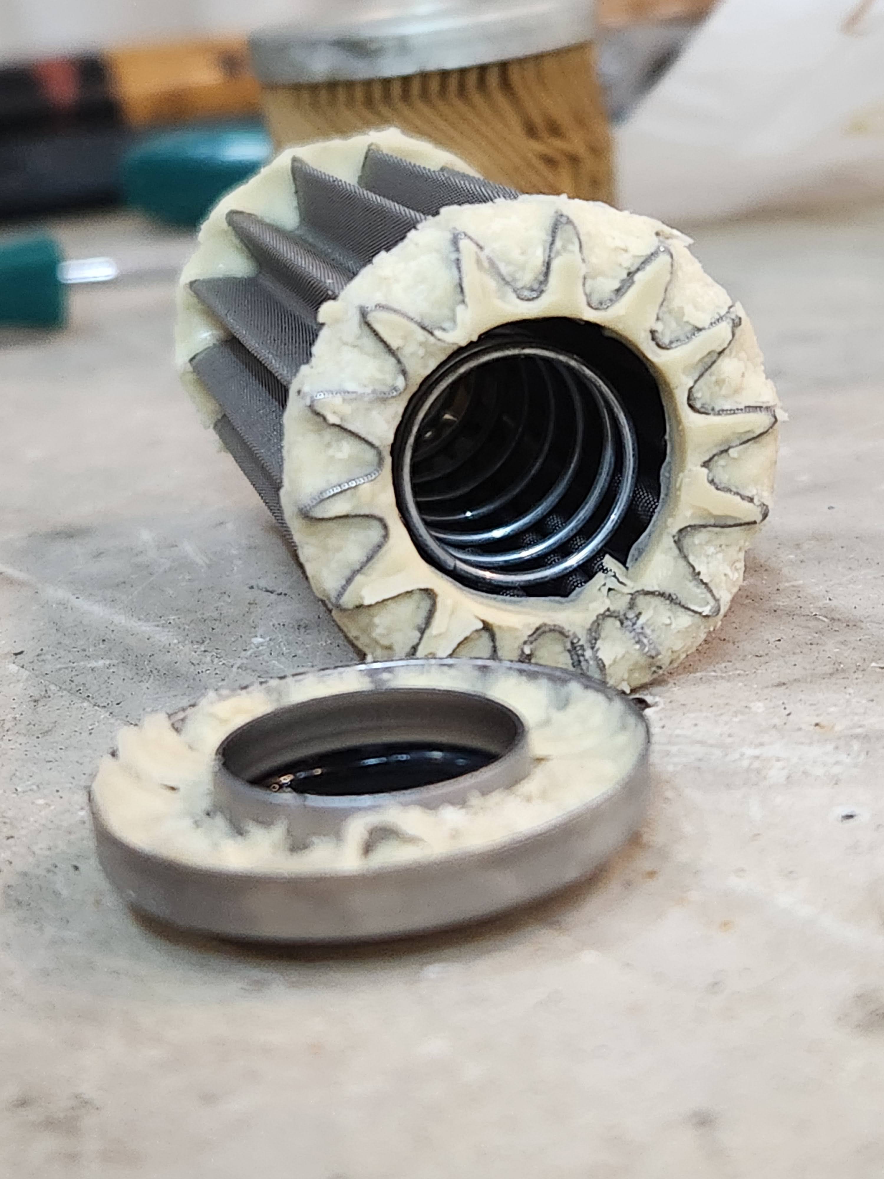

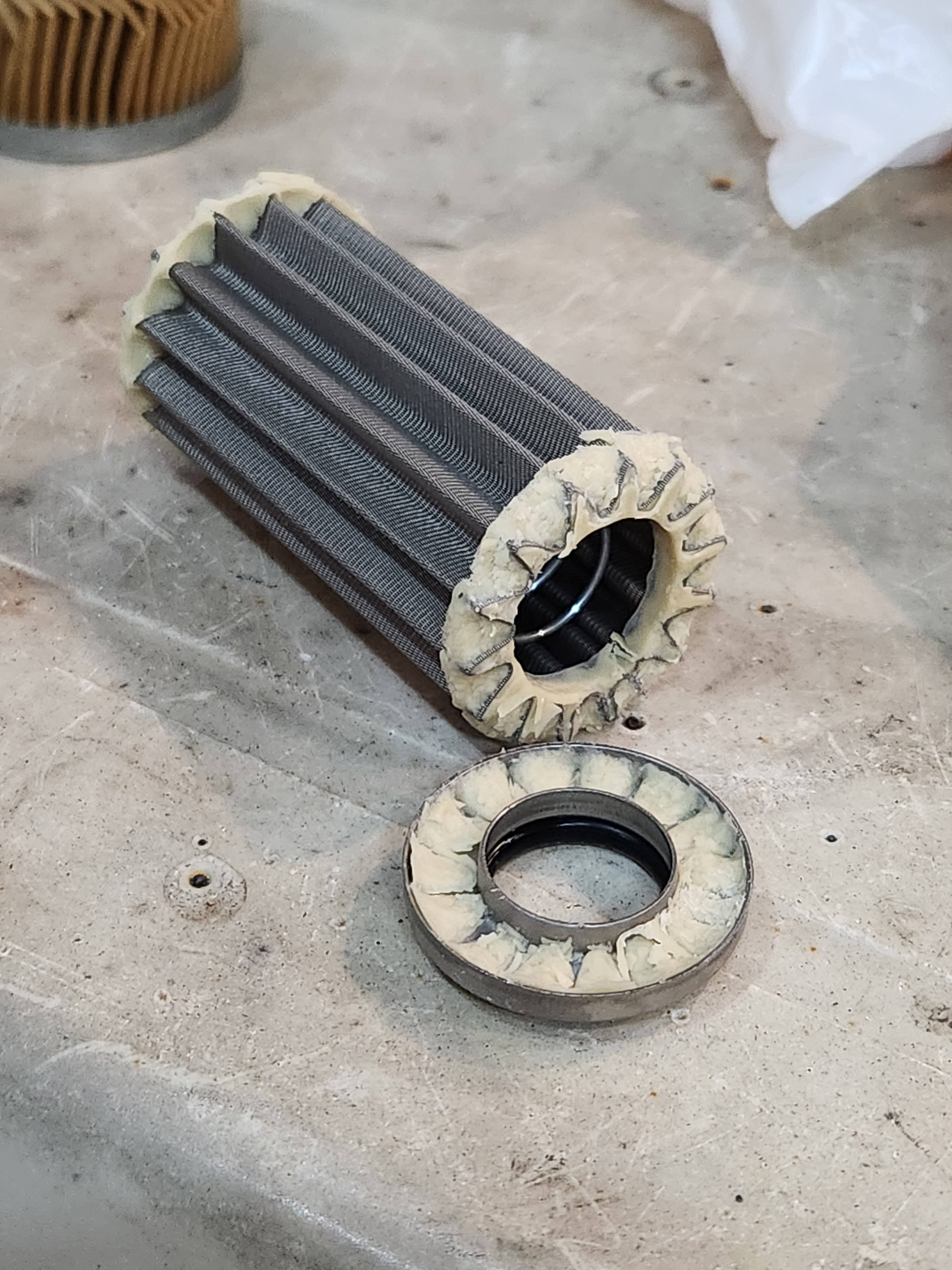

40-micron washable filter: ADDCO ADF09901 (edit: this filter is not a good idea)
You'll also need:
05x Metallic lock quick release fuel fitting FEMALE 7.89mm or 5/16" - MALE AN6
05x Male quick release fuel fitting 7.89mm or 5/16" - MALE AN6
01x Triple display for air pressure for air suspension kit 0-220 psi with 03 1/8" NPT sensors
01x Adapter Female M10 X 1.0 - Male 1/8 NPT
02x 90º angle fitting female an6 - female an6
3,0m of fuel injection hose 8mm or 5/16" ID, 13mm OD, 10 bar pressure
08x hose clamp 11-13mm
03x tee AN6 male - AN6 female - 1/8 NPT
03x adapter male an6 - male an6
04x 45º angle fitting female an6 - female an6
01x tap-a-fuse kit (mini or standard, I'm waiting for it to arrive to know)
01x 5 amp fuse (mini or standard, matching the tap-a-fuse kit)
02x adapter male AN6 - male 1/4 NPT
02x adapter female AN6 - male 1/4 NPT
01x electrical wiring harness tape 9mm x 15,0m
02x hose adapter fitting female an6 - 8mm or 5/16" barb fitting
02x hose adapter fitting male an6 - 8mm or 5/16" barb fitting
Variety of zipties
I bought everything from Aliexpress (except for fuel hose, that was promptly available here in local shops). Cost less than 200 usd.
Ps.: when doing an air pressure test, do it without the filter media, to avoid damaging the media if things go wrong, or even because of any moisture build up, that could damage the paper media.
ps2.: before connecting filtering system outlet to the rail, let it pump a little gas to a container, hence washing the new items you're about to put in the system. don't need to crank the engine, just turning ignition on will start the pump for a couple of seconds (you'll need to repeat it for several times until you achieve one or two liters of gas washing the system)

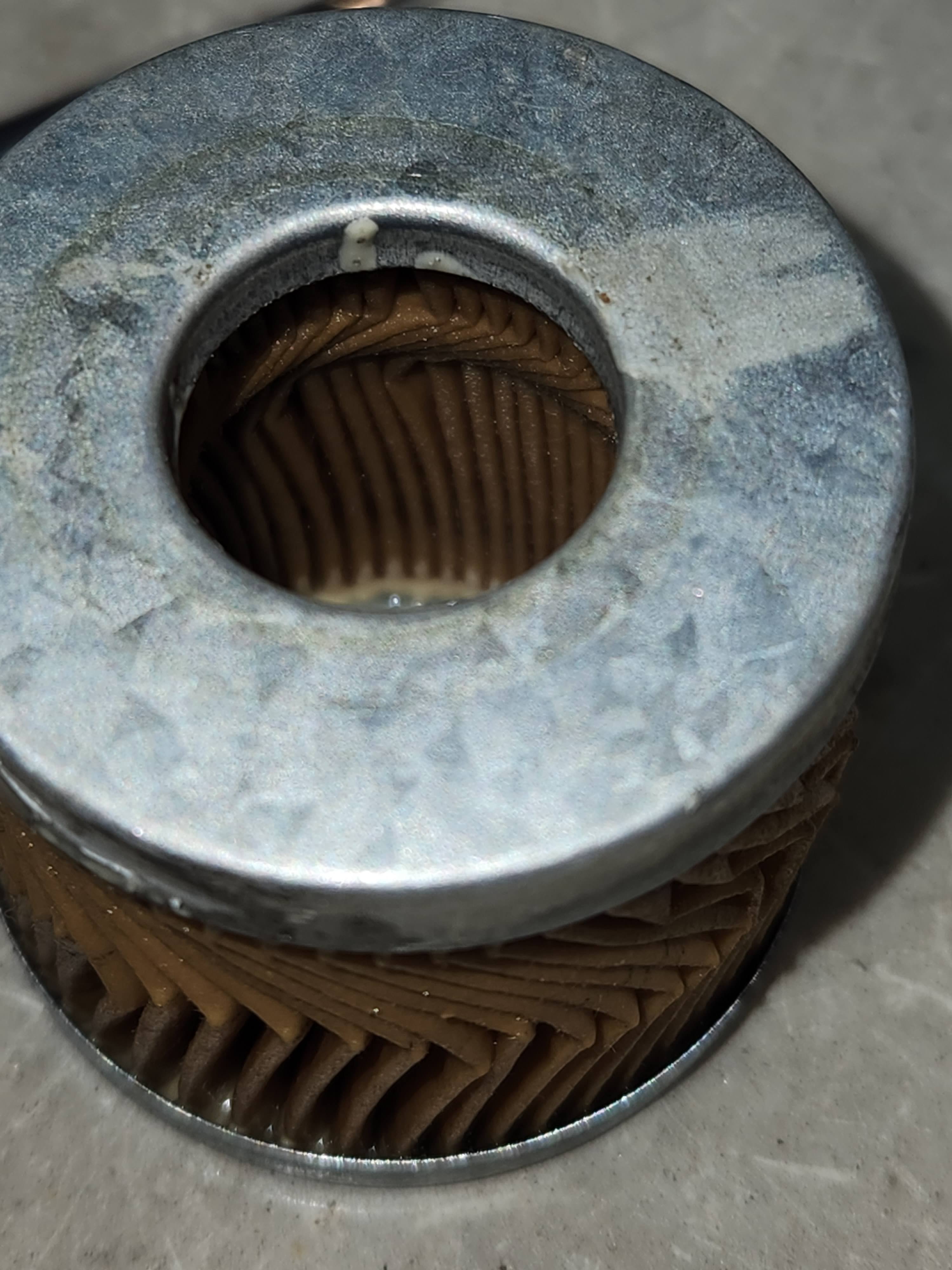

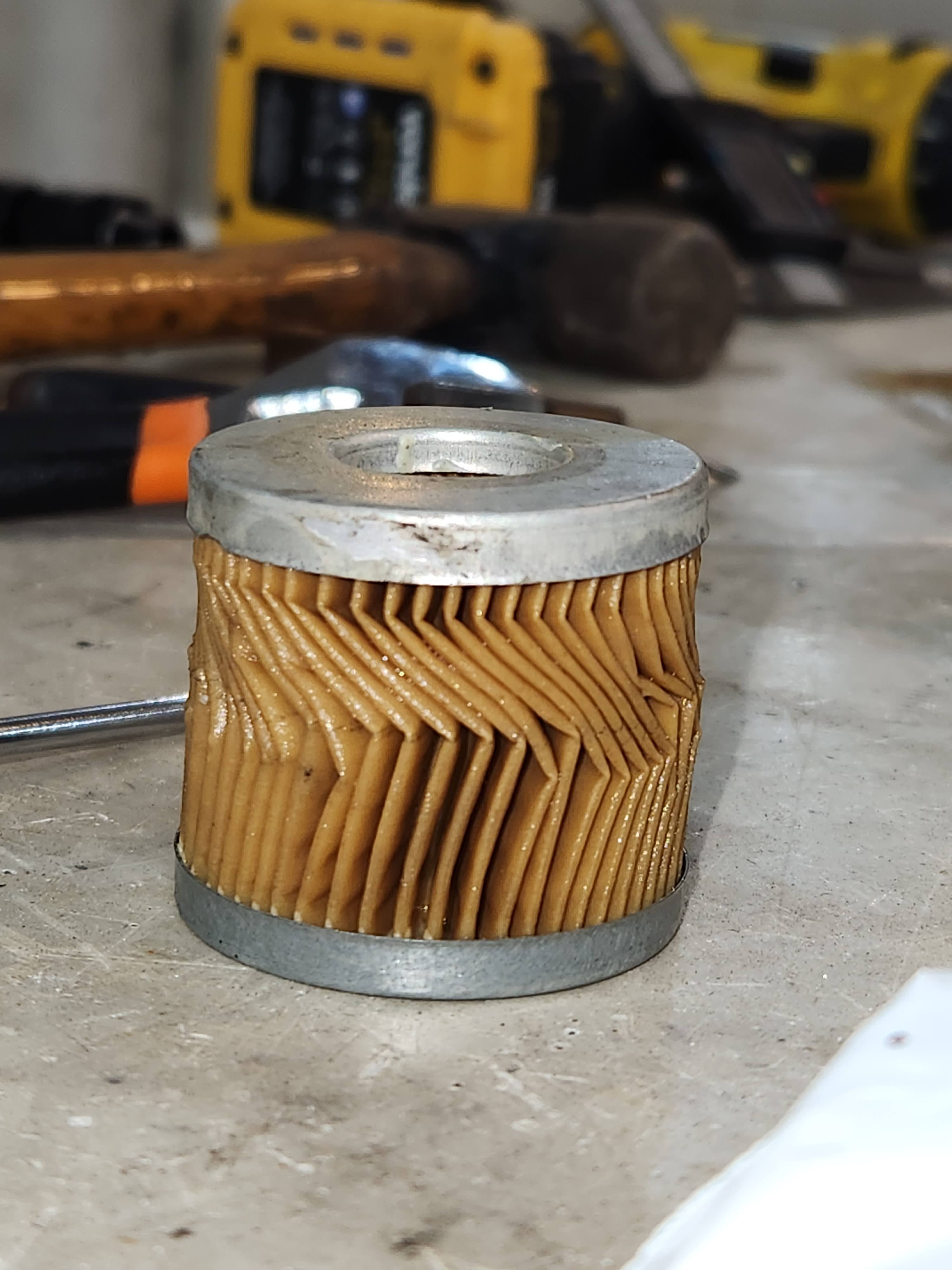

Btw, any idea what micron size the standard filter is?

About the standard filter, I don't know. But I know it's not restrictive, because it would disturb the pump suction pressure, as well as saturate soon, not being able to be considered by BMW as life-time part. People say that the practice in the racing/automotive world is to use 100-micron filter in pump suction.

Reporting back.
5.000km after that, everything is fine. No problems with fuel vapour lock even in hot sunny days (37ºC) with heavy traffic. No problems also related to fuel pressure drop.
Only problem I faced was the metal screen glue didn't support the gas (maybe the engine bay temperature?). But filter screen itself was pretty clean, so I removed it, and now I'm only running the paper filter alone.

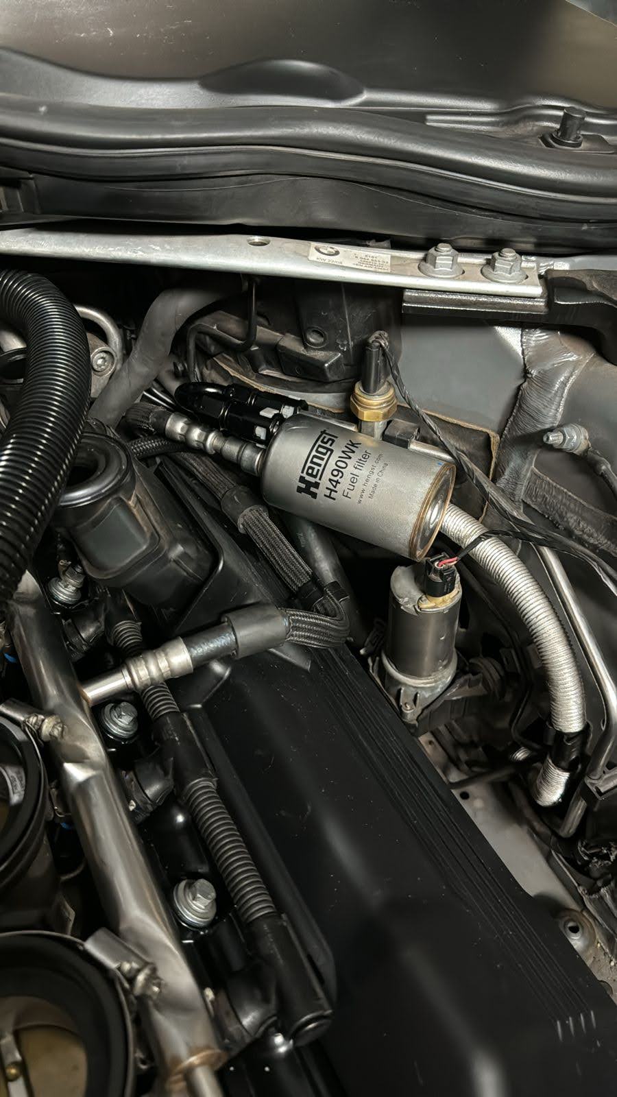

Also, a friend of mine discovered this pretty simple option for using stock filter (from other car obviously, I think it's a Volvo). You will only need to buy a 180 degree 6an fitting and two 6an-5/16" quick connect fittings. Can find the quick connect on improvedracing.com:
https://www.improvedracing.com/raceflux-6an-male-flare-to-5-16-quick-connect-female-plastic-button-adapter-fitting.html
And the 180-degree on ebay or any other store:
https://www.ebay.com/itm/174480357651?chn=ps&_trkparms=ispr%3D1&amdata=enc%3A13qghg8RMSuijy865Pt768g44&norover=1&mkevt=1&mkrid=21527-227144-2056-1&mkcid=2&itemid=174480357651&targetid=358765038384&device=c&mktype=pla&googleloc=2076&poi=&campaignid=19957998899&mkgroupid=149539536442&rlsatarget=pla-358765038384&abcId=&merchantid=102015103&gad_source=1&gclid=CjwKCAiAxqC6BhBcEiwAlXp452d4Xs82yXr8vNcCsZmNJfBLLxZ0COuhjprY8ZclAer1zOUmvYrvdhoC8MsQAvD_BwE
This friend of mine said he didn't face any problems for not relocating the fuel pressure sensor.
Filter is HENGST H490WK.
maicol76 wrote
awesome~
Does this mean that when using this fuel filter, there was no drop in fuel pressure or insufficient fuel quantity (change in A/F ratio)?
I wonder if there were any problems while driving on the track.
Did a trackday last month. No problems with fuel pressure, didn't even remember there was a fuel filter in the engine.
A/F ratio is managed by ECU and throws fault code if it's off the setpoint. Not happened neither.
Edit.: sorry, I was talking about my filter, not my friend's. He didn't take it to the track yet.

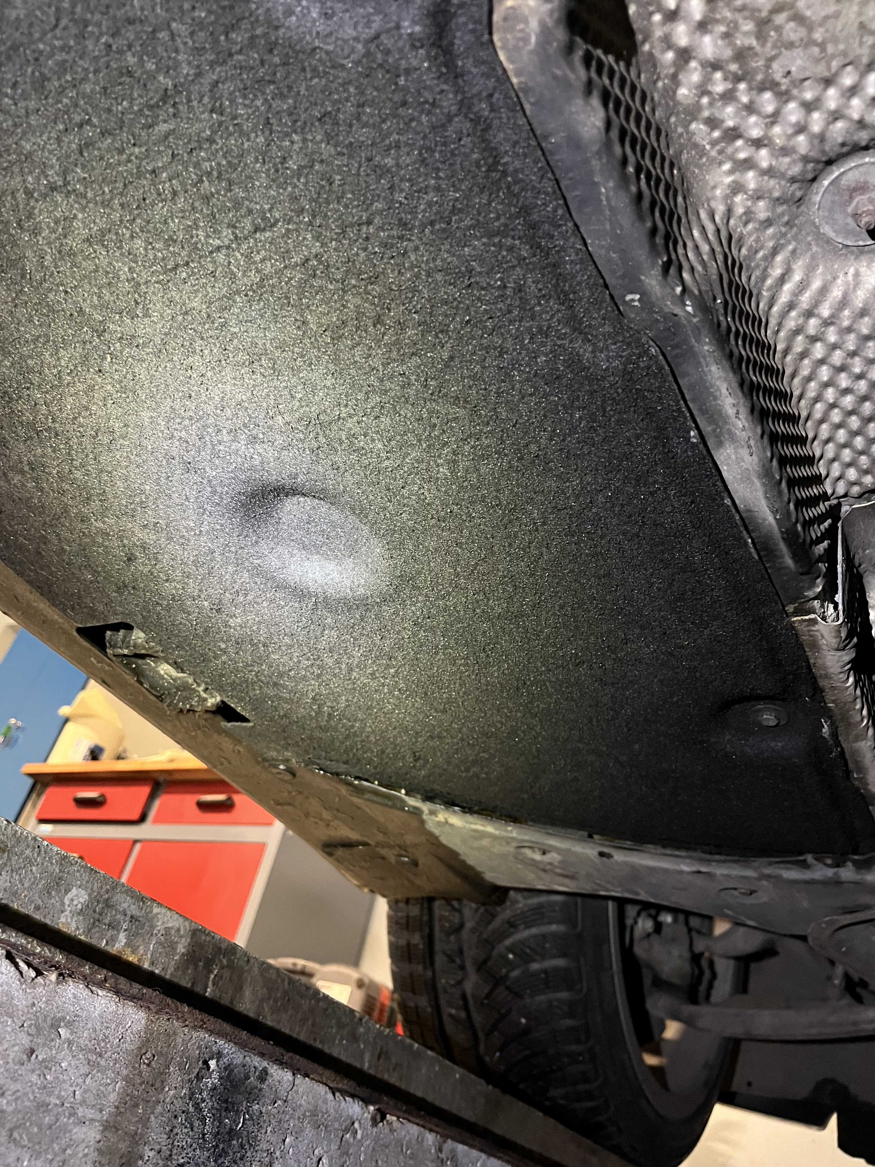

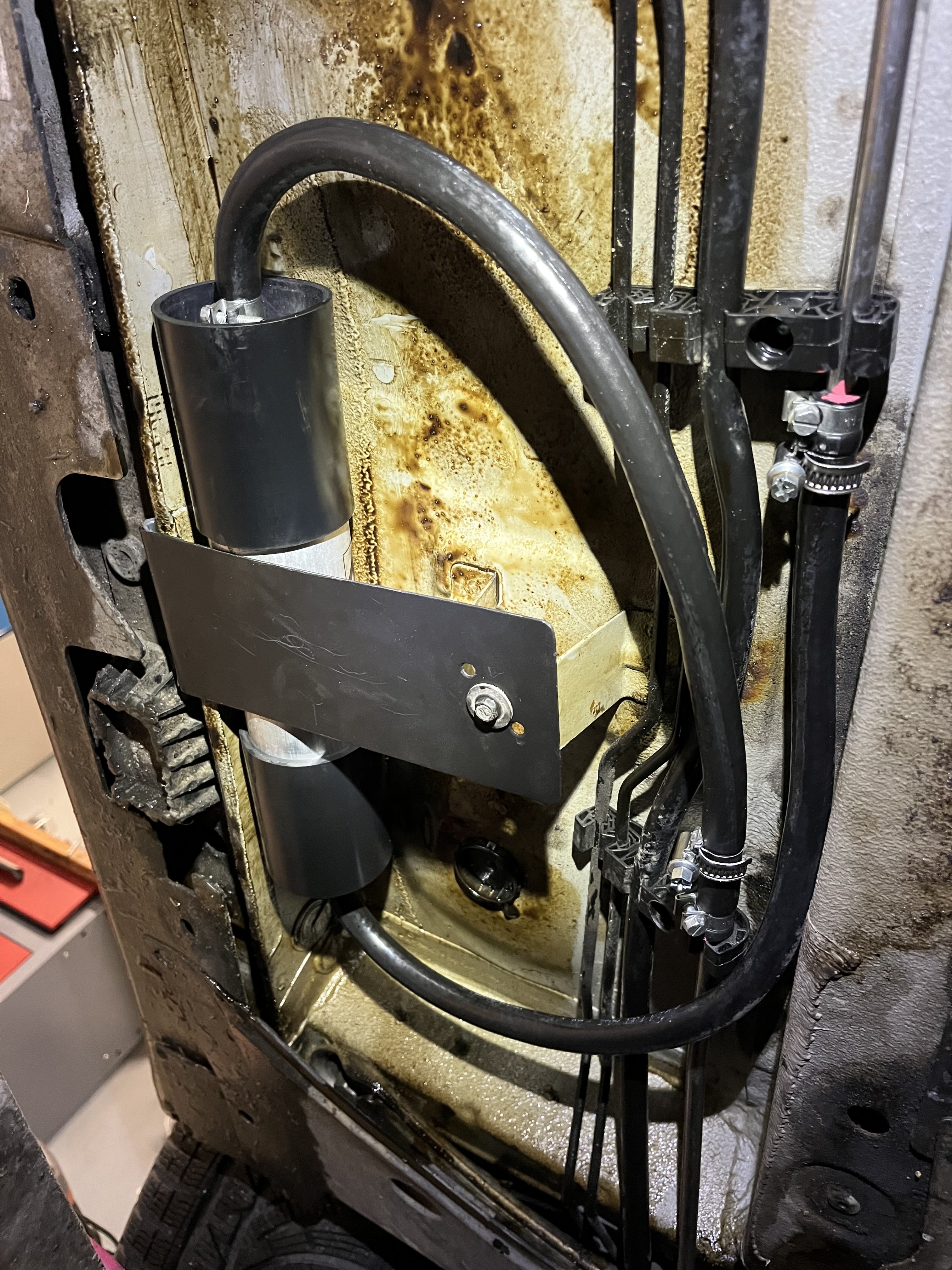

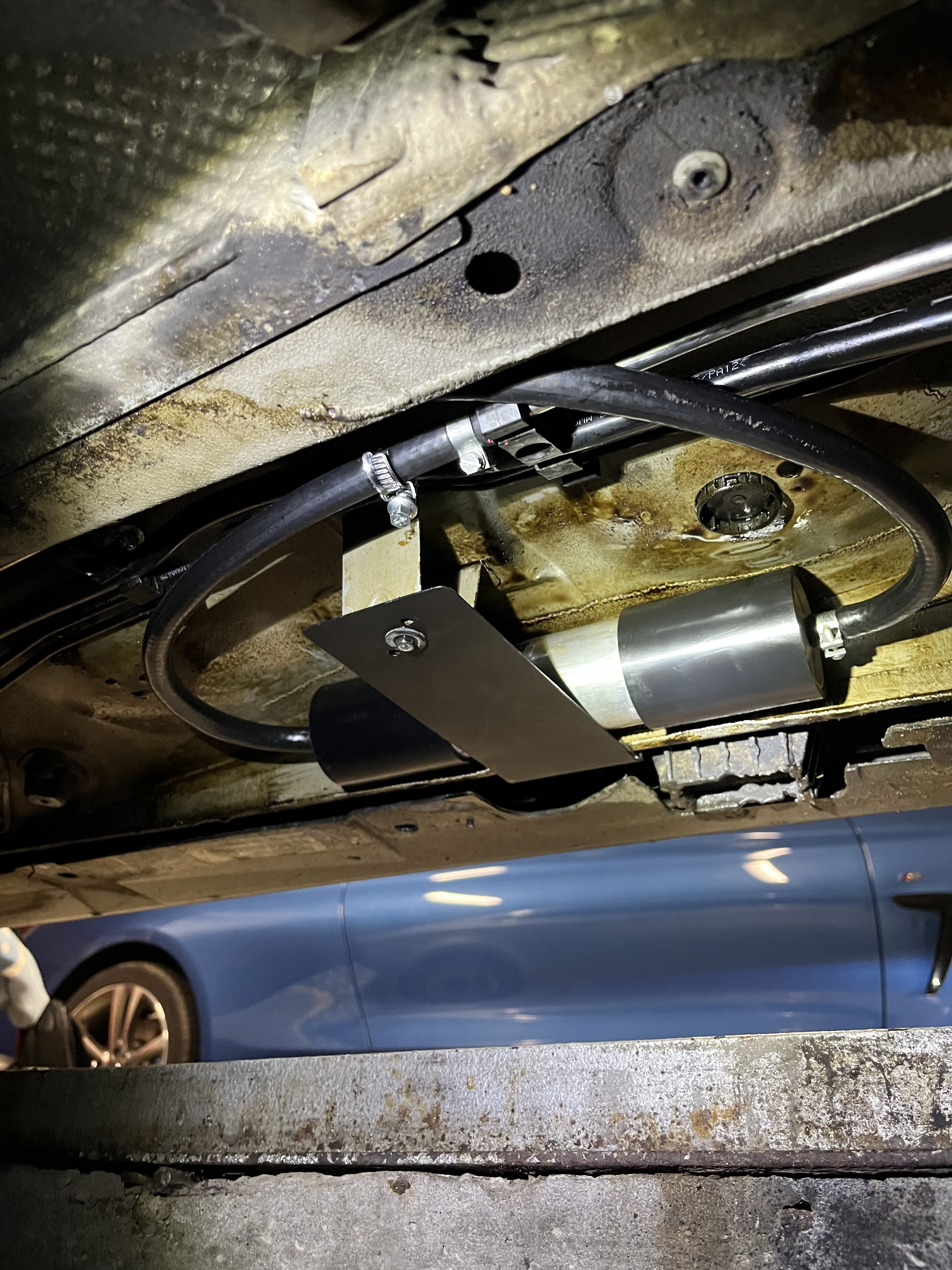

Recently installed e36 m3 inline filter on my 2008 dct e92 m3.
Have done 4-5 tanks now with some spirited backroad driving and with some high rpm winter fun.
Have not yet checked the fuel pressure or condition of spark plugs but overall cant see, feel or hear anything different - will update in few months when the weather is warm and track is dry.
As the filter is located before the fuel pressure sensor i doubt that there are any issues. Seems like the Chinese market e9x m3 has same kind of filter in same location.
Also was not feeling confident about installing fuel filter right above the veeery hot exhaust manifolds.
In total ~5cm of the original fuel line was cut off so that the original fuel line holder brackets can still be used. Also after cutting the line its not hard to clean lines from debris - can access the line from engine side and from tank side can just turn the ignition on and fuel pump blows the remaining debris out. Also flanged the fuel lines - that required hydraulic flange tool .. PITA.
Made simple aluminium bracket - didnt want to cut holes into the cars frame so used the original underside panel holder hole for one side (underside panel didnt have hole for it) and other is just aluminium sheet turned into U shape, added some rubber protection for the aluminium bracket and also fuel filter so there will be no metal to metal contact. The filter is fixed and super solid - no movement at all and with underside panel on cant see anything.
Todo: 3d printed bracket for fuel filter, replace rubber fuel line with braided and use AN fittings? or something more solid - nothing leaking but before going to track just want to be sure.
- does anyone have picture from underside of the Chinese markets car? There is probably part number for the original bracket
Sorry for ugly pics - car is extensively covered and filled with Dinitrol ML.

Great move!
Only observation I could make is: those "bolt/nut" style hose clamps (not the worm type, the other one).
You should inspect it often, because when I used it here, it tended to get loose overtime and begin dripping. Don't know why. It even disconnected the hose once :lol:. I ended up moving to PTFE AN Fittings. I could make a video of how to install the fitting in the hose if you want.
But I don't see a risk there because it's far from exhaust and you'll feel the smell before it gets severe.
