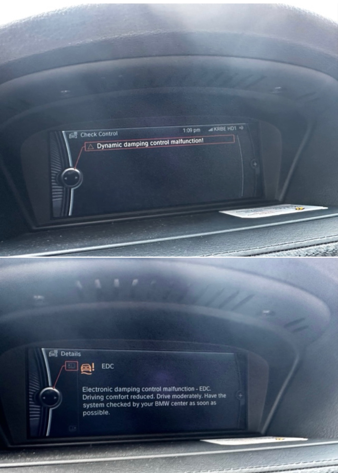

EDC malfunction on and off. Not sure if any of you have seen this. The EDC module
goes into failsafe mode and car starts to become bouncy. Turn engine off and wait a couple minutes, then message goes away and shocks are not bouncy anymore. This only started happening after installing the tractive system.
Otherwise the shocks work great.
