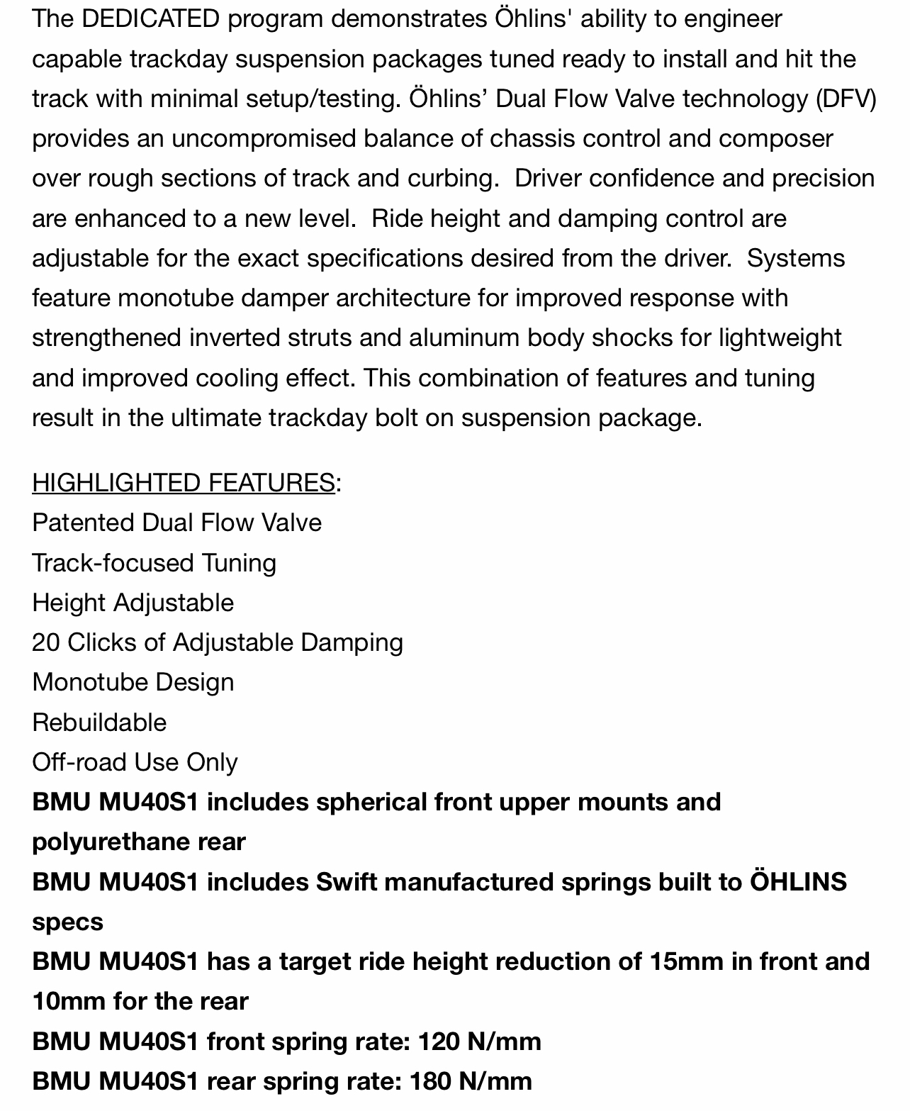

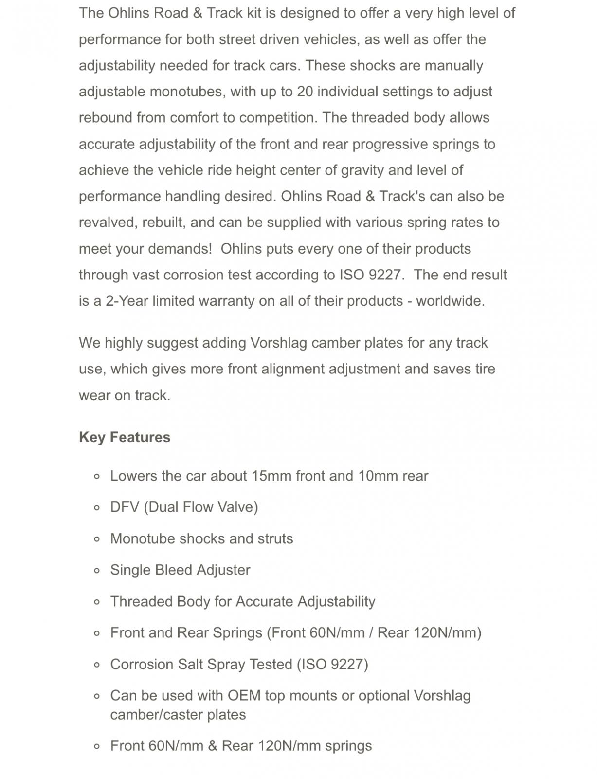

How would you guys compare this kit to the Ohlins dedicated track?

The R&T is a different damper than the Dedicated Track, thats why I'm curious.
R&T dedicated track is the same physical damper with different valving and spring rates. It’s still based on a street-biased damper that’s been setup for more track use. Ohlins TTX/ILX are a better comparison with Nitron products.
The dedicated track has double the front spring rate and a 50% increase in rear rate over the standard street-track kit. Valving is modified to handle the higher rates and that’s it. The Ohlins website even states the dedicated track kit has “track-focused tuning” but it’s still based on the DFV technology. Below are the marketing info for standard and dedicated track kits.

No. Dampers are identical, only valved differently. If you’re upgrading for track use then I’d recommend the R1 (conventional or the soon to be released elec-TRON R1) over the Ohlins R&T dedicated track setup.
