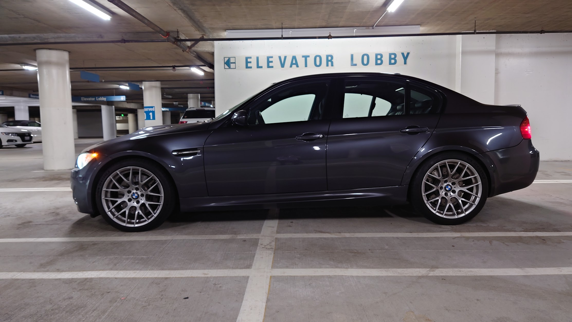

I have had B6 EDC paired with Swift Spec R springs for quite a few years. They work and feel great for NYC area driving, as well as hitting the interstate.

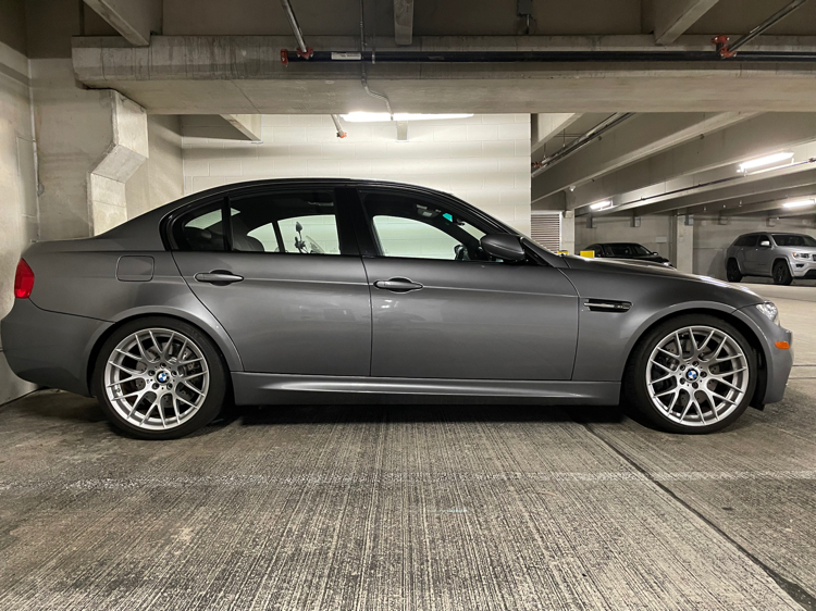

I run the B6 EDC+Eibach and I like it. I shaved the front strut mounts 8mm (similar to Dinan) just make sure there's enough strut travel but probably not necessary. If you go this route though, just know that ride height will be taller than OEM shocks+Eibach.

B6 EDC + Eibach = 2 finger gap up front. Sorry, I don't have an actual measurement. And B4 shocks would probably be a downgrade to OEM shocks. Go for B6 or B8.
Ah okay, and you're also running the leveling shock adapters in the rear as well, ya?
Yes, OEM spring adapters in the back. Raises the rear maybe 1/4". I'm probably sitting almost at competition pkg ride height.

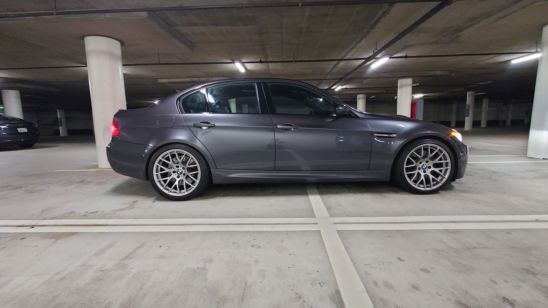

chutak's user avatarchutak You are a life saver. Big thanks on sharing your experience using the rear spring spacer cup. I'm running the Bilstein B6's and this helped fix the rear being a tad low. Here's my E90 M3 with B6 shocks/Eibach springs + 15mm spacers on both front & rear.
