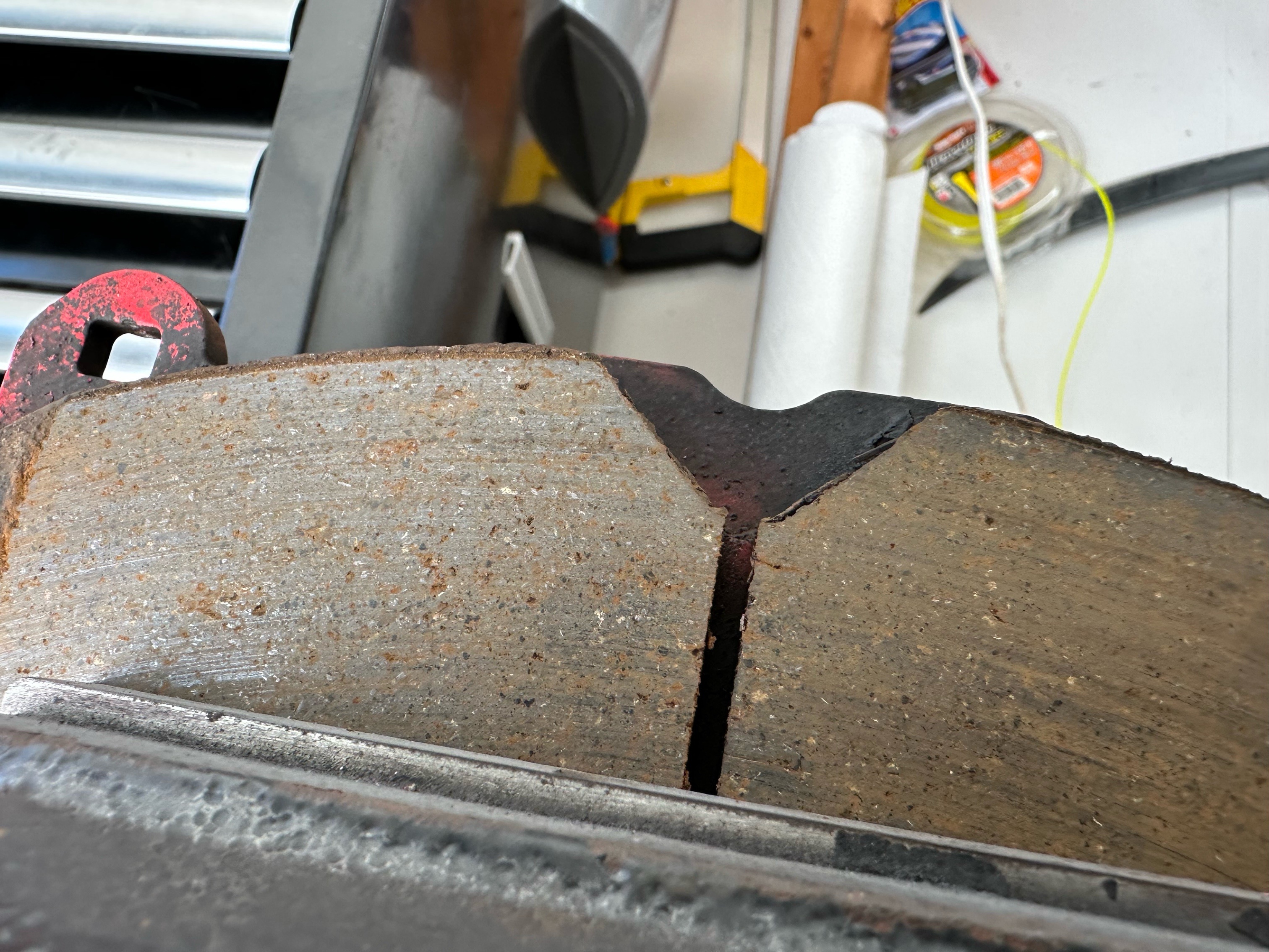

I have the freaky bracket, Alfa caliper, and oem bmw 360 rotors. I use d1666 red stuff pads for full sweep. There is a very small fitment / alignment issue with the freaky bracket. It leaves a small (1-2mm) lip on the top of the pads leading to some rotor shudder after a few thousand miles. I just sand it off when I rotate tires. Other than that they work fine. I have f8x on the rear.
See pic of the lip. If I had to do it over, I would have waited for a complete used stoptech kit.

Have you tired the smaller D1116 stock alfa pad size? Will leave a rust ring, but perhaps not give you a shutter issue if it's caused by the over sized pad.
FYI shudder issues are also common on stoptech brakes, so i wouldn't assume you'd be immune to them.
The lip on the brake pad would be the same on d1116 pads too. The pad itself is the same just longer on d1666. The freaky bracket hole location is off by 1-2mm causing the whole caliper to sit inwards on the rotor causing the pad lip.

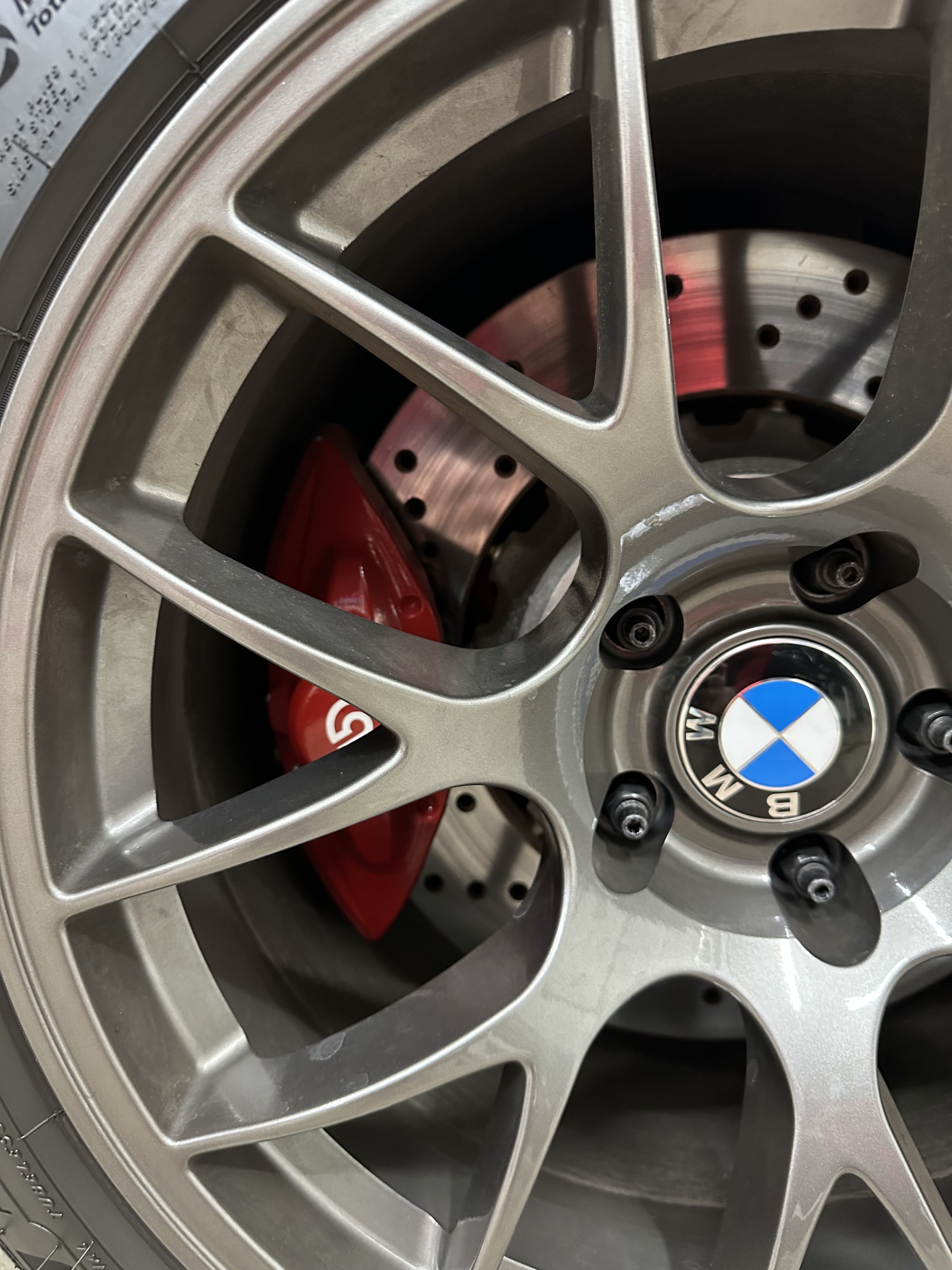

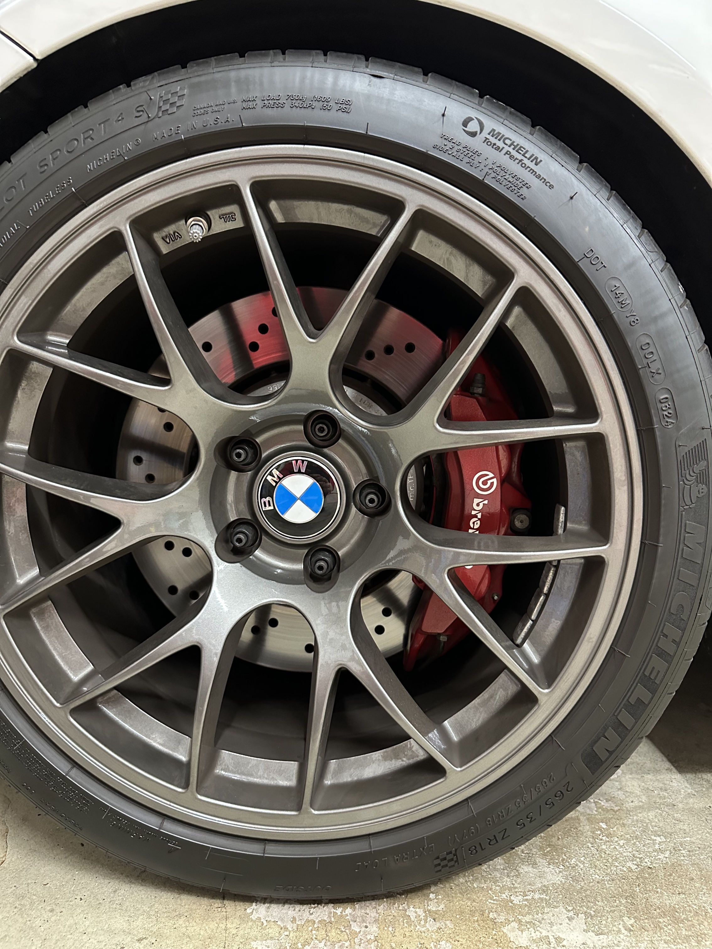

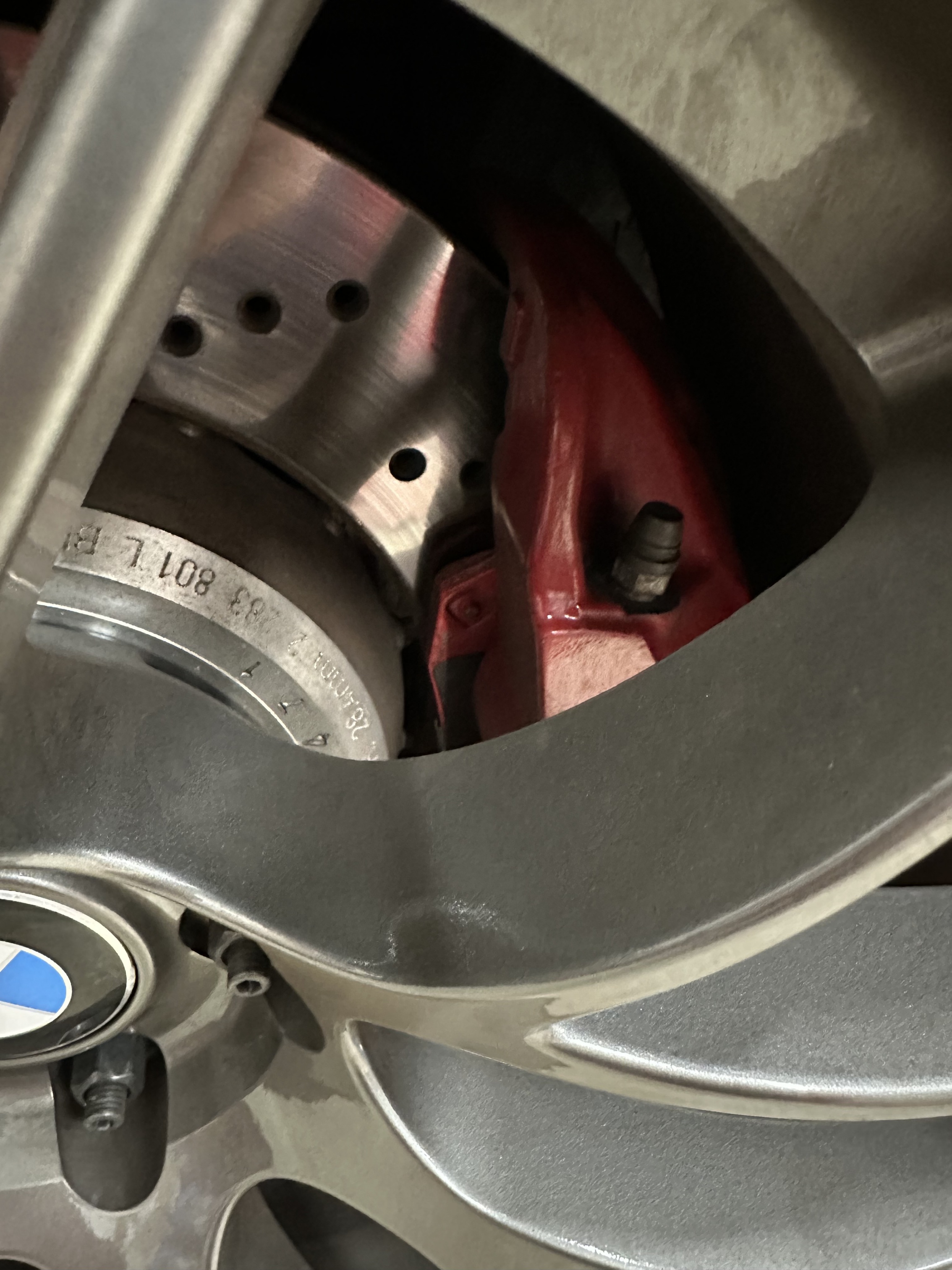

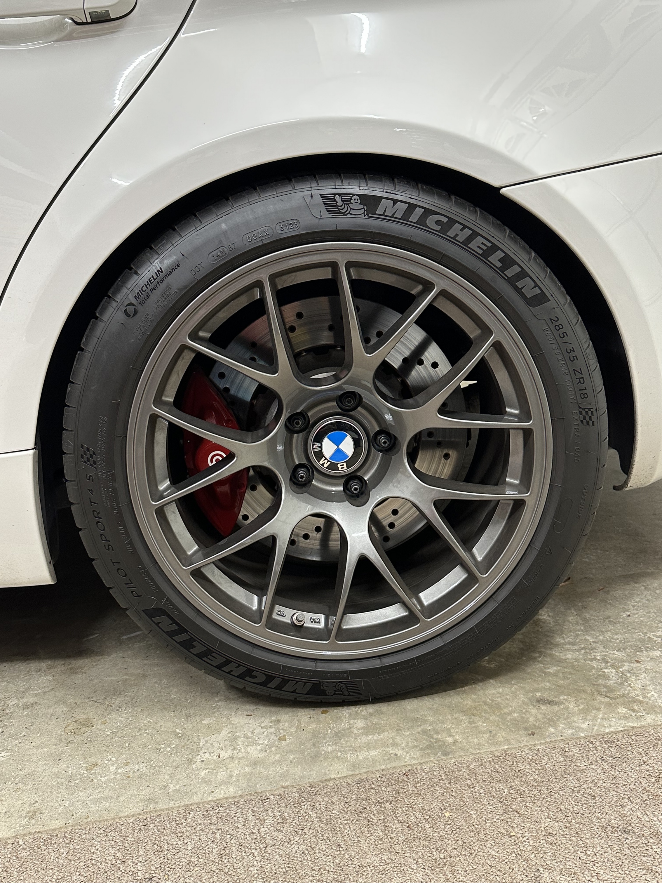

A few pictures as is today.
