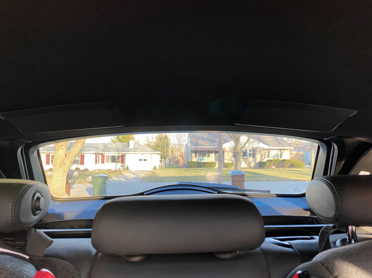

A question about the pano roof: did you swap the whole unit or just the roller shade part?
That is, if I want a black (anthracite) headliner in my E91, do I just need to get the headliner re-upholstered and swap the roller shade from an E84 with a black headliner?

eljay wroteThe sunshade panels comes out, you have to pull the glass out to get to it but it's doable. I had the full headliner and panels reupholster at a shop. Funny you ask about this, I just a few minutes ago had all the pieces out to finally install the individual roof speakers. Holy fuck did it absolutely complete the sound system. I am so happy with it!A question about the pano roof: did you swap the whole unit or just the roller shade part?
I don't see the roller shade as a separate part number.

The glass coming out bit is not what I was hoping to hear.
But it gives me an idea. Thanks!

eljay wroteIt's 4 torx screws and they pop right out. Then it's 8 more small pan screws and 4 spring clips between the frame rail and sunshade.The glass coming out bit is not what I was hoping to hear.But it gives me an idea. Thanks!

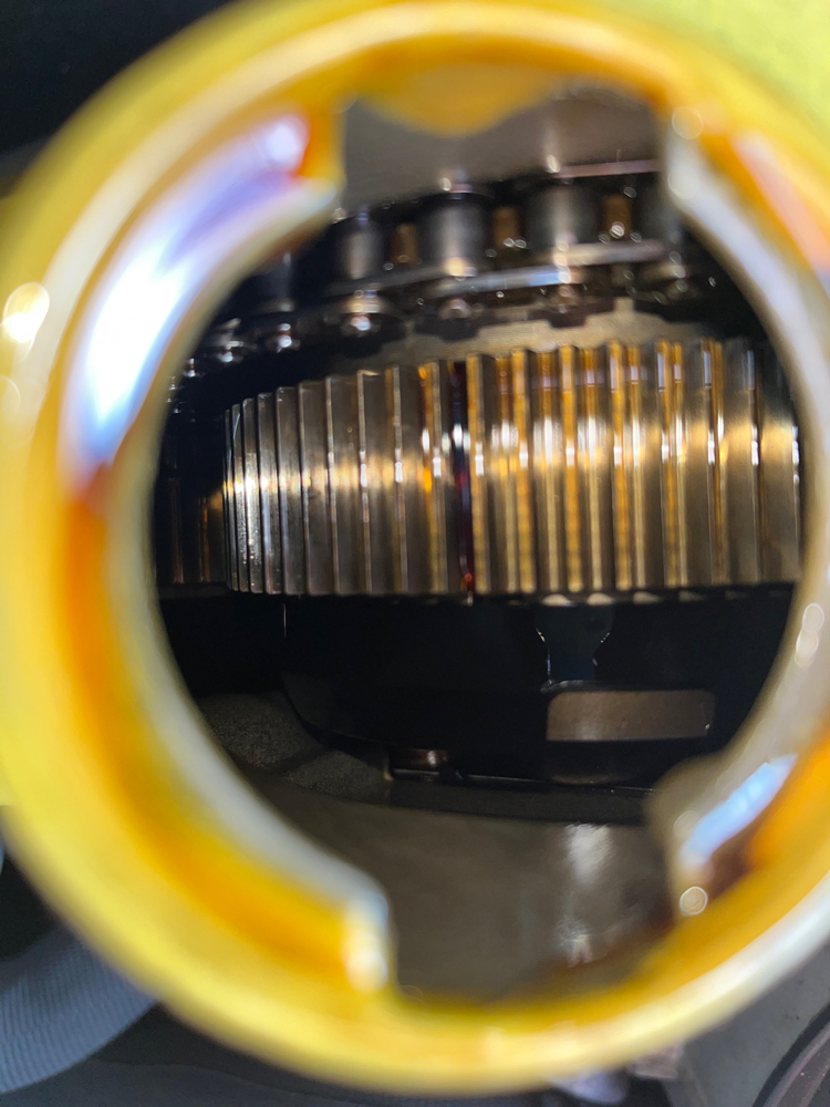

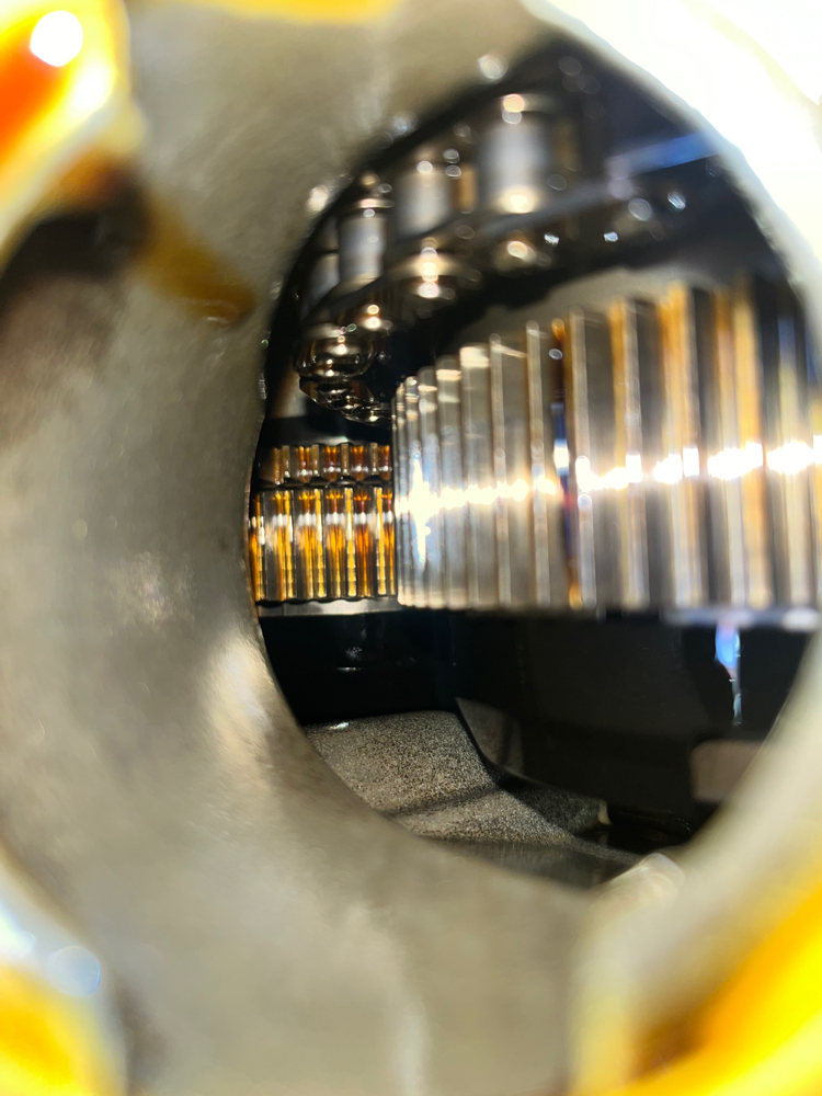

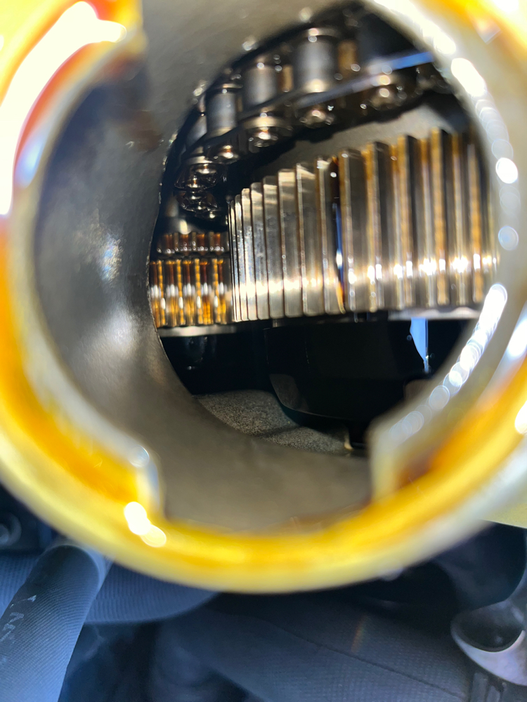

BlueM3Wagon wroteStunning built OP! Couldn't help notice a vanos cap was rotated/on its way off on the open valve pic. Maybe I missed the fixing later in the thread, or left it be?More M fitting
Ps. Curious as currently sorting the same thing on mine.
Helmsman wroteI actually never noticed that in the photo, but I just went out and rotated the engine looking at the caps through the oil cap hole and it's all flush now. I can askBlueM3Wagon wroteStunning built OP! Couldn't help notice a vanos cap was rotated/on its way off on the open valve pic. Maybe I missed the fixing later in the thread, or left it be?More M fitting
BlueM3Wagon wroteYeah looks fine here, but clearly rotated on your old picture. Guess someone pulled them in place. Mine been done today, will get back with more info next week in the "vanos by Slonik" thread.I actually never noticed that in the photo, but I just went out and rotated the engine looking at the caps through the oil cap hole and it's all flush now. I can askmad1stgen if he did anything specific to it?
