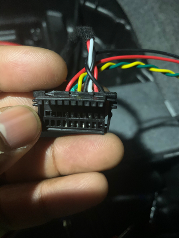

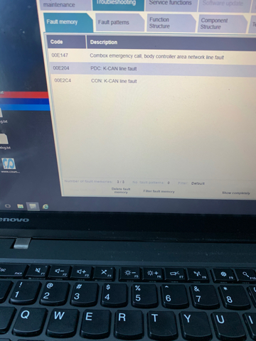

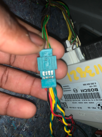

BFZ4M wroteI just ordered a the oem wiring harness since I'munrulyteach wroteNo, not yet. Trying to learn more about coding modules before I get started.Hav u started ur install yet?
Getting k-can faults
unrulyteach wroteMaybe the fuse is blown for PDC? While you grab power for TRSVC.Ok install jbe m today and I'm still having the same issue, Pdc is not communicating with car with i borrow power and can h/l from it to power tr module. Is it a possibility that Pdc can't supply power or can h/l for tr module?
Before I installed all correctly, for testing I grab power from Combox and can from PDC.
When you disconnect the TRSVC, the PDC is working?
Dubstar wroteYes when i unplugged trsvc and return oem wires to pdc. Pdc works as it should. I just ordered oem wiring harness to see if that fixes the issue if it doesn't then I'll be stuck. This last time when. I connected the wires and scanned with ista p it showed up yellow and not red so i made progress. The code i got was a k can. Oh btw the doesn't recognize trsvc at all it doesn't show up in ista or inpawunrulyteach wroteMaybe the fuse is blown for PDC? While you grab power for TRSVC.Ok install jbe m today and I'm still having the same issue, Pdc is not communicating with car with i borrow power and can h/l from it to power tr module. Is it a possibility that Pdc can't supply power or can h/l for tr module?

unrulyteach wroteDid you properly VIN flash the JBE3 and default code for your car?Ok install jbe m today and I'm still having the same issue, Pdc is not communicating with car with i borrow power and can h/l from it to power tr module. Is it a possibility that Pdc can't supply power or can h/l for tr module?
BFZ4M wrotei can remotely code everything u need!No, not yet. Trying to learn more about coding modules before I get started.
SaNGRia wroteI updated jbe with winkfp and default code jbe not the whole carunrulyteach wroteDid you properly VIN flash the JBE3 and default code for your car?Ok install jbe m today and I'm still having the same issue, Pdc is not communicating with car with i borrow power and can h/l from it to power tr module. Is it a possibility that Pdc can't supply power or can h/l for tr module?
unrulyteach wroteNo not the whole car. Just the JBE. Well can you communicate all the other modules except the TRSVC?I updated jbe with winkfp and default code jbe not the whole car
If you can not communicate with the TRSVC check the Software No. If it starts with Numbers then it belongs to F series and i also had one and does not work for our cars! If it starts with Letter (A,B,D) that belongs to E series which is fine. LMK!
F series :
E series :
SaNGRia wroteMine starts with numbersunrulyteach wroteNo not the whole car. Just the JBE. Well can you communicate all the other modules except the TRSVC?I updated jbe with winkfp and default code jbe not the whole car
F series :
E series :
unrulyteach wroteWrong part. That belongs to F series and F series uses 500kb vs E series uses 100kb on KDCAN. Just like the F series CIC cant fit on E series! So i warned couple of Ebay sellers who put a title like X1 E9X on a F series TRSVC but cant correct everyone. You need to get E series!Mine starts with numbers
+ I tried to Expert Flash the TRSVC with X1 files using the winkfp But since i couldnt communicate , i couldnt flash it.
SaNGRia wroteEven if it came from a e series x6unrulyteach wroteWrong part. That belongs to F series and F series uses 500mb vs E series uses 100mb on KDCAN. So i warned couple of Ebay sellers who put a title like X1 E9X on a F series TRSVC but cant correct everyone. You need to get E series!Mine starts with numbers
unrulyteach wroteSend me the VIN no. Let's see what E series X6 came from! All E70/E71 TRSVCs came with Side View or Top view options there is No single Fakra E70/E71 TRSVC in the states!Even if it came from a e series x6
SaNGRia wroteThat sounds right. Got a link to any reasonable oneunrulyteach wroteSend me the VIN no. Let's see what E series X6 came from! All E70/E71 TRSVCs came with Side View or Top view options there is No single Fakra E70/E71 TRSVC in the states!Even if it came from a e series x6
You can get this one. You will see top view camera error on ISTA but will work without an issue. Later on you can activate the top view , if you find the camera with harness!
SaNGRia wroteI might just take you up on that offer!i can remotely code everything u need!
SaNGRia wroteOrdered this should get here before oem harness so i will test it with the harness i currently hav i appreciate itYou can get this one. You will see top view camera error on ISTA but will work without an issue. Later on you can activate the top view , if you find the camera with harness!
BFZ4M wroteWhenever you are ready let me know 👍🏻I might just take you up on that offer!

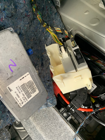

unrulyteach wrotehey there, I installed the trsv below the combox/media bracket with a nut and secure it with a zip tie.Where did u install trsvc module?
I don't have more pictures of the oem camera and the chinese handle, but I had to dremel a lot of the inside where the chinese camera was to make room for the bulky oem camera.
The end result looked very similar to Sangria's camera fitment.
That's about right. Great job!
chuzo wrotehey there, I installed the trsv below the combox/media bracket with a nut and secure it with a zip tie.
Still getting the same results as i did with f series trsvc module
unrulyteach wroteTried to change the CAN bus cable on TRSVC? Maybe it's wrong..Still getting the same results as i did with f series trsvc module
