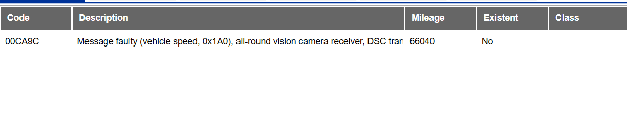

I'm getting fault code 00CA9C. I have already performed the camera calibration/training using INPA, and the camera appears to be working correctly. In real-world operation I can see the dynamic lines, and the steering wheel angle is being recognized properly (the lines move as expected when turning the wheel).
The strange thing is that the 00CA9C fault remains stored and cannot be cleared, even though the camera functions seem to be working normally.
Has anyone experienced this before or knows what could be causing the fault to persist despite a successful calibration?
Any suggestions would be greatly appreciated.

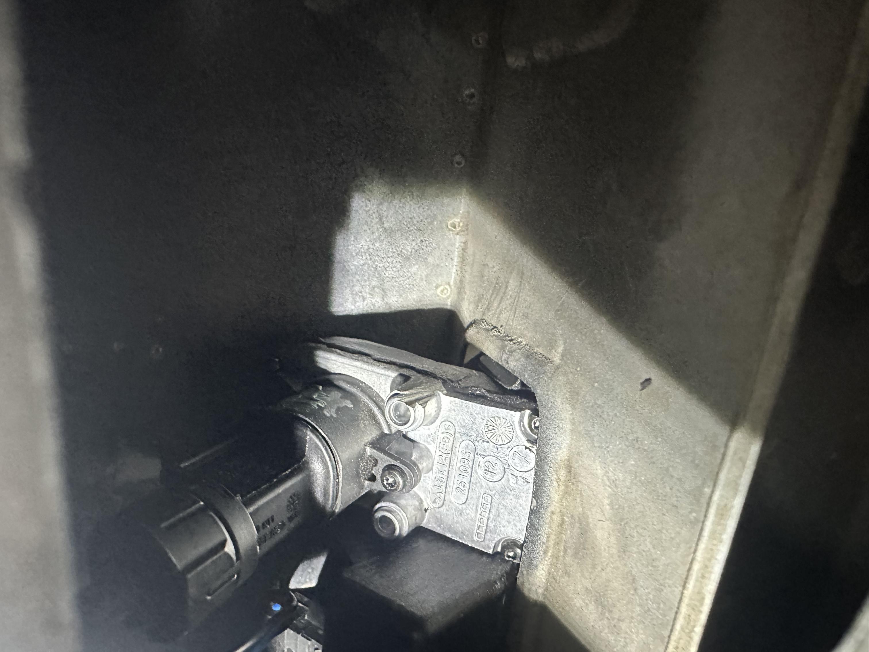

After you have successfully connected the FBAS cables, run this cable all the way to the trunk. In my case because I own E93, the PDC is behind the rear seat. So I run the cable there.
Then make a Y cable from PDC power and Ground and attach that to TRSVC cables Positive (Pin 7) and Negative (Pin 1).
Then use the Can cables on PDC module. Attach the TRSVC CANBUS cables tightly using the M connector that comes with the kit. And you are done with the TRSVC cable installation.
For people who owns e90 and e92 use combox bracket on the trunk to install the TRSVC other side of the bracket and install it back its place.

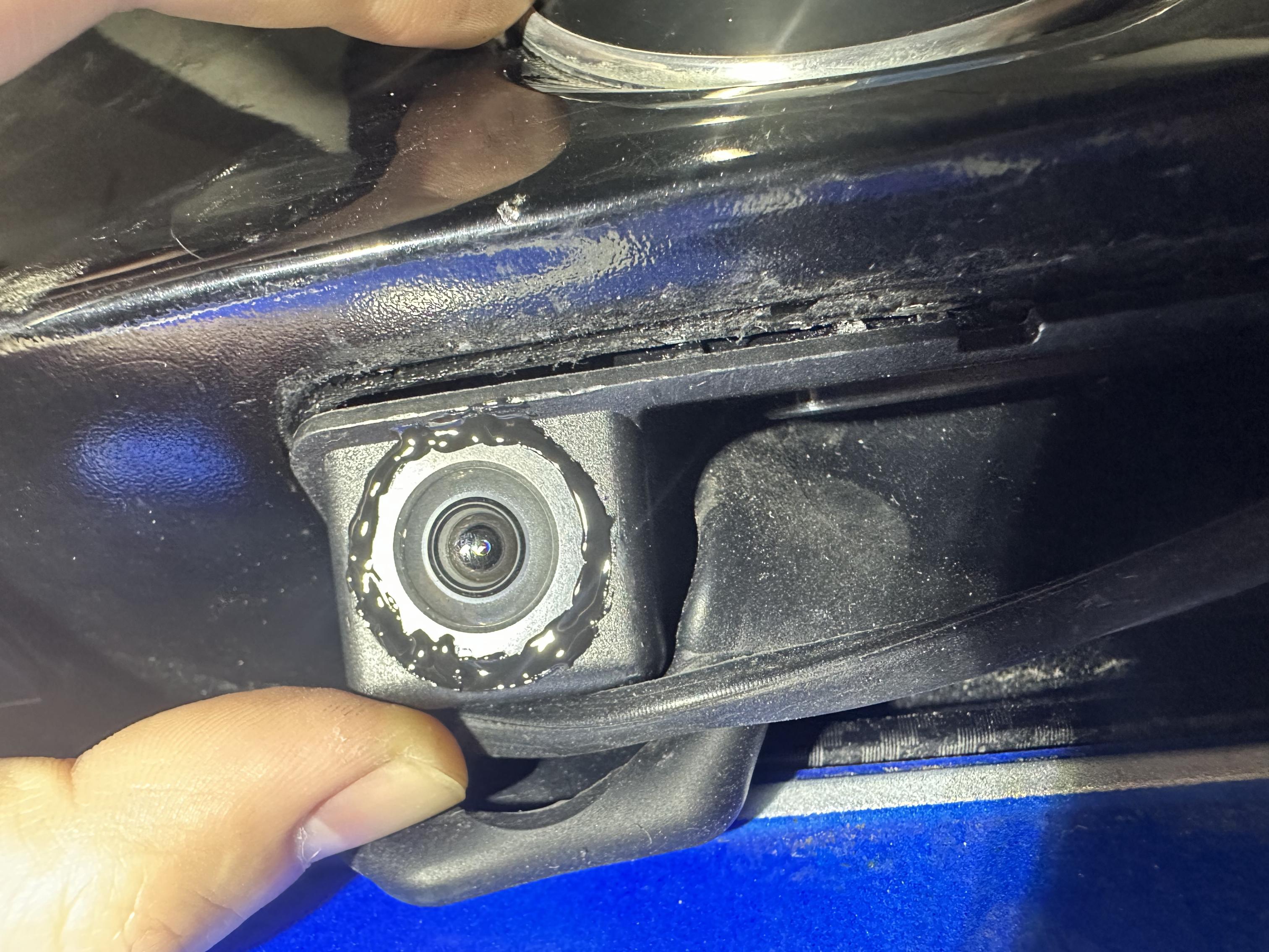

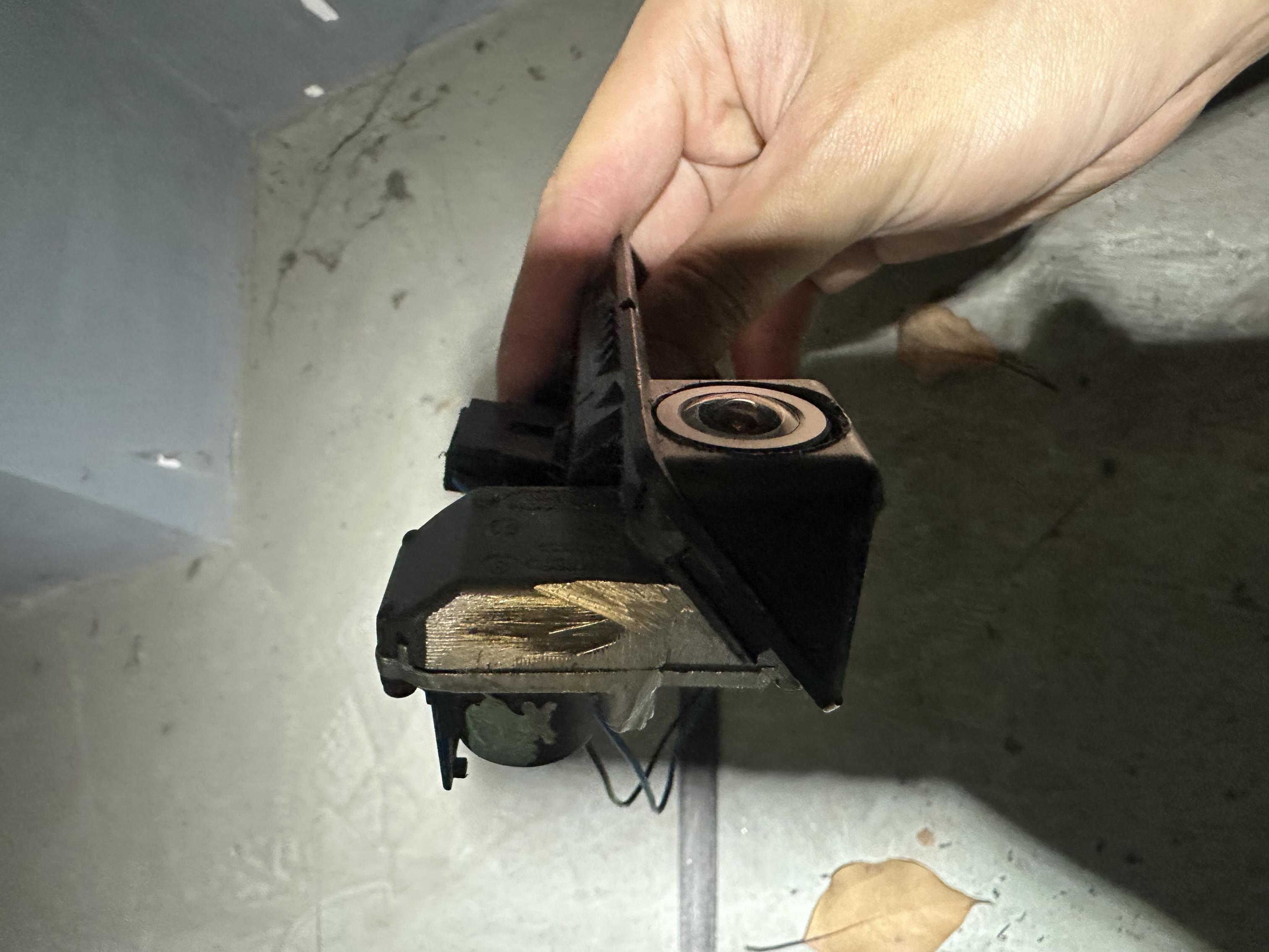

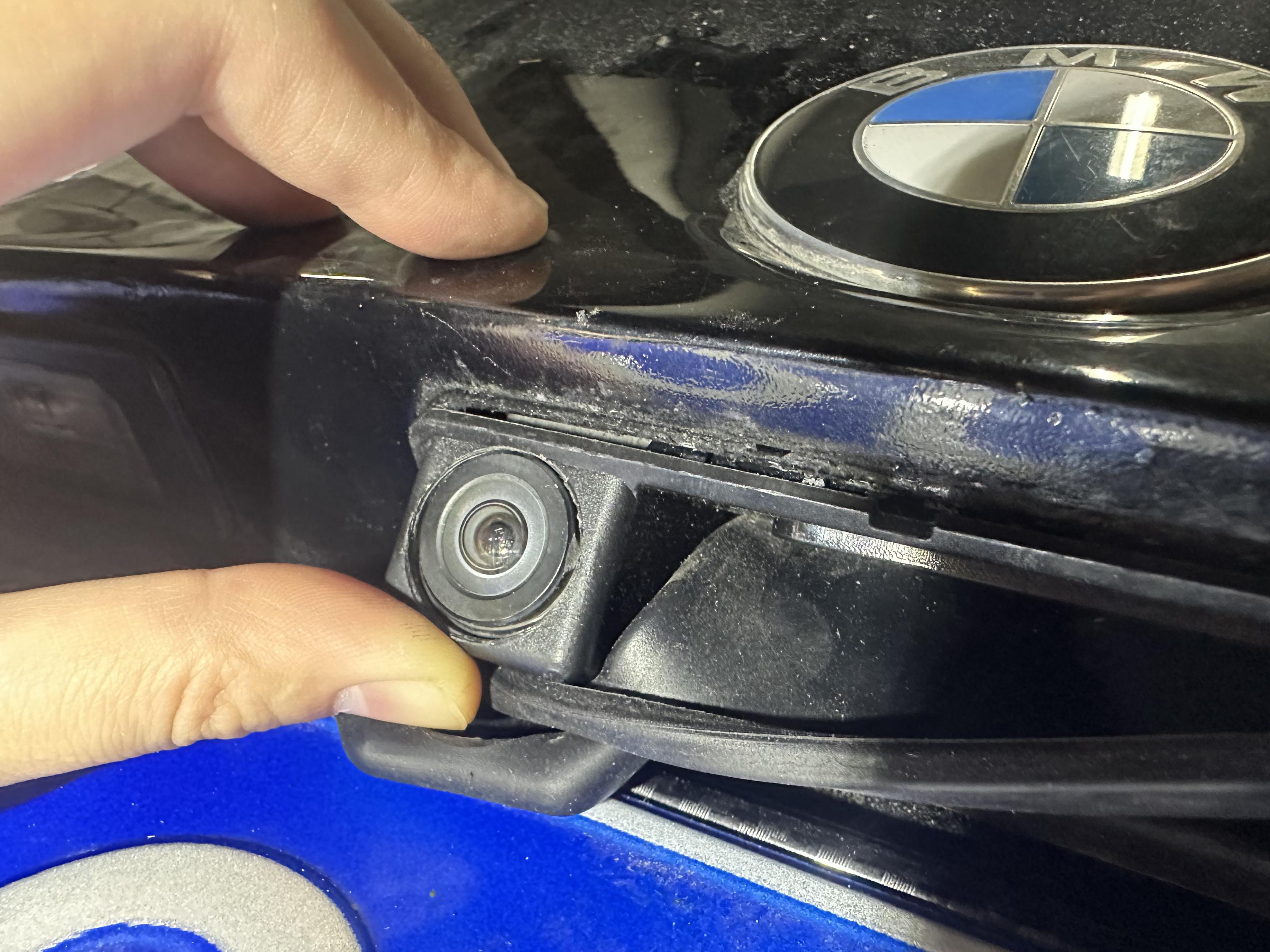

Trunk Handle Installation :

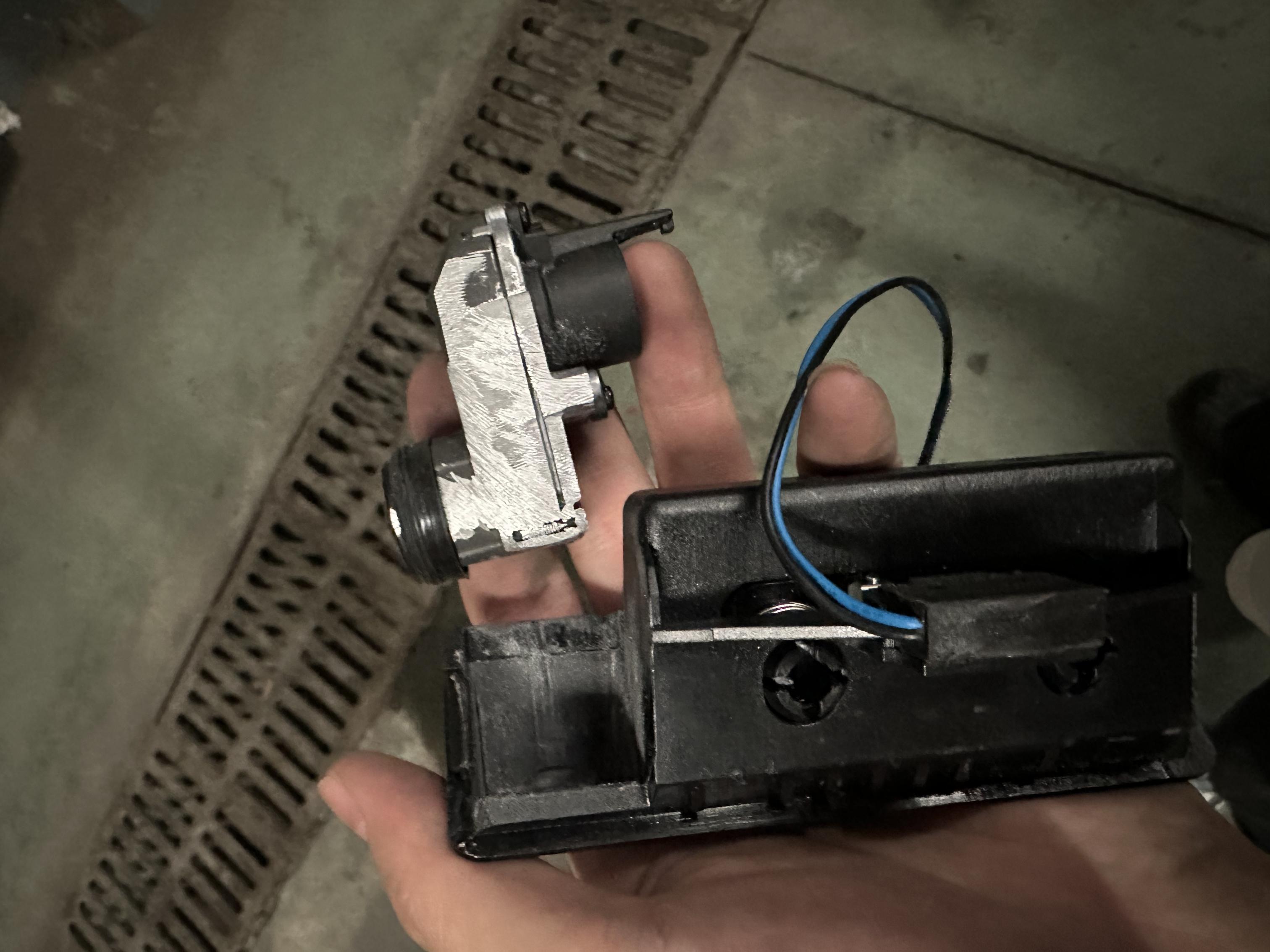

I have seen couple of OEM retrofits but they were cutting the trunk to fit F series trunk handle and I was little upset with that since I don't like to cut my car for even OEM retrofit. I decided to do something different which worked amazing.
I already had my Chinese handle from my Chinese retrofit. I have remove the camera that was on the handle. And tried to install the OEM camera on that tiny place which did not work at the first time
Then I did this :
Just a little note here. After installing the camera, please use a clear silicone (waterproof) and put all around the camera, just make sure it will not over run from the 19mm camera hole. And then let it sit for a day. And use the silicone cover that comes with the Chinese handle to hide your imperfections. Thats it.
The tricky part is because the oem camera has a humangous back part, it is really not too easy to install the handle like Chinese one. So you need to first make sure HSD cable comes out like this :
The position of the HSD cable really important. If that cable comes from the bottom of the trunk it will not clear and wont fit. There is tiny square hole in the trunk and you have to feed this cable from there. I did not take a picture of this hole but you wont miss it. After the cable properly installed attach to the camera. Also do not forget to attach trunk handle power cable.
And other tricky part is do not try to install the handle straight like you would do on Chinese handle. Put the handle 90 degree where the camera part down and the other side is up. Insert the camera's back first then start tilting. You will start feeling at this point. I suggest you to use your other hand from the inside of the trunk. Reach to the Hsd connector with your fingers to adjust the camera while you are adjusting the handle with your other hand. I was able to do it in 10 min. And it fit perfectly fine. But wasn't too easy. When you also want to remove the handle you need to use your other hand to grab HSD connector from inside. But I don't think this camera will fail anytime soon. They are top notch quality comparing to Chinese ones.
Another Trick will be installing the HSD cable to your trunk. Many people cut their cable to fit their HSD cable at this narrow rubber tube. I did something better so no need to cut your cable.
The oem wiring harness comes with Ground Point in the middle . I bent this part and tape it before running in to the tube.

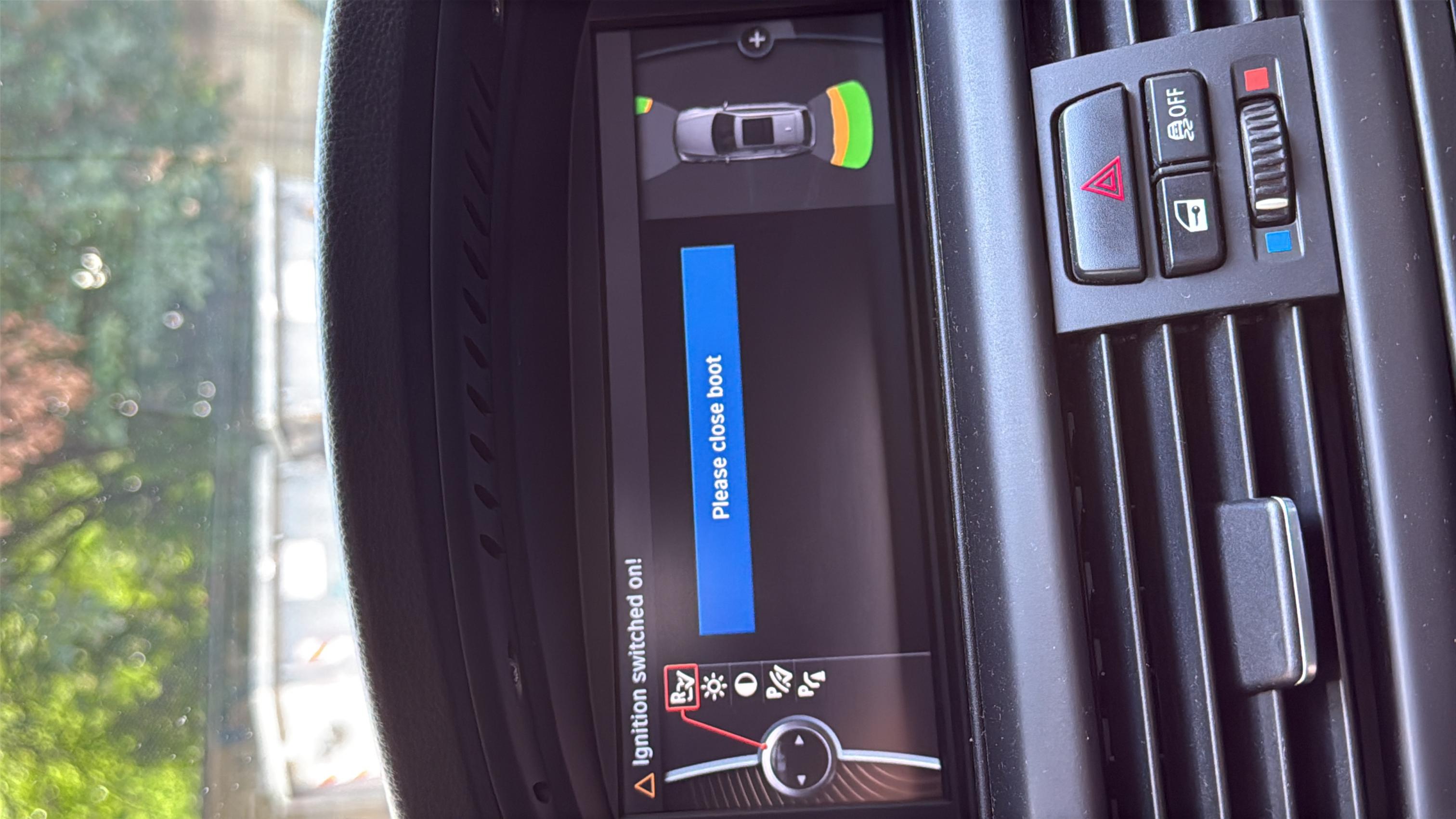

Once you have done installing the PDC and TRSVC properly, grab your laptop. Open the NCSExpert. Do not forget to copy files that I attached here. After copying this files in place Turn on your ignition but no need to start the car. (PDC module only works when ignition is on, because of the Y cable TRSVC also turns on when the ignition is on) read the PDC file and default code it. And switch your gear to reverse. You should be all set.

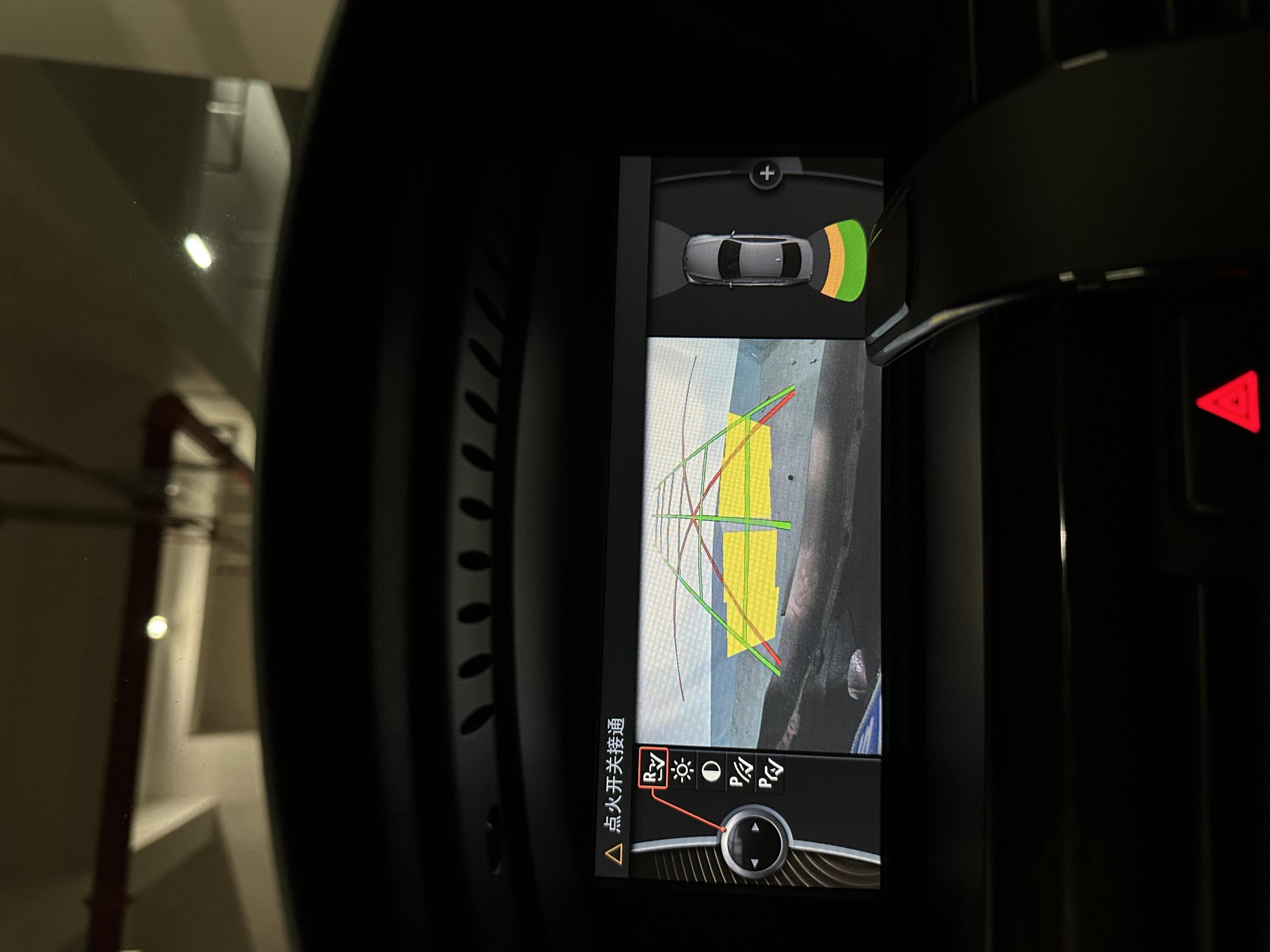

And here is the pictures :
For the E93 series like me please make sure your HSD cable runs correctly. I made couple of tests before install in place (I had experienced from Chinese Kit Thank God. And the Original cable was too tight so causes an issue at the very first time. Then I corrected it) :

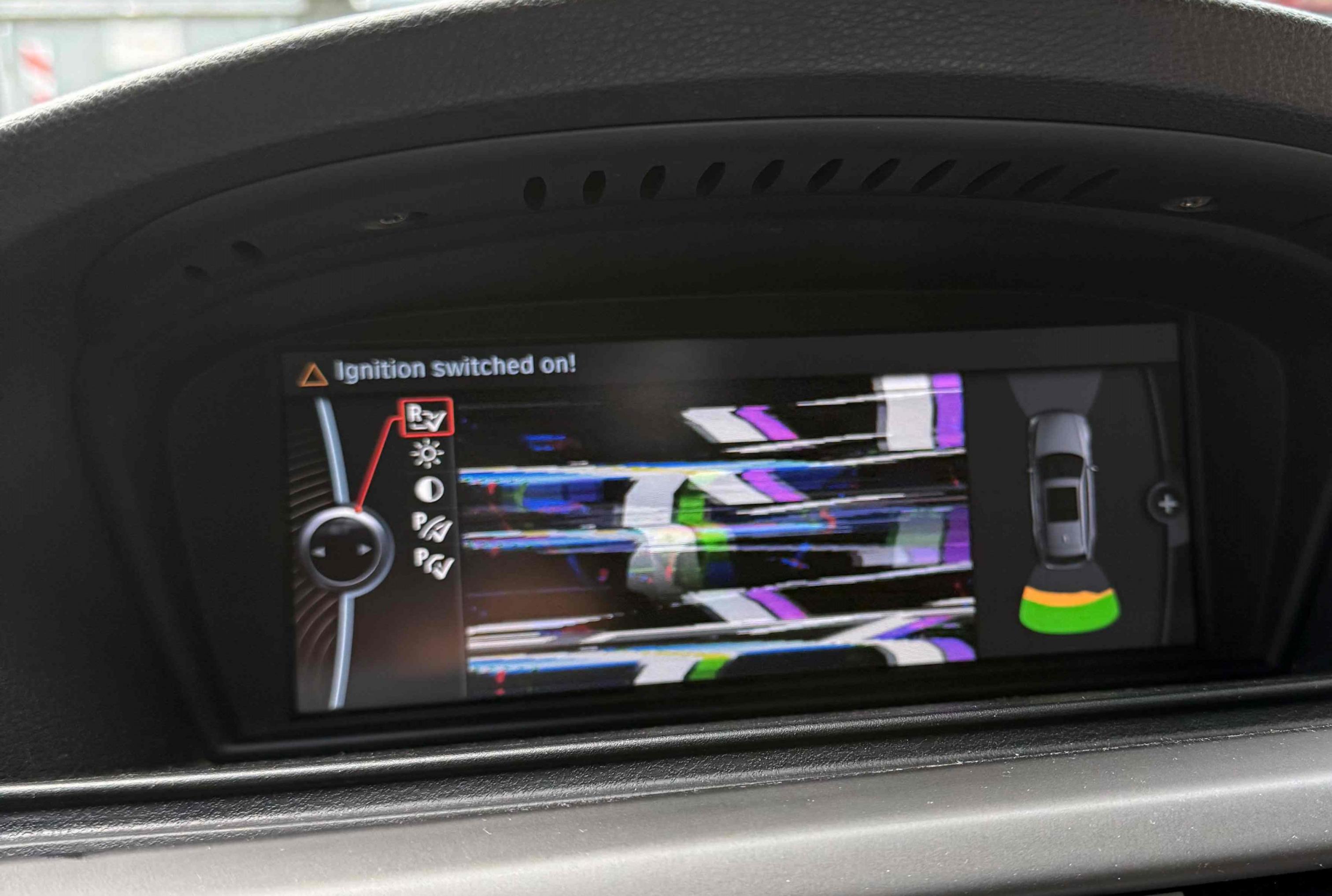

NOTE : At the end I had a very strange issue, My TRSVC module can not communicate neither on Tool32 nor ISTA. Ista shows the module with 2 error stored, but when I click " Call Up Funtions" ECU can not communicate. Only INPA UIF shows STVR/TEBF Job Status OKAY with the part number 9291385 which is X1 TRSVC. Other than that It works without any issue. I might do e84 SSD file on NCSExpert to see if I can default code it but no need to do anything and not effecting the functionality.
INPA UIF
UPDATE :
I have found the issue why the TRSVC can not be recognized with my system. I have JBBF H3 Junction Box and I need to upgrade this to minimum JBE 3R H2/H3/M in order to communicate with TRSVC :

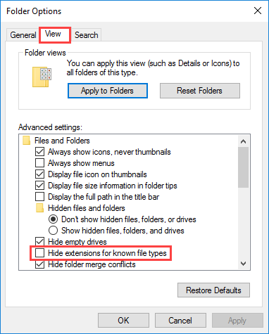

bmwretrocode wroteDid you update the files which is attached on the post?Hello friends, I’ve been gathering information and parts for this retrofit for a long time. I have collected the PDC from a BMW E84, and the TRSVC module along with the camera from an E70, as well as the complete wiring harness. I have already run the camera wiring through the trunk lid and connected the TRSVC module. I tapped into the power and CAN bus connections from the PDC module and added the VO (Vehicle Order) code for the camera. However, when I open NCS Expert, it won't let me perform 'SG_CODIEREN' on it. Please help me
My car is bmw e91 11\2011 in full package
No, because i cant convert it from .txt to .rar
How to do it, or can you send me on mail
milic.miljan98@gmail.com that files, thanks again for help
bmwretrocode wroteIf you do this, you will see the extention and can be edit to rarNo, because i cant convert it from .txt to .rar
