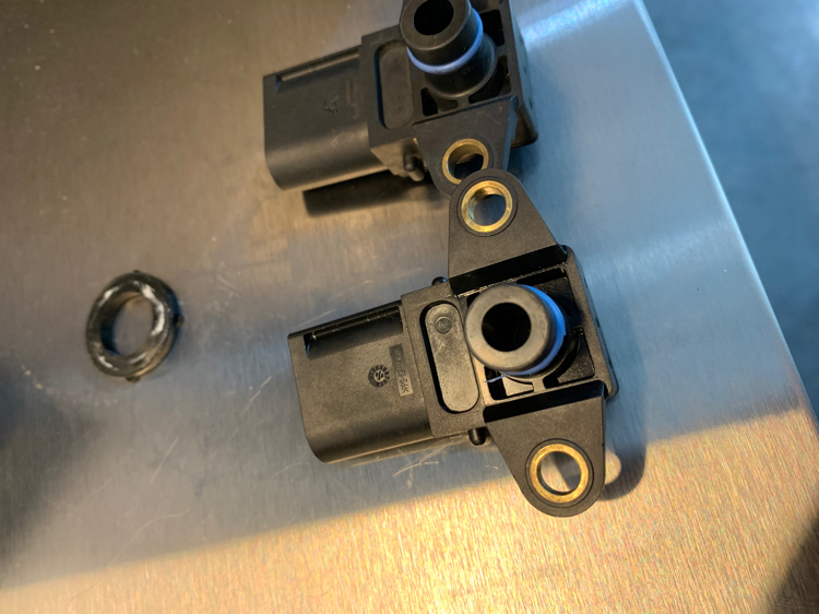

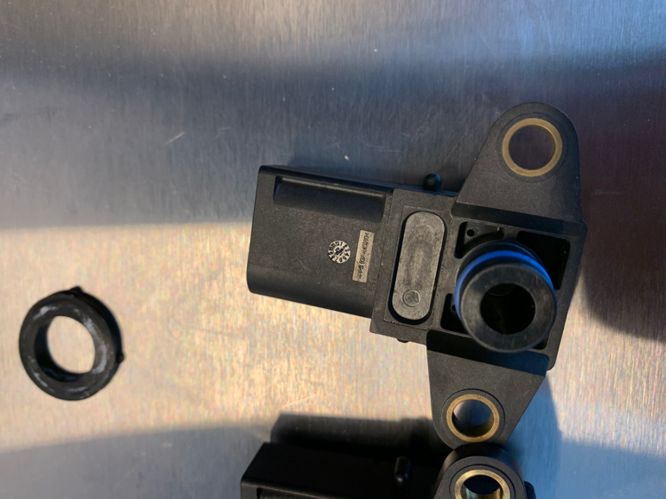

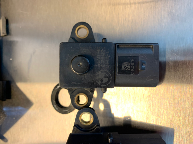

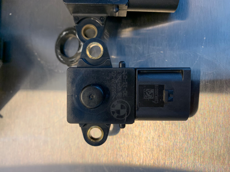

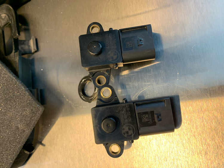

Adding pics of the new sensor (diff pressure sensor). vs the old sensor I took out.
Remote image:
13628657300 pops up as an intake manifold pressure sensor. Its pretty cheap too, like $50.

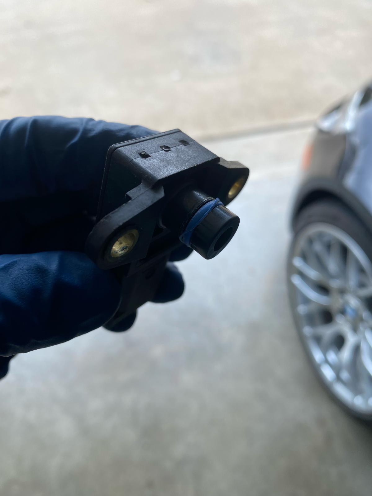

Problem solved, was a jacked oring on the sensor.
Nice find! And how many fingers did it cost to squeeze in and replace it..?
Lol! None, extensions, long pliers, ect… Never put any hands in the abyss.
That blue o-ring on the sensor can get ripped during install or even removal. It might not be the o-ring itself but perhaps the sensor itself causing the code.
I replaced my sensor in 2022 and then in 2023 the sensor and vacuum lines as part of a master cylinder, brake booster, and reservoir refresh. The one year old sensor's o-ring looked about that bad but I didn't have codes.
