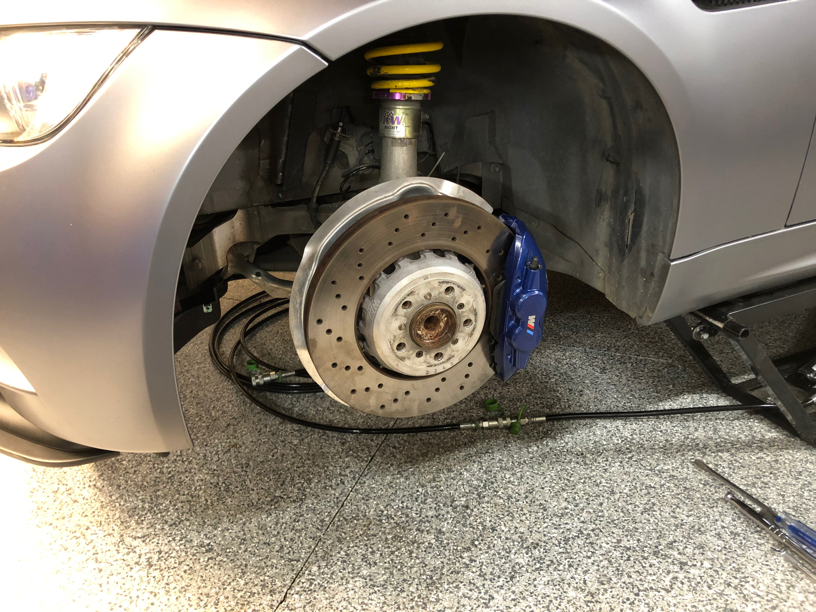

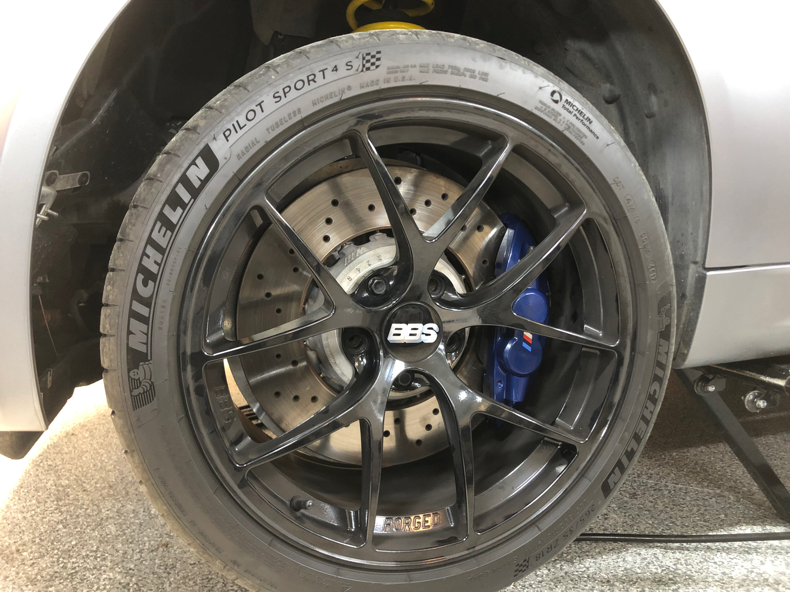

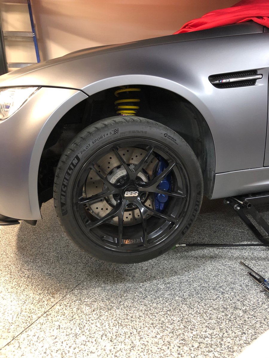

I just began the conversion here. Very straight forward. My biggest dilemma...
Do I change the colour of my caliper?!?!?
FMLYSDN wroteIf you track, you'll want to.I just began the conversion here. Very straight forward. My biggest dilemma...
Big fan of black calipers on the E9X as it's aligned with the GTS and is generation correct.
Are these winter projects or you want on road testing these soon 😃
Epoustouflant wroteNo plans to track this car. That was a former activity. A dedicated track car would be in order. I simply wanted an upgrade to the stock brakes with OEM parts. Mostly a cosmetic upgrade as the stock setup is drab.FMLYSDN wroteIf you track, you'll want to.I just began the conversion here. Very straight forward. My biggest dilemma...

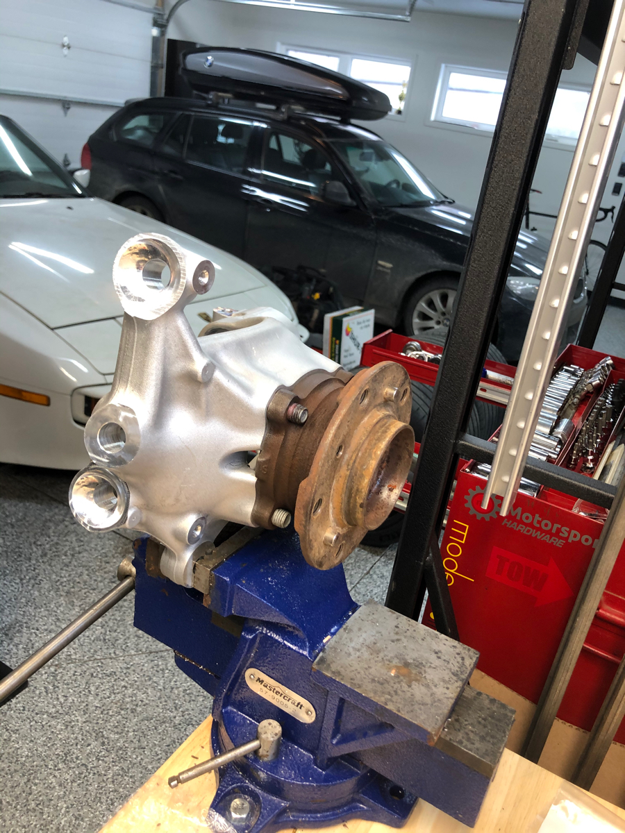

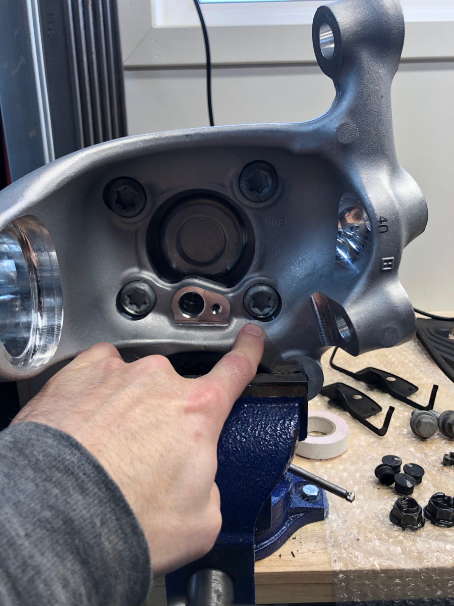

Did you opt for new spindles or did you have a custom bracket made?
Curious to hear total conversion costs.
Epoustouflant wroteI went for the whole meal deal on this one.FMLYSDN wroteLooks great! There are definitely performance & longevity gains I'm sure.Epoustouflant wroteNo plans to track this car. That was a former activity. A dedicated track car would be in order. I simply wanted an upgrade to the stock brakes with OEM parts. Mostly a cosmetic upgrade as the stock setup is drab.FMLYSDN wroteIf you track, you'll want to.I just began the conversion here. Very straight forward. My biggest dilemma...
No road testing till the spring ðŸ˜
Spindles, hardware and F80 ABS sensors...
As for the cost, I'm sure I could tally that up. There's a complete setup including spindles on Ebay right now for $1800 USD.
