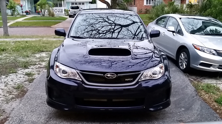

NitroBiz wroteAutogeeks is the way to go IMHO. They have all the products and advice you could want. I got their forum favorite kit a while back and I had nice results. As you said, everyone has their favorite products, mine is Klasse's lineup (their all in one polish is my favorite). Here it is on my old Subaru.Vedubin01 wroteCool! Thank you. I'm starting to believe that everyone is going to say good things about a lot of good products and not one is the very best. I will definitely check out the forum.I just went though a big paint correction and CQuarts coating this past week and used Black Fire products. I used Black Fire One Step with a green pad for light scratches and it worked amazing. Check Auto geeks forums for amazing information on detailing.

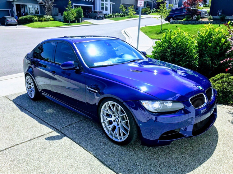

If you want PERFECT paint on an M3 here's the recipe (This of course assumes your car is 10ish years old, never paint corrected before and has the swirls and scratches typical of a car this age): (post decon) Sonax Cutmax with URO MF cutting pad. Buy like 4 of them at one go and don't let them get too hot. Prime each pad at the start, and swap them out after every 2x2 area to let them cool off (make sure you have some compressed air and/or a brush to clean them after they've taken their turn. Run your DA at full speed, 1" per second, 4 passes per 2x2 area. Anything other than a scratch through MOST of the thickness of your clear coat is now gone. You'll have a very slight haze but that'll go away on the next step. Come behind it with a URO black finisher pad and the Perfect Finish. 2" per second, 4 passes. Your car now has brand new looking paint. Perfect Finish is an amazing product, and if you can settle with 80% swirl/scratch removal this one product with TWO step MF pad application (still going for the cutting pad first and the finisher second) will get you that. But if you wont settle for anything but microscopically perfect paint you can't leave out the Cutmax. This is only for the hard BMW and Merc clear (I've done it on both) Don't @ me that this is too aggressive for your J car's soft paint. I already know, I have a Toyota for a DD.
Obv I didn't include the protection part. I use the same Gyeon surface prep, and then because you've done what I consider a ONE TIME paint correction, you're going to want to not screw around on protection. I do Gyeon MOHS. Can't risk having to do this kind of correction again, ya feel?

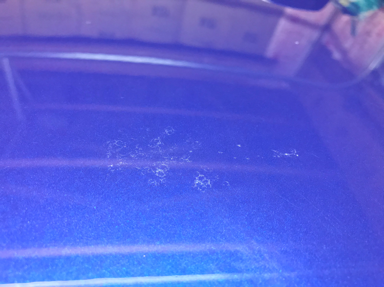

butte2butte wroteSpeaking of clear coat, I have this "cloud" on my roof that my friend seems to think it was bird poop left on there to long from the previous owner.Megs 205 is a very fine product, and was able to sit at the top because Perfect Finish wasn't widely available in the US until a few years ago. Still brand familiarity with Sonax isn't nearly as strong as Megs.

NitroBiz wroteThat looks like bird poo etching in the clear coat. You might be able to compound it out with Meg's 105 or a similar heavy-cut compound. If that doesn't work, wet sanding followed by compounding is the only thing that has worked for me.Speaking of clear coat, I have this "cloud" on my roof that my friend seems to think it was bird poop left on there to long from the previous owner.

I wouldn't know where to start with the wet sanding...could you forward me a link to do that?
NitroBiz wroteFor me, Meg's 105 has been really effective on heavy scratches and swirls using a microfiber pad. It does create a lot of residue dust though.I've heard a lot of people recommend Meguiars #105, is it that good? I ended up going with Griot's two step process when I purchased their G9 and adding their Fast Correcting Cream with white pad.
Here's a good video about wet sanding from Larry at Ammo NYC:
https://www.youtube.com/watch?time_continue=5&v=fgHd1twCHYM&feature=emb_logo
NitroBiz wroteAlways remember to start with the least aggressive method first, though. Your paint and clear only have so much life to them.butte2butte wroteSpeaking of clear coat, I have this "cloud" on my roof that my friend seems to think it was bird poop left on there to long from the previous owner.Megs 205 is a very fine product, and was able to sit at the top because Perfect Finish wasn't widely available in the US until a few years ago. Still brand familiarity with Sonax isn't nearly as strong as Megs.
I was able to remove similar looking bird poo etchings from my wife's car with Sonax Perfect Finish. Try a simple cut polish. If that works - great! If not, then step up to something stronger, and so on.
SoCalRPM wroteGotcha, that is good advice. My current action plan is Griot's Correcting Cream -> Griot's Fast Correcting Cream -> Griot's Finishing Cream -> Griot's Ceramic 3-1 WaxAlways remember to start with the least aggressive method first, though. Your paint and clear only have so much life to them.
BFZ4M wroteSo today I went for it, I bought Griot's most aggressive compound with their micro-fiber pad and when that didn't get it done I tackled the bird poop with 3000 3M sandpaper and wet sanded the affected area. I think I got most of it out and removed but not completely. Other than wet-sanding it again, what would you recommend???For me, Meg's 105 has been really effective on heavy scratches and swirls using a microfiber pad. It does create a lot of residue dust though.
