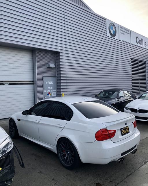

I just had Weatherford (Berkeley) BMW replace the Huper Optik 35% tint with Xpel XR70 (thank you @derbo for the referral!). I’m a fan of light/no tint generally. I had Llumar Air80 on my E46, but did not want the blue hue this time around. This is nearly clear, but has a very slight gray tone to it. I’m very happy with how it turned out.
Xpel options. Their specs are among the best in ceramic tints today.
Before.
After.
Before.
After.

70 is looking goooood
New tint looks so good. I'd like to do something on my car one day but I'm also not a fan of the blacked out windows.
Really liking the new tint. It's nearly clear from straight on, but has some gray (reflection for glare reduction?) from an angle. A lot of money for what would seem like a lateral move or a step back to some, but it really changed the overall look of the car and I'm happy with it.

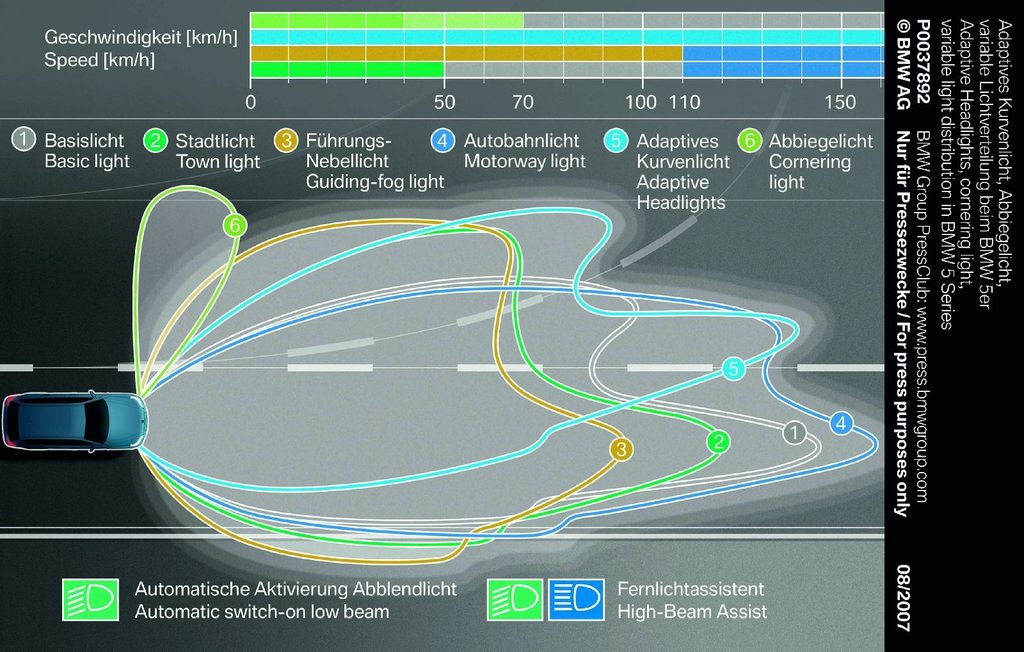

At the same time, Derek performed some wizardry: coded Adaptive Headlights II, and set the DRL/angel eyes to 13.6v. I like the idea of adding beam patterns 2 & 4 to the standard 1 below.
1. Basic: Normal parallel conditions that the US gets.
2. Low speed/City: Driver light aims to the left and both lights slightly lower for better visibility for potholes without blinding folks in the city.
3. Guiding fog light: M3 doesn't have fogs so this doesn't pertain to E9xM.
4. Highway speeds: Headlights stay parallel but aim a little higher for further distance.
5. Adaptive headlights: Headlights following steering wheel input. This is the default for US.
6. Corner lights: This is already enabled for our inner headlight light when we have our turn signals/steering wheel turned at low speeds.

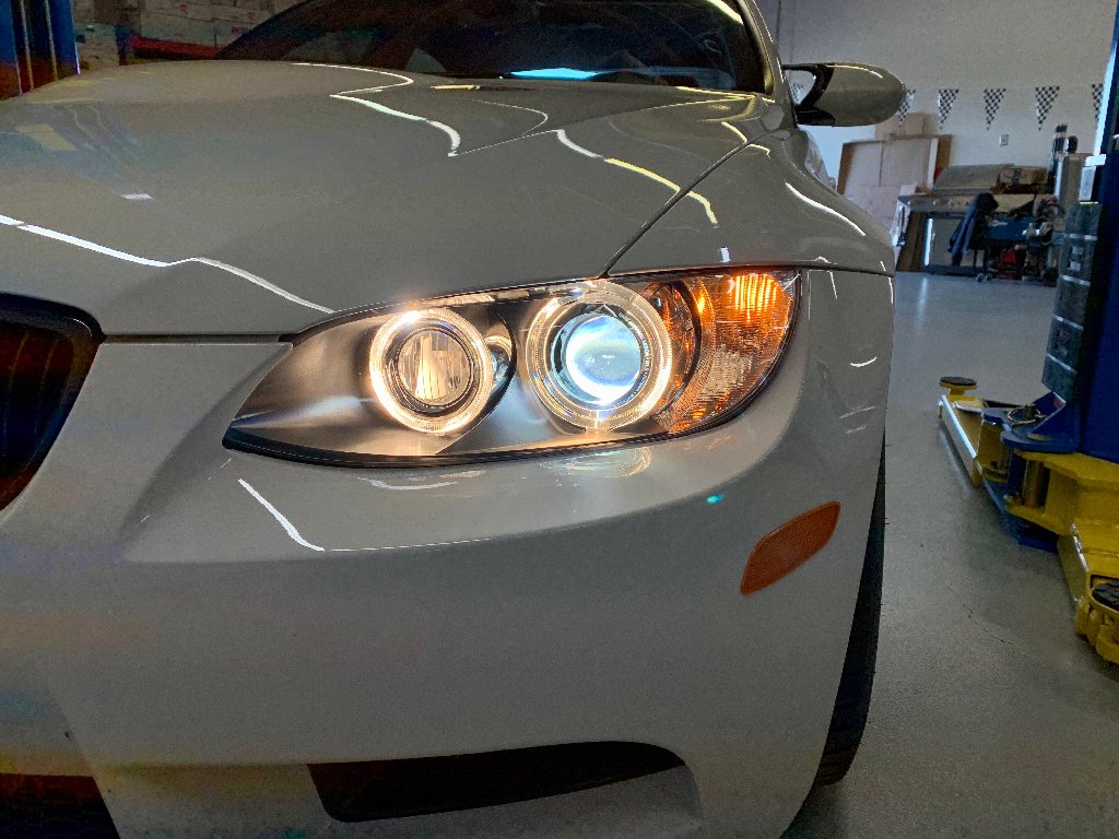

Since I bought my car my passenger side headlight would fog up a bit whenever I washed it or drove in the rain. It looked stupid (and when it should be looking it's best - after a wash!) and I didn't want to risk any water/electrical damage. I wanted to reseal them, but it’s a relative pain in the bum on this car: the headlight covers are glued to the housings, so they need to be baked until soft and then pried apart. That also means the headlights need to be removed from the car, which is a bumper removal too.
This work is doable, I did this same thing with my S2000 way back in 2005 (JDM reflectors, baby). But now I'm in a condo with a family and can't tear apart my car in the underground garage nor do I want to bake headlights. So who’s the best in the biz for headlight rebuilds? BayOptiks.
These guys are the e9xM headlight specialists. Their focus tends to be more exotic builds, but I just wanted them resealed and upgraded though still stock-like. I dropped the car off and they got right to removing everything.
Over the next few days they did the rebuild/modification work and garaged the car. Really nice guys, great work and communication, etc. I couldn’t recommend Jeff and Jimmy enough for any headlight work on this car (if you aren’t local, you can remove and ship your lights to them).
Spec:
ZKW-r Clear Projector Lenses
Osram CBI Xenon Bulbs
OE Headlight Lens Covers and Sealant
(Note: I have Osram halogen AEs coded to 13.6v and Adaptive Headlights II)
The bulbs are still burning in and my photos are dog poo, but the difference in person is stunning. The fresh covers (and mine weren’t bad at all, they were totally a “while you’re in there” thing!) make the front end look, well, brand new. The projector/bulb combo is gorgeous. I had this same setup in my E46 so I’d been lusting for it since I got this car, the "fogging up" was just the rebuild excuse I needed.
... Onto the photos.

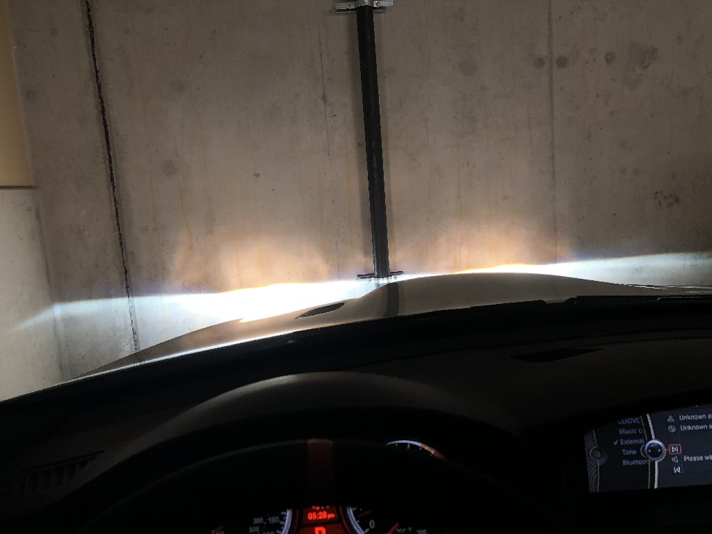

Awful photos, but I tried. The intensity, width, and cutoff are all obvious and awesome in person. In the first two, left is before and right is after (duh). Ultimately it's a lot of coin for the upgrade, but I justified it with the need to reseal them, and am very happy with it all now. BayOptiks can easily do a lot more to the lights once they're opened up like this.

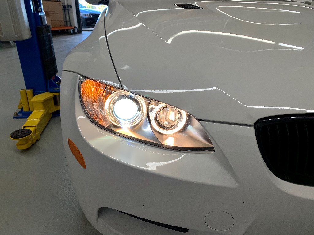

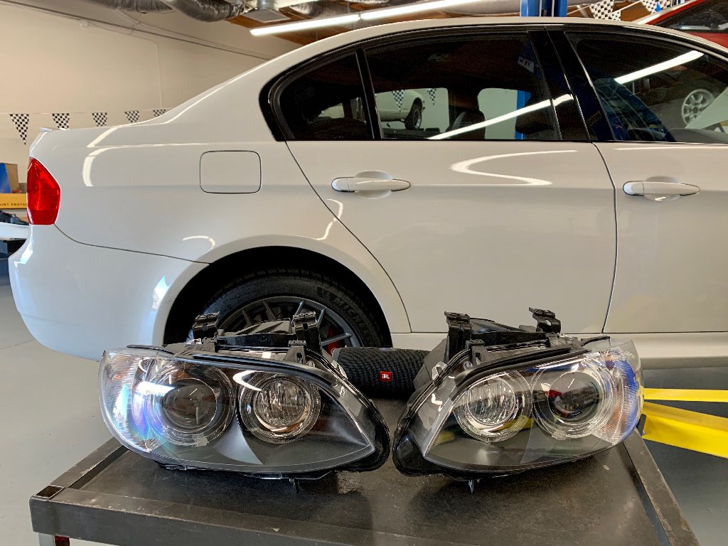

Spec:
They are right by Sharkwerks, which was a cool surprise. I dropped in and met James.
Halfway there.
The goods:
Going back in.
Cold start.
Warm (though brand new, needs a 20hr break-in).
I went straight from BayOptiks to my detailer (JD Morse in Lafayette, for anybody in the East Bay). After picking up the car this evening, I hit it with a clay mitt and a thick coat of Sonax Net Polymer Shield. I’ll give it another coat tomorrow and it’ll be good for a long time. The paint is in really great shape and this Sonax stuff is awesome/easy.
Combined with the Eagle One clay mitt, I give the combo a 10/10 for ease of application, 8/10 for longevity (handily beats wax but can't compete with ceramic coatings), but a 3/10 for depth/gloss (no surprise since its a sealant, and I'm looking for protection first and foremost and value ease, but worth noting that it's not a "show quality" finish). That all said, at some point it’d be cool to get it polished and coated by the pros.
And the lights were dry after the wash tonight – success!
Why did you not go with the Osram Nightbreaker bulb? They're really good IME and the best-performing D1S xenon they sell.
And do you know the difference between OE lens and ZKWr?
P.S.: Not sure about the E90, but in the owner's manual for my F80, it says that some headlight fogging is normal.

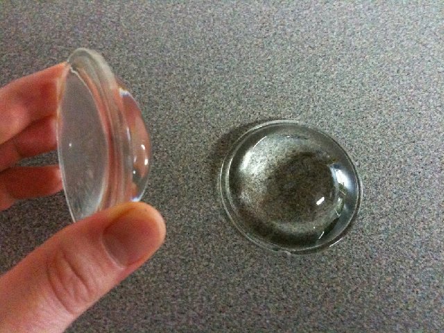

swagon wroteI considered the Nightbreakers, CBIs, CBBs, CBHs, and CBDs (ha). I simply prefer the specs (color, performance, beam pattern) of the CBIs. They actually run at 5000K-5500K which is a pure white, not in the off white OE 4300K range or the blue 6000K range. I had them in my E46 and I put them in my wife’s Infiniti photo’d above when it is was brand new. Safe to say I love these bulbs!Why did you not go with the Osram Nightbreaker bulb? They're really good IME and the best-performing D1S xenon they sell.
OE projector lenses are cloudy and fresnel. The ZKWs are just clear and smooth. Here's someone else's comparison photo.
I’ve read about the fogging being normal but I just don’t buy it. Maybe it wasn't a threat, but it was consistent and obvious, at least in my case. And they were dry after their first wash test, so it seems "fixed" IMO.
swagon wrote"Headlight fog ok. Various strange clunk and noises ok. 1 liter/1500km ok. Cause this is M cars". BMW building protection for them self.P.S.: Not sure about the E90, but in the owner's manual for my F80, it says that some headlight fogging is normal.
^ Yep. In searching I found that many people suffered from the fog even when brand new. But still, most don't have the issue and nobody should. Even if there's no potential damage, it looks broken.
At night or in the garage now the lights are just more intense. And during the day, the new covers/lenses are surprisingly noticeable. My front end is in great original shape and I thought my headlights were perfect, but these have that new new sheen.
Another comparison, look at the ground and the wall. They're probably mostly burned in by now since I bet the change tapers off. And this is a well lit garage.
Laser beams (even with the AEs coded to stay on with xenons!). #powerdome
