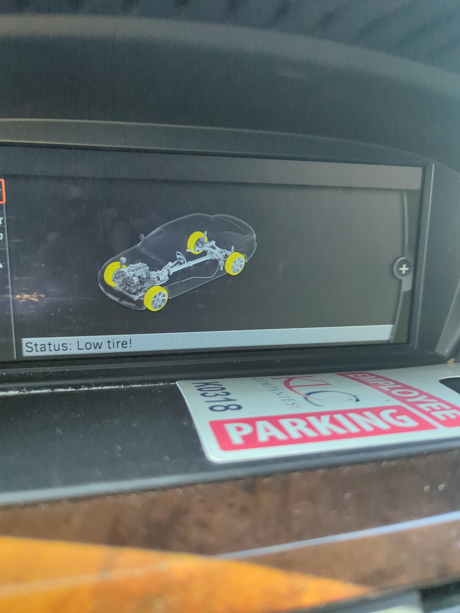

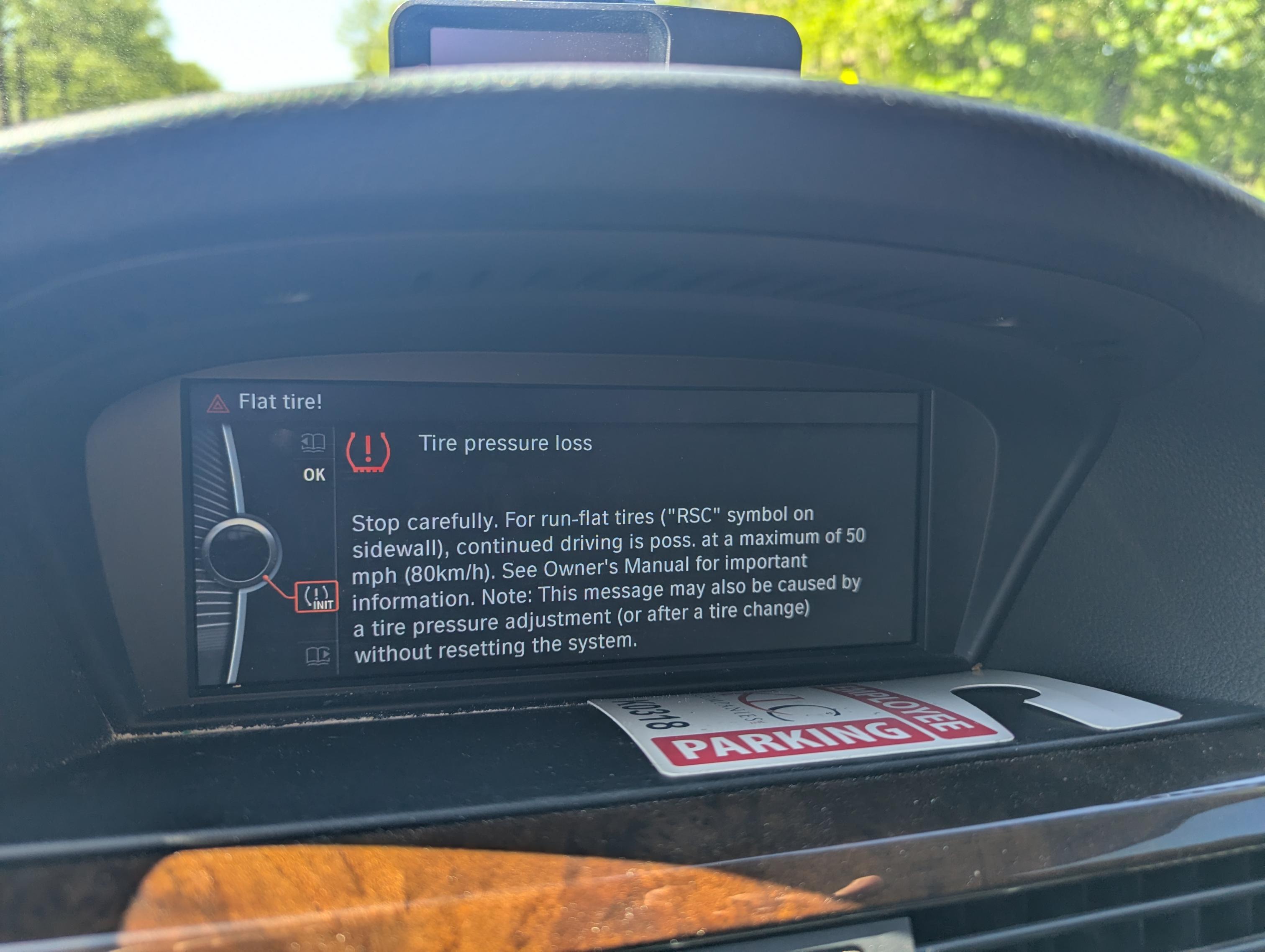

UPDATE
To all those that have same issue as I did, when FTM reset selected it just activates after several seconds whether you drive the car or not, it in fact does perform a reset in the background. I was able to confirm this with ISTA under DSC module, it did take about 30 miles of driving. DSC has three different monitoring speeds, 0-110 km, 110-190 km, and 190-260 km. I only did 0-110 km since it was taking forever. Once it was at 100% I let some air out of one of the tires and in fact less than a mile later I had a warning pop up on the instrument cluster as well as in I-drive. The only negative, it doesn't show which tire is low, all the tires changed to yellow in the I-drive display. Hope it helps
