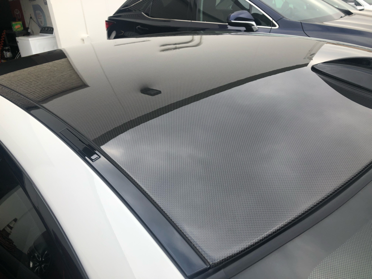

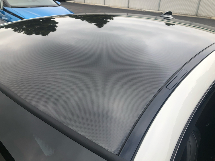

The Florida sun finally took its toll on my roof as well. Looks like something got underneath the clear coat through a crack and has just gotten progressively worse.
Contemplating a new roof or just a complete recoat. The clearcoat is just flaking off and I cannot stress how yellowed it is.

That's how mine started. I managed to save it it's not blem free though and has slight discoloration. I thought about springing for a new panel but it's a very invasive procedure to switch it out. Adds a little personality really. My car is no museum piece but it runs like a top.

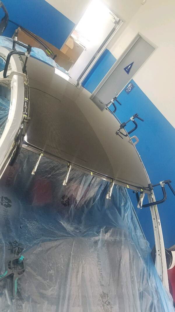

Well, I bit the bullet and had the entire CF roof panel replaced. It's still in the shop but I expect to have it back next week. Pretty big job. Fingers crossed for no rattles.
What shop? Keep us update with pics
The shop is European Collision Center in Downey, CA. The repair was coordinated through my local BMW dealership. They've done quite a few CF roof replacements before, based on what they've told me. They have been very responsive and transparent throughout the process as well, which has been helpful.
I'll post more pics as soon as I have them. Let me know if you guys have any questions or if there's anything I should look out for when I inspect the car.

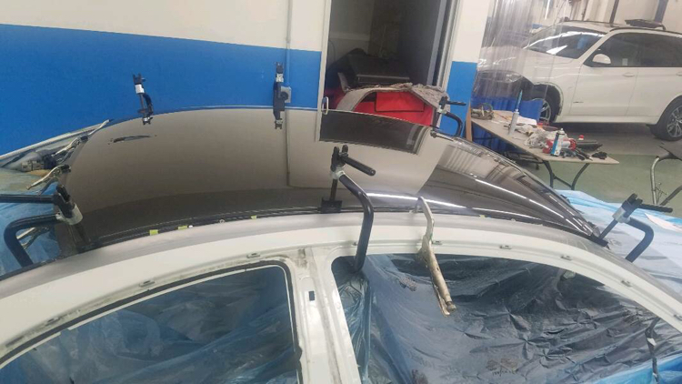

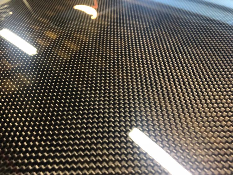

Finally picked up the car today after over a month at the shop. Here's the new roof.. perfection.
Fantastic job!
Mine is having the same problem.
Previous owner said a rock chip hit the roof, then the coat began to crack.
Image hosted on: lh3.googleusercontent.com
So, E92friendly,
How is your roof doing?
Did it crack again?

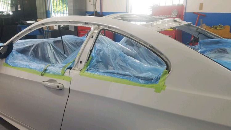

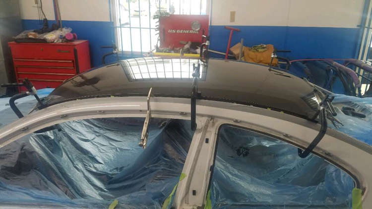

I am clueless as to why they removed the quarter glass and detriment other exterior pieces. The only things that should have been removed were the front and back glass and of course some interior pieces like head liner and corner pieces interior only. Did you have paint work done to your car? If not you've been screwed over unneeded labor. How much did that run you if you don't mind me asking? I am quite curious on labor costs.
How can you clamp down the roof for the adhesive bonding material to set unless you pull the quarter glass?
I thought the same thing in the beginning, but i think the shop who performed this job went above and beyond to do it correctly. Whether that equals a high price tag is TBD.

Oh snap I totally over looked that 🤦*♂️ crap. Haha. I'm thinking like welding in the panel. Carbon roof process is different.
E92friendly wrote
SFCM3 wrote
That's correct. They had to pull the rear quarter glass to properly clamp the roof down for the adhesive. Here's a shot during that point of the process. It was definitely a big job but the shop went above and beyond to do everything they could to be as close to factory spec as possible. They even used BMW factory adhesive and curing agents (or so I was told..). Overall I'm very pleased with the outcome. Now I just need to figure out the best option to protect it! Any suggestions? Ceramic coating, 3M, XPel?

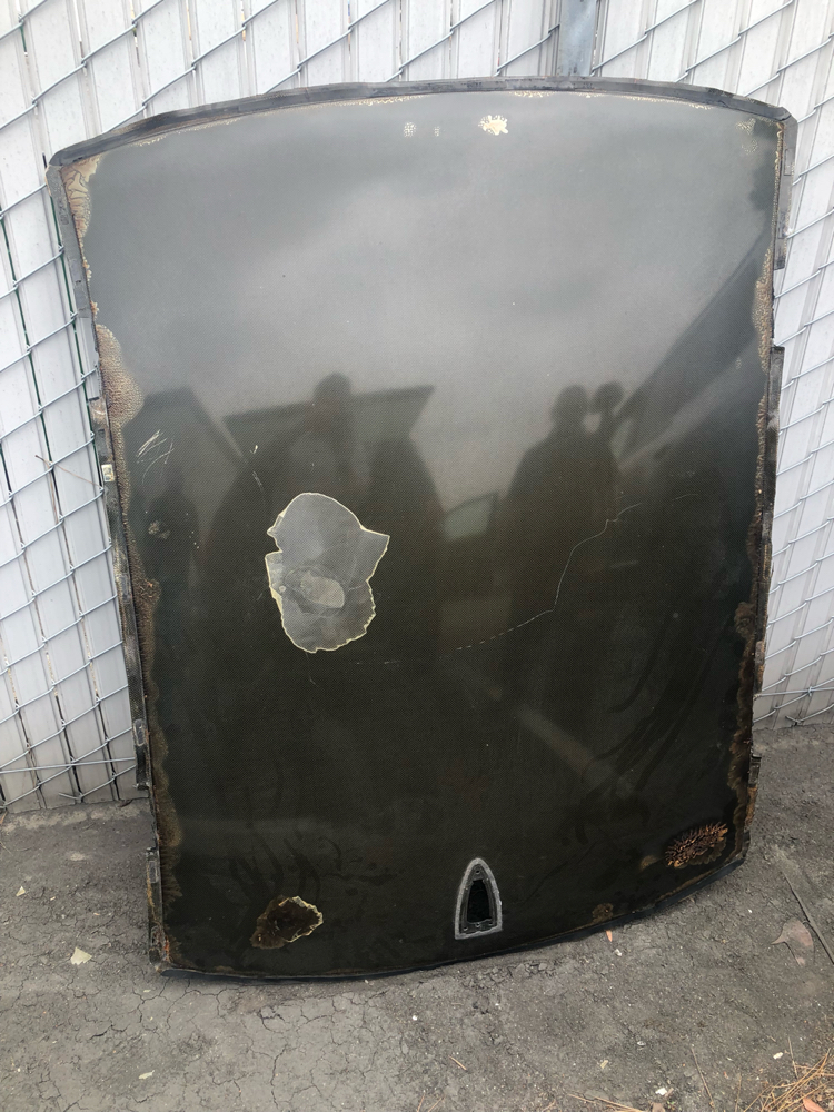

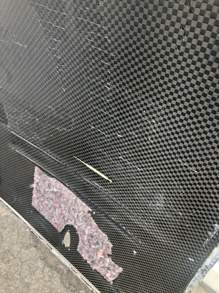

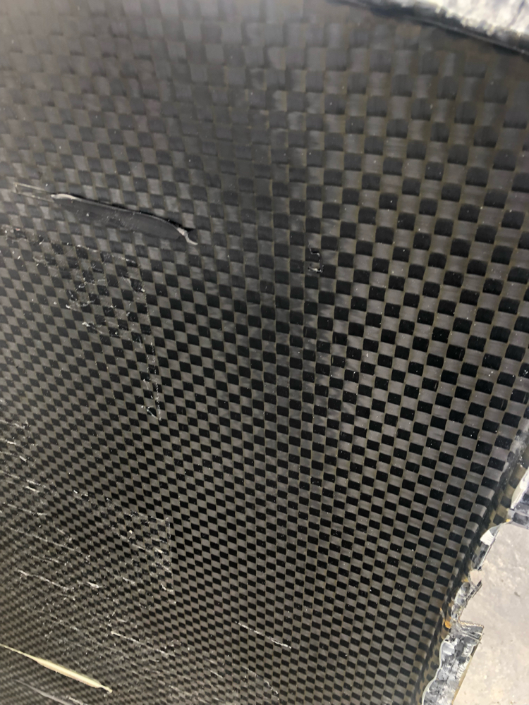

And here's what the old panel looks like after removal. Still have it if anyone is interested!
Wow, what a nice option to have, full roof replacement! It looks incredible.

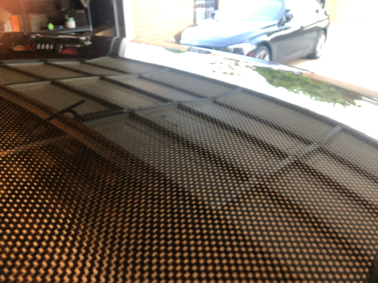

I had the same thing happen to my 2009 E92 M3. This thread helped guide me on what to do. THANKS TO THE OP :thumbsup:
Unfortunately it sits outside for most of its life. I had it under bmw car cover, xpel clear bra on roof, and ceramic coating on xpel. Still with all that the gel coat failed. The good news is I was able to save it. I think my saving grace was the xpel. The clear started to bubble under the xpel. When I started to peal off the xpel the gel coat came off with it.
I got lucky and literally all of the gel coat came off with the xpel. Just came out like in sheets.
I then had a body shop just spray clear over it with the OPs instructions.
Here is pics of the whole process:
When I first started pealing it:
This is after all of it pealed off. It was extremely easy it just came off in sheets.
At body shop before they started to work on it. Lines on roof are just from the blue tape I put on it for trip there.
During the process of clear coating. The close up pic is before any last wet sanding.
Final Results
Awesome efforts with great results! I am amazed at how the layers just come off like that. when the gel-coat/clearcoat came off, did that take off most of the yellowness with it? I would have thought that most of the yellow would be embedded between the weaves of the carbon fabric, but from the looks of the layers you pulled off, its mostly in the clear coat/gel coat.
