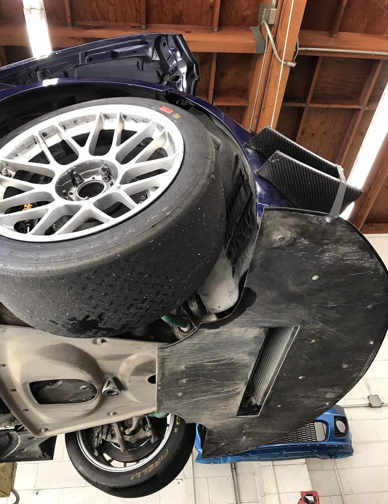

Hey dogbone,when you have a chance, could you post some photos of the underside of your splitter and fender vents?
There's nothing special or custom about the splitter shape. It's the standard offering from APR for the E9x M3. The spitter sticks out about 5" from the OEM nose of the car. Here it is:
Image hosted on: www.epicscore.com

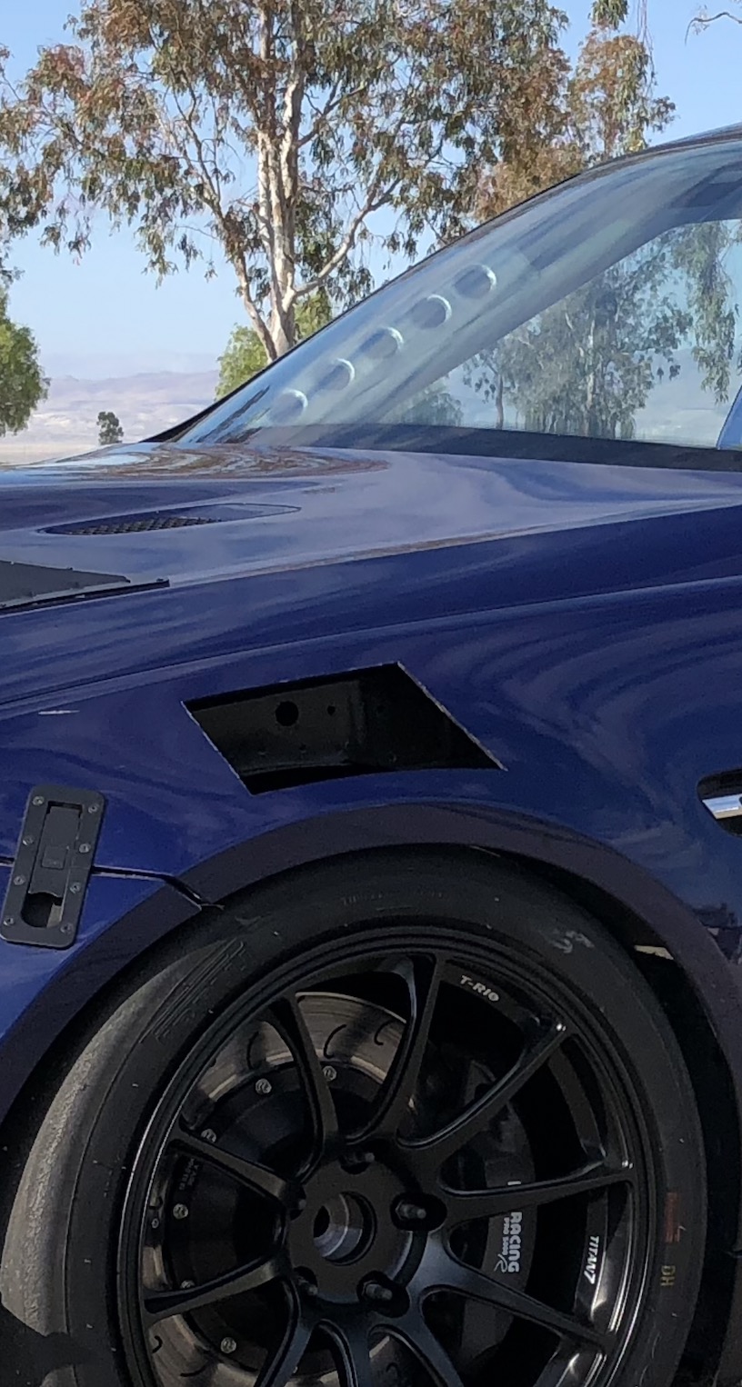

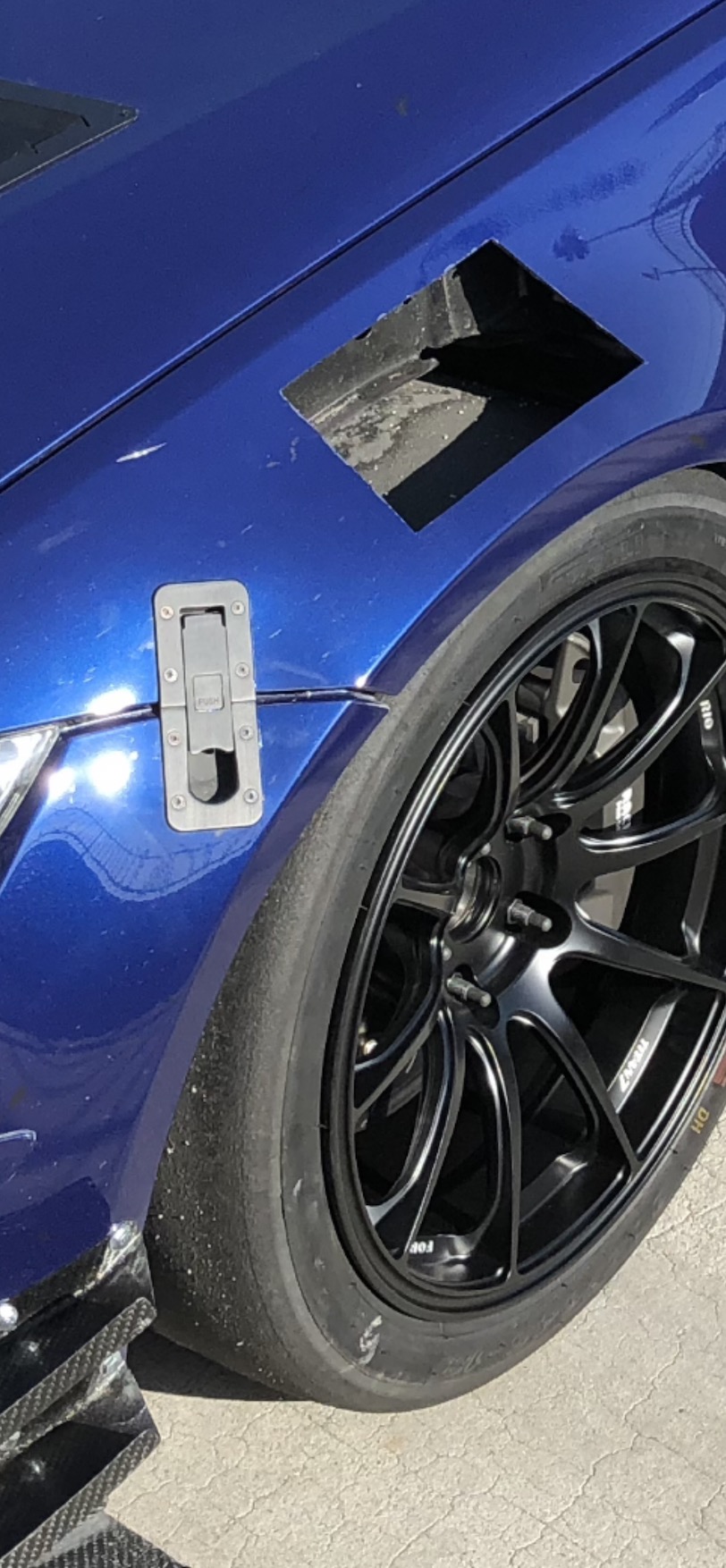

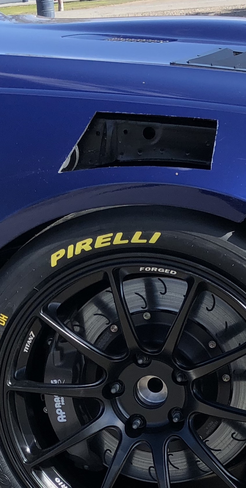

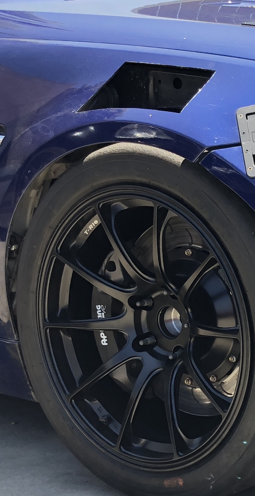

As far as the fender vents, I do not have any pictures of them from the bottom-side. Honestly, there's nothing to see. I have lots of pics from the top though: As far as sizing the vents, one of the main considerations is the windshield reservoir on the passenger side. If you go back too far, you'll expose it. I never planned on covering the vent----I was going for Viper ACR style. If you were going to put some kind of mesh or vent louvers, I guess you have more flexibility with the shape. Forum member Warp 10 had some very fancy-shaped cuts done and covered them with mesh. You can see them on his build thread in this sub-forum. Hope that helps.

Do the whole inner fender liners have to be removed or can one just cut out an area below the hole, keep the rest intact? Curious minds want to know...
We ditched the fender liners, but I don't see why you couldn't keep the fender liners and cut a hole in them too.
I can't remember where all the screws are located that hold the fender liner in place. But I would say that part of the process would be considering where they are.
I would also guess that the fender liner would trap a bunch of stuff like track rubber and dirt/rocks on it's top side if it was in place with a hole in it.
Thank you! Yea, tough one... hm maybe I'll stay away from this fun mod. More things to figure out.
