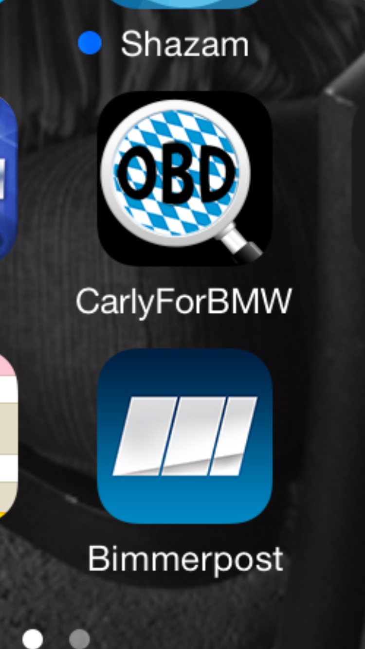

Where do you download the bmwwhatsapp? Is it apple or droid? I'm definitely missing something here lol.
Upgrade+ wroteBoth, try searching "CarlyforBMW".Where do you download the bmwwhatsapp? Is it apple or droid? I'm definitely missing something here lol.
