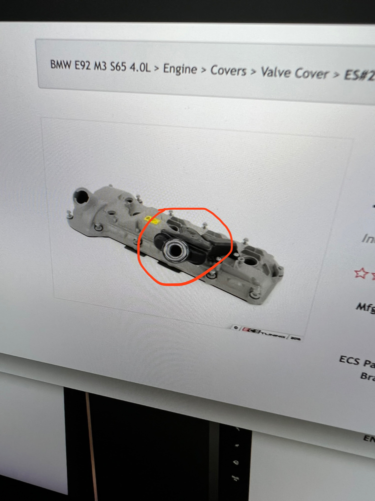

Can you buy this black part ?
If so someone got part number or link?
Mimmer wroteThat's the oil separator part# 11157848155Can you buy this black part ?

Mimmer wroteI have a set of separators if you need them. Pm me and I can get you a price.Can you buy this black part ?

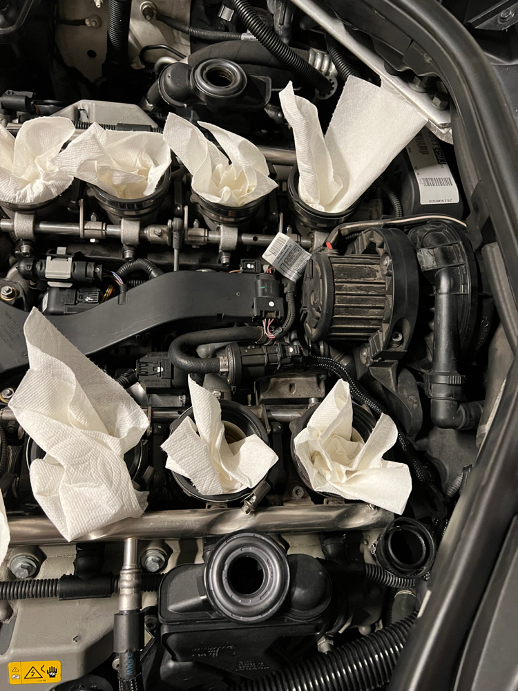

Question all I started this but I have removed the covers but have left them off as I wait for a few parts. Is it okay that it's not sealed back right away and I'm leaving it exposed. Been 2 days and counting now. Probably 1-2 more days have them back on.
Yeah that's fine. I'd probably Cover it with a towel if it were me but it's fine
Mimmer wroteCompletely fine but at a minimum, your throttle bodies should be covered.Question all I started this but I have removed the covers but have left them off as I wait for a few parts. Is it okay that it's not sealed back right away and I'm leaving it exposed. Been 2 days and counting now. Probably 1-2 more days have them back on.
