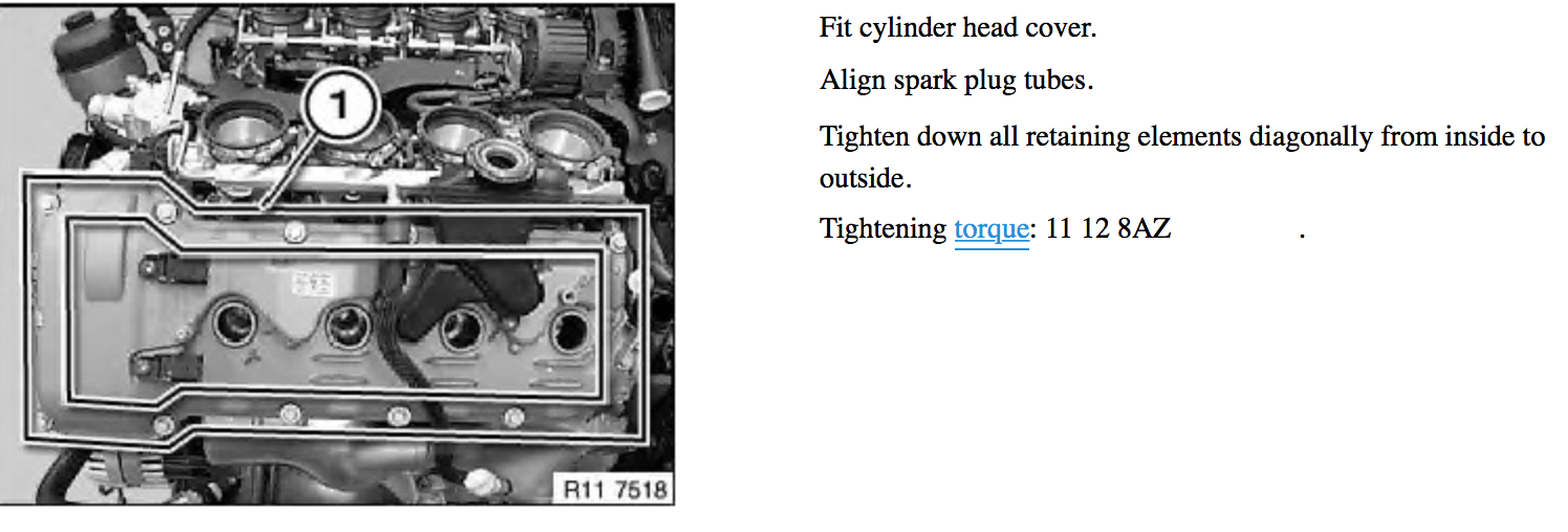

I am planning on replacing my valve covers & associated gaskets this week and was hoping someone could comment on the torque pattern for the valve cover bolts. I came up with three alternatives:
Which one looks best?
Also, would it be possible to tie fishing line around the cover to keep the gasket in place, and then to cut/remove the line once the cover is seated in place?
Many thanks!
Many thanks!

I started on the corners of the valve cover and worked my way in... Worked for me and no leaks. The hardest part was trying the get the valve cover gasket to not fall off when putting back the valve cover. If they are not aligned properly you'll have a leak. I had to redo the passenger side bank twice because of that.
chamba002 wrotehaha that's the opposite way of doing it lol but I"m glad it's not leakingI started on the corners of the valve cover and worked my way in... Worked for me and no leaks. The hardest part was trying the get the valve cover gasket to not fall off when putting back the valve cover. If they are not aligned properly you'll have a leak. I had to redo the passenger side bank twice because of that.
Cbozz wroteLol yeah I saw that part after I tightened valve covers.... I was rushing and didn't bother to read the manual once I put the valve cover back in. After you do it once, its not that terrible. 10mm swivel socket helps a lot with this.haha that's the opposite way of doing it lol but I"m glad it's not leaking
Tighten down all retaining elements
diagonally from inside to outside.
Tightening torque: 11 12 8AZ.

Forgot to add the torque:
11 12 8AZ Decoupling adapter screw to cylinder head cover.
S65 M6 6 Nm
S65 M6 6 Nm

KawBoy wroteyea I saw that one there but i'm going with 10NM...Forgot to add the torque:
S65 M6 6 Nm
in that manual online book one tq says 17NM, one 10NM and this one said 6NM for decoupling... I'll go with 10NM right in between.. and also it may be very hard to tq the back bolts since there is no space for the tq wrench...
I think 10NM is a safe tq
Cbozz wroteIt should be OK with 10Nm. However, I believe the screws touch the bottom. And they are aluminum. Just saying that maybe, just maybe, 10Nm might be a bit excessive. The torque I posted came from BMW AIR (former TIS) for my VIN (2012 car). I can post the document tomorrow when I get to the office if you'd like, just to make sure.yea I saw that one there but i'm going with 10NM...
KawBoy wrotesure, please post themIt should be OK with 10Nm. However, I believe the screws touch the bottom. And they are aluminum. Just saying that maybe, just maybe, 10Nm might be a bit excessive. The torque I posted came from BMW AIR (former TIS) for my VIN (2012 car). I can post the document tomorrow when I get to the office if you'd like, just to make sure.
I actually used my TQ wrench to unscrew my old bolts that were installed by BMW technicians of Fort Lauderdale and the TQ varied from 13NM to 17NM so go figure if they even cared to use a TQ wrench....
Cbozz wroteReadings from a torque wrench while unscrewing bolts usually are way off due to various factors; regardless, I agree with you that most technicians do not use a torque wrench.sure, please post them
