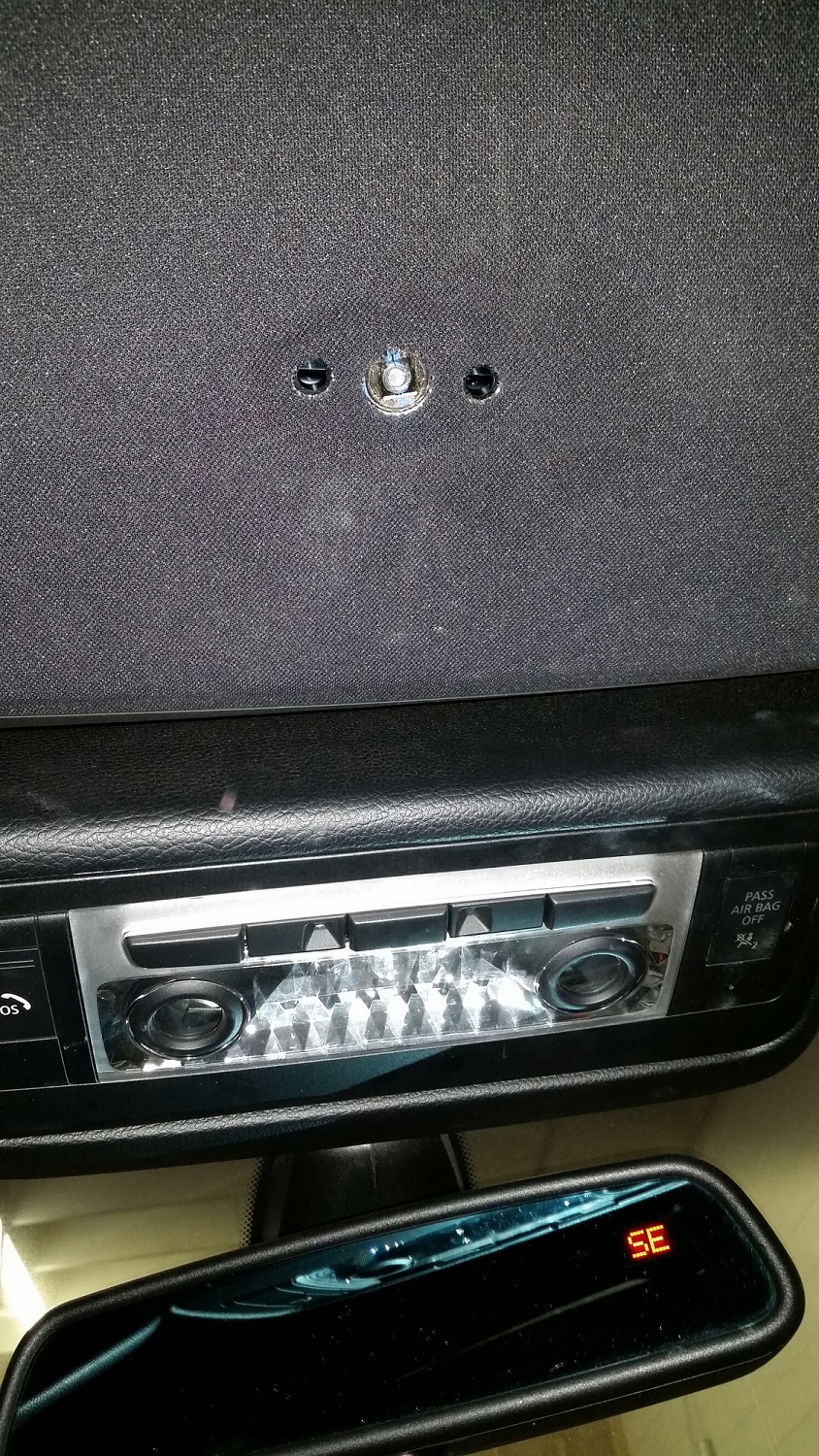

So there are a couple threads on how to manually disengage the hydraulic system so that you can push or pull the roof open or close if it's stuck half way.......... But there is none explaining how to unlock the roof lock when it is jammed or one side stuck/locked.
The stupid body shop guy tried to push the roof open on the drivers side with the windows up and somehow managed to pop that side up/open, and the passenger side is still locked in place.(now the warning light is flashing and wont allow any lock or unlock functions).
I spoke to BMW and they told me where the lock for the roof is on the underside/front of the roof directly above the mirror. and they said there should be some tool for this.
I don't have one in my car nor does anyone I know.
Has anyone had this problem or know if that is the right spot to unlock it. and what the hell does the tool look like or what is it called?

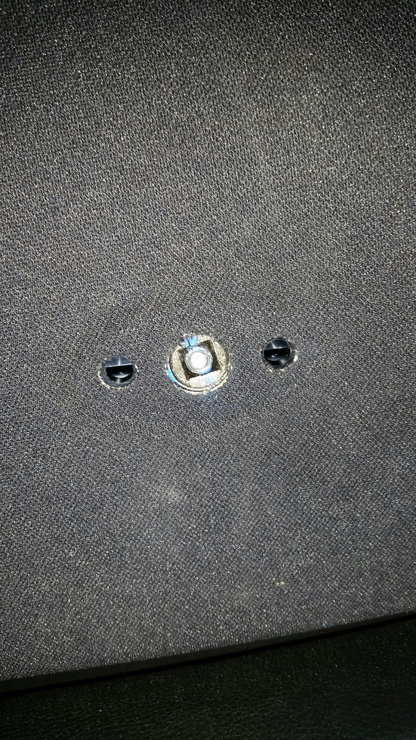

Hi everyone, sorry to bring this back to life. But, I am also in the same situation and would like to know what tool is used to manually unlock the roof. Thanks !
hiya - you don't need a tool
https://www.newtis.info/tisv2/a/en/e93-335i-cab/repair-manuals/54-slide-tilt-sunroof-soft-top/54-37-folding-roof/Oo6fIqh

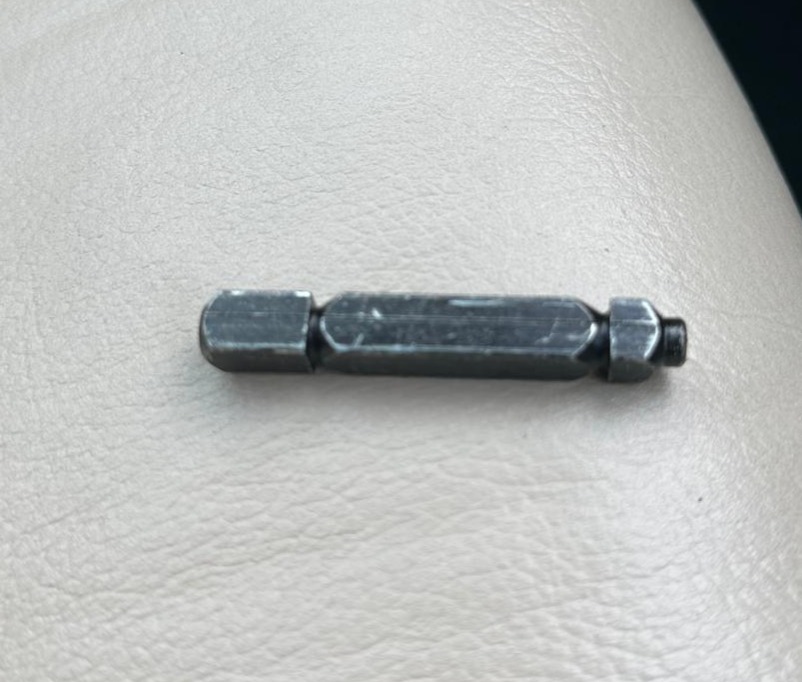

Well BMW say you do and its basically a slide hammer.
However you shouldn't need it - I just;
found a screw with the right thread size
screwed it in finger tight
give it a gentle pull and the pin will drop
then use spanner to turn the pin to lock or unlock the front and middle portion of the roof together.
to lock the rear part of the roof is more tricky - manual link shows how but haven't done myself.
cheers
I had a window motor issue(flooded window well) and had to manually lock the top. repairs have been made and the manual lock pin will not push back into place to allow top latches to operate electrically again. mechanic who did window work is at a loss, how to put the top back into service after manually locking it?
Thanks Steve335e93 for the info, I put a bolt into the roof mechanism yanked on it and the tool came out. Luckily it goes back in and I can opens and close the roof lock. Attached image
