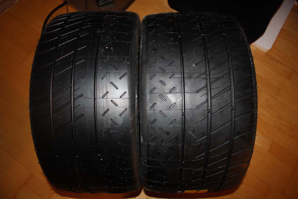

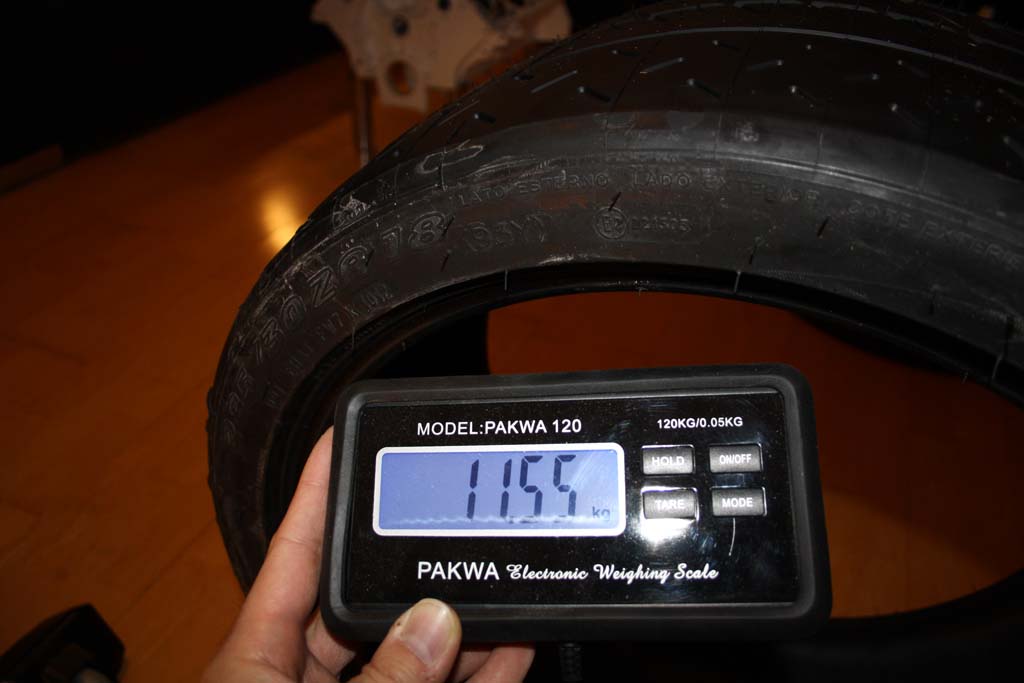

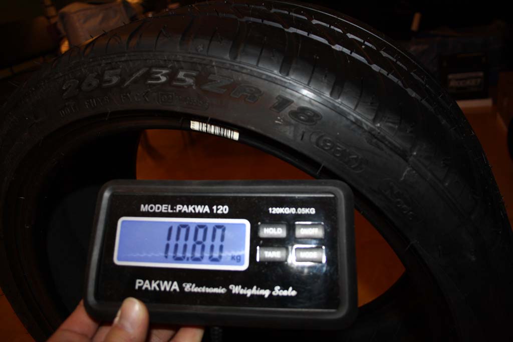

Plan:
285/30-18 all around Michelin Pilot Cups
10x18 ET25 wheels (which will get a 5-10mm spacer front and 10-15mm rear).
here's a teaser of the tires. weight is shown in Kilogramm.
"my old" 265/35-18 Michelin Cup tires:
"the new" 285/30-18 Michelin Cup tires:
Both on one picture. 285/30-18 will be really tight on the front but it should work.

Originally Posted by lukester View Post
will do it. gimme some weeks.
Plan:
