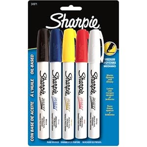

A good practice would be to mark the studs relative to the hub so that you can visually inspect them every time you take the wheels off.

Brilliant. What do you use as a mark? Nail polish? (From my wife, of course.)

Paint marker works well for this, I prefer yellow but you can use pink sparkly nail polish if you want.
I haven't had any issues with mine but my brakes don't get very hot for very long, Loctite will break down at high temperatures

Here's what I use.
http://www.sharpie.com/enUS/Pages/oi...nt-marker.aspx
