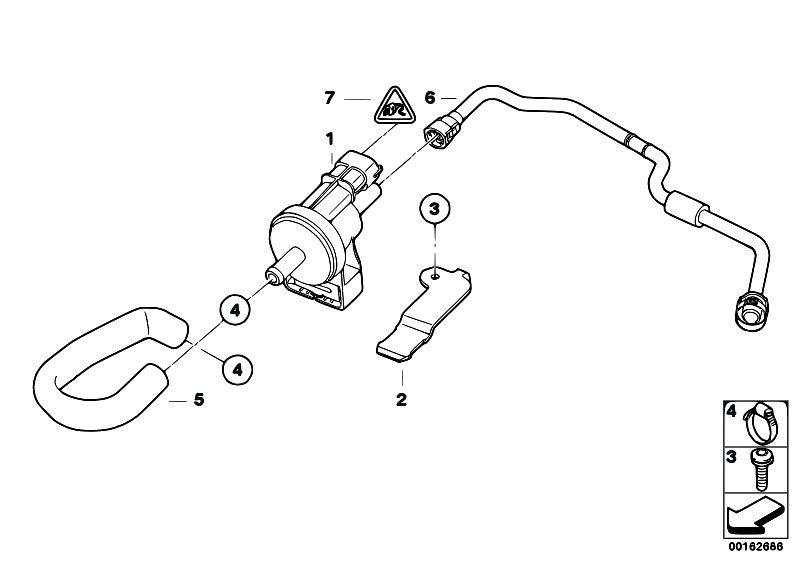

So I just finished installed the ESS VT1-550 kit on my car and everything is buttoned up nicely and the car runs and drive just fine. The only problem is I'm getting a "service engine soon" light.
I pulled the code and its 27A6 "tank ventilation actuation bank 1". I have a feeling it's some kind of emissions thing, but I've checked everything I can get to and all the connections seem correct.

Looks like it's the section that's indicated in this diagram. The front vacuum hose is modified to feed the bypass valve and I guess I didn't get the hose clamps tight enough or something. I'll probably order the valve as well just in case that's the problem. Of course this is directly under the manifold so it'll have to come back off.
http://www.estore-central.com/bmw-pa...reather-Valve/
The T-fitting is placed within this line for the BOV. Check to see if #4 hose is dried out/cracked/leaking.

Does the t-fitting have a check valve as well? Possible that the check valve could be backwards? I know my system does have a check valve in that area.
You could possibly have an earlier configuration. ESS does not utilize a check valve that we have seen.
