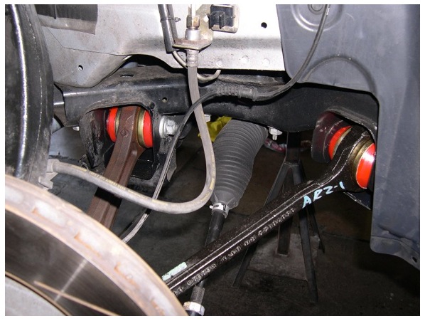

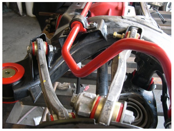

Here's some pictures of what I did to my '09 Challenger subframe. I replaced all bushings with Pedders bushings. The difference was night-day. The car felt like it was running on rails afterwards.
