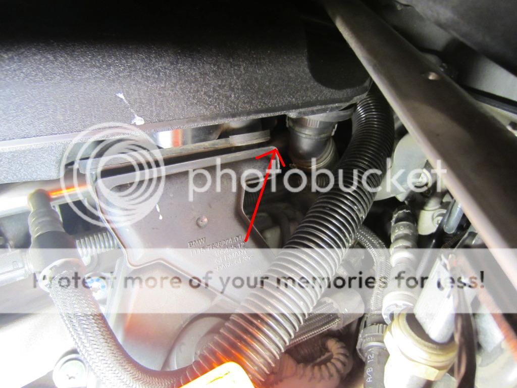

7. Loosen up all 8 TB (throttle body) clamps with either a long screwdriver or a 6mm socket with extensions. I recommend using a 6MM socket. It's easier.
For the back 2 TB's, it'll be hard to see them. The easiest way to get to them is to go through the opening shown in the arrow. It'll be facing the same way as the other clamps
8. Push the plenum up to break it loose from the TBs. It will be on there tight, use a lot of force. Give it a few good yanks you will feel it break free.
CAUTION: Plastic clamps are easily broken, proceed with care.
Make sure all the clamps are very loose so that they aren't still holding the plenum. I'd say slowly push upwards in all directions first (so front, right, left) to loosen it up a little. Then use more force.
9. Once loose (it's easier), you need to disconnect another TWO hoses UNDER the plenum, both with manual clamps as well: a small one is in the front, below the 'snake' going to the air filter, and the big one at the rear, on the driver's side, where the brake booster should be. The manual clamps require pressure on each side to release the teeth holding it onto its
Look at Step 7, the second picture with the arrow. That's the hose that needs to be disconnected.
