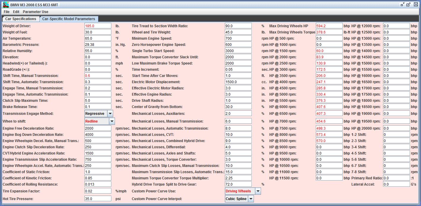

I've looked at many 6MT vBox graphs, and 0.6 seconds is the
fastest shift speed I've ever seen. Most are about 0.7, and some
are 0.8 seconds. That's measured from the time long-acc drops, to
the time it returns. So that's the amount of time from clutch in,
to clutch out and full engagement.
Since you're a CarTest fan, you'll appreciate looking at the two
charts below. As you know, you can input actual dyno charts into
CarTest. If you do this, then these are the results. The same
exact car model was used for each car, both listed at 3704 pounds,
and 6MT using a 0.6 second shift time -- which is the fastest I've
ever seen on a vBox file. The DCT used 0.05 seconds shift time.
The first chart compares the same dyno chart from an ESS VT2-600
(517whp) in both DCT and 6MT.
The graph above shows 0.61 seconds difference, and 8.53 MPH
difference in the 1/4 mile, along with 1.2 second difference
60-130 MPH (yes, a whopping 1.2 seconds difference 60-130 MPH).
If you change the shift speed to 0.4 seconds (seems impossible
based on actual collected vBox data), the results become as
follows: 0.41 seconds difference and 6.27 MPH difference in the
1/4 mile, along with 0.95 second 60-130 time. You'll notice that
CarTest predicts an additional 2.26 MPH trap speed difference
simply by changing the shift speed by 0.2 seconds.
Now, let's do the same thing using the actual dyno charts from
DLSJ5 (DCT @ 586whp) and M33 (6MT @ 594whp). Here's the CarTest
results below:
As you can see, using 0.6 seconds shift speed for the 6MT, it
loses in the 1/4 mile by 0.67 seconds and 9.91 MPH in the 1/4
mile, and 1.68 seconds 60-130 MPH. Then if we reduce the 6MT
shift speed to 0.4 seconds (again...a seemingly impossible task
based on actual collected vBox data), the 6MT loses by 0.46
seconds and 7.48 MPH in the 1/4 mile, and loses by 1.42 seconds
60-130 MPH.
Swamp, there is quite a bit of real life data collected in vBox
files. Those files show the 6MT is quite a bit slower than the
DCT for similar configurations. For whatever reason, you're
chosing to ignore it and substitute your own. You love CarTest
and talk about all of these simulations, but this is one case
where you should have used it and seen the results for yourself.
The CarTest simulations back up exactly what is one those vBox
files and that "re-enactment" referenced above.
Feel free to download the actual dyno charts from DLSJ5 and M33
from the Dyno Database, imput them into CarTest, and publish your
own versions based on these same dyno charts. For your reference,
here's the values used in CarTest for each vehicle. If you can
spot something wrong, please point it out so it can be fixed and
simulations re-run. But only do that if you are convinced that
something is so egregiously wrong that you think it will
significantly change these results -- which also seem to match
real life quite well.
Parameters for DLSJ5:
Parameters for M33:
